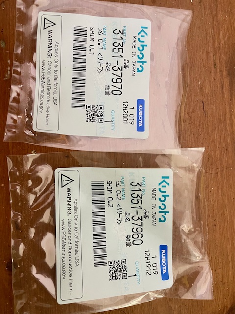

Dug 'em up & here you go - exact for L2501 (and others I'm sure). Paid a whopping 80 cents per. 😬
After experimenting - use a good gauge... I could have used 1 in the combo in the next size up but they were oos so I stacked them. Def. get the correct ones
edit: 0.4 also available for sure
  • Instructions in the manual
  • Check your baseline pressure & shims
  • Every 0.1 is approx. 38 psi
