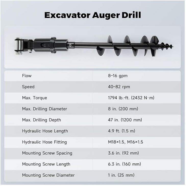

I'm fitting up a Chinese auger for my mini but don't know what hose size would be best for it. The auger came with 1/4" lines (that are way too long) and M14x1.5 ends and a M18x1.5 adapter that threads into the auger drive.
I have 1/2" flat faced couplers on my machine so I will need to add the same size coupler to the (new) hydraulic hoses to make the connection. I will need to get some adapters for the auger connection to hydraulic hose (M18x1.5 male to whatever I chose for hose side).

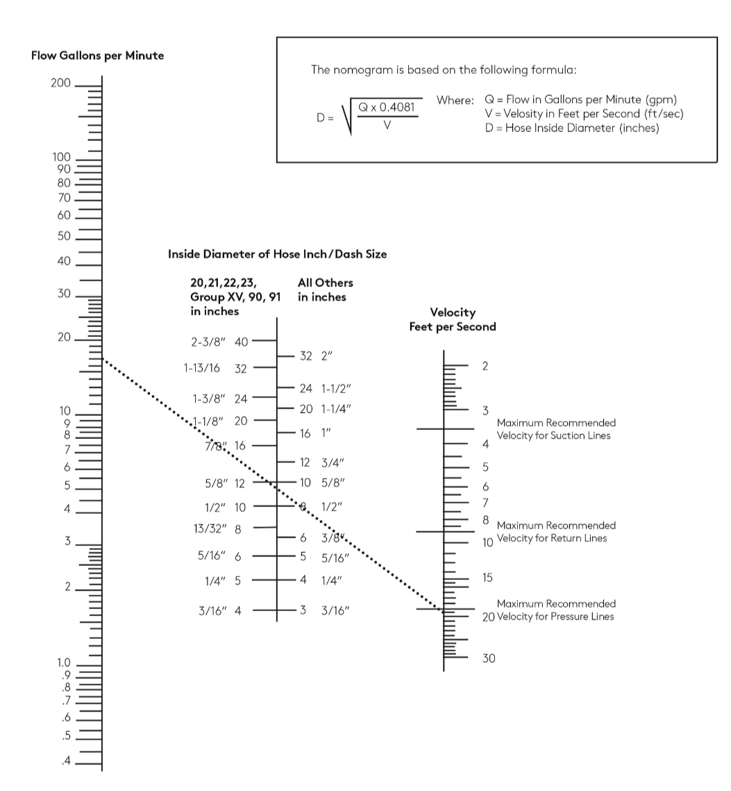

Since I will be adding new hoses of a shorter length should I step up the hydraulic hose diameter to 3/8" or 1/2"?
According to what I can find about the auger, it looks to have a flow rate of 8-16 gal/min. My machine flows around 14gal/min. The machine has a diverter valve on the dipper, so, I believe that I can control the flow rate the same way that I do for the hydraulic thumb.
