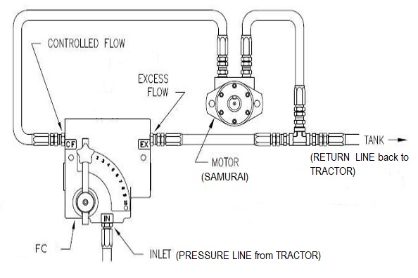

The company provided the attached image for a suggestion on how a flow control valve could be installed. I can identify the pressure side of the 3rd function quick connectors and install the flow control as suggested, but since the 3rd function is a two way toggle switch, would this setup only provide a reduced pressure/flow if I use the side of the 3rd function switch that opens the pressure side? The cutter’s motor is bi-direction, so if I were to open the return side of the 3rd function will that pressure/flow to the cutter”s motor be unrestricted?
