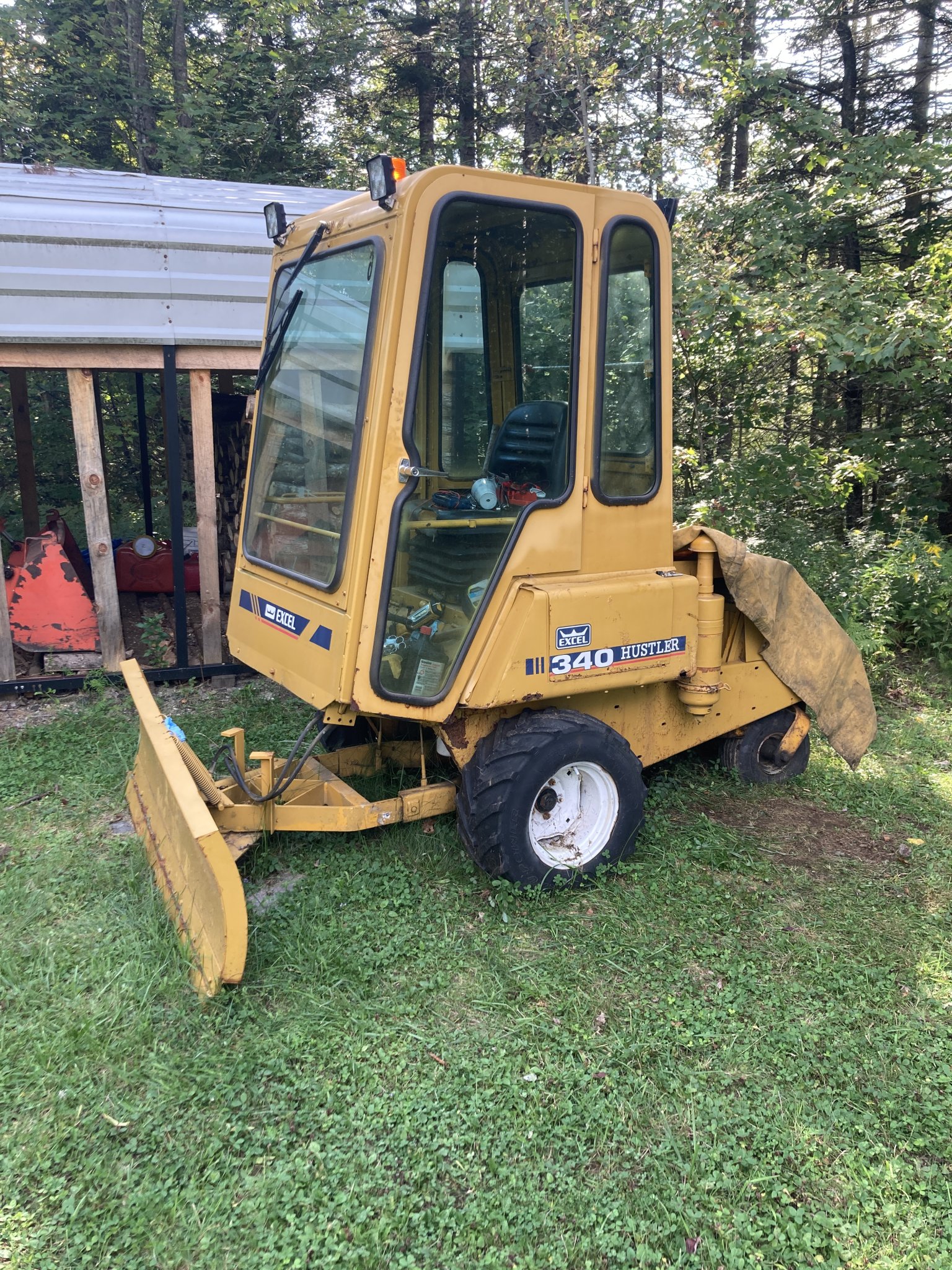

I have a hustler 340 with a kubota v1200 or v1205 in it. If I can get it running it will become a small snowcat.
It came with water in the fuel as a crank no start-
New filter, full fuel clean, bled whole system.
verified fuel at injectors
When cranking white/unburnt fuel out the exhaust…
It lacks the sound of every other kubota I have had when cranking- seems too smooth and continuous…
10v at the glow plugs under pre heat
Video of it cranking
Rockers all release the valves- but clearances are not super consistent…
