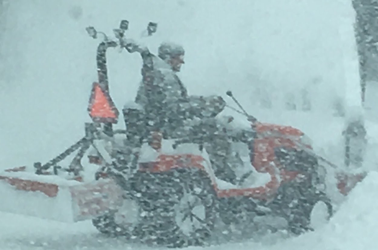

In 2013 I went from a 1996 JD 425 Garden tractor with 54" deck, front snowblower and blade to a BX2360 Kubota with Loader, 48" front mount snowblower, 54" mower, 48" box blade and 60" back blade, plus a few other 3 point hitch (3PH) attachments.
