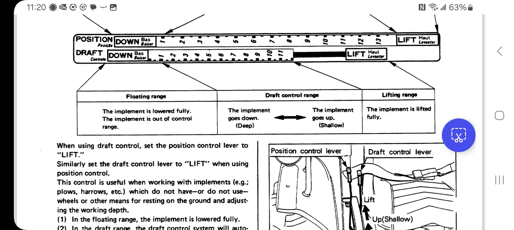

Sorry for the “first timer” question. My L295DT has 2 levers on right to control the 3-point. I have a bush hog attached.
The inside one raises/lowers, but it kinda seems like it’s all -or-nothing.depending on how far you pull the lever, it just slowly/quickly keeps raising or lowering till it’s the whole way up (and pump whining) or whole way down.
The outside lever doesn’t seem to do anything?
So I’ve been lifting it up, “locking” the knob (betweeen my legs), disengaging the lift, then adjusting height and locking with the lock knob to height to mow.
what am I doing wrong? Or is something broken?
