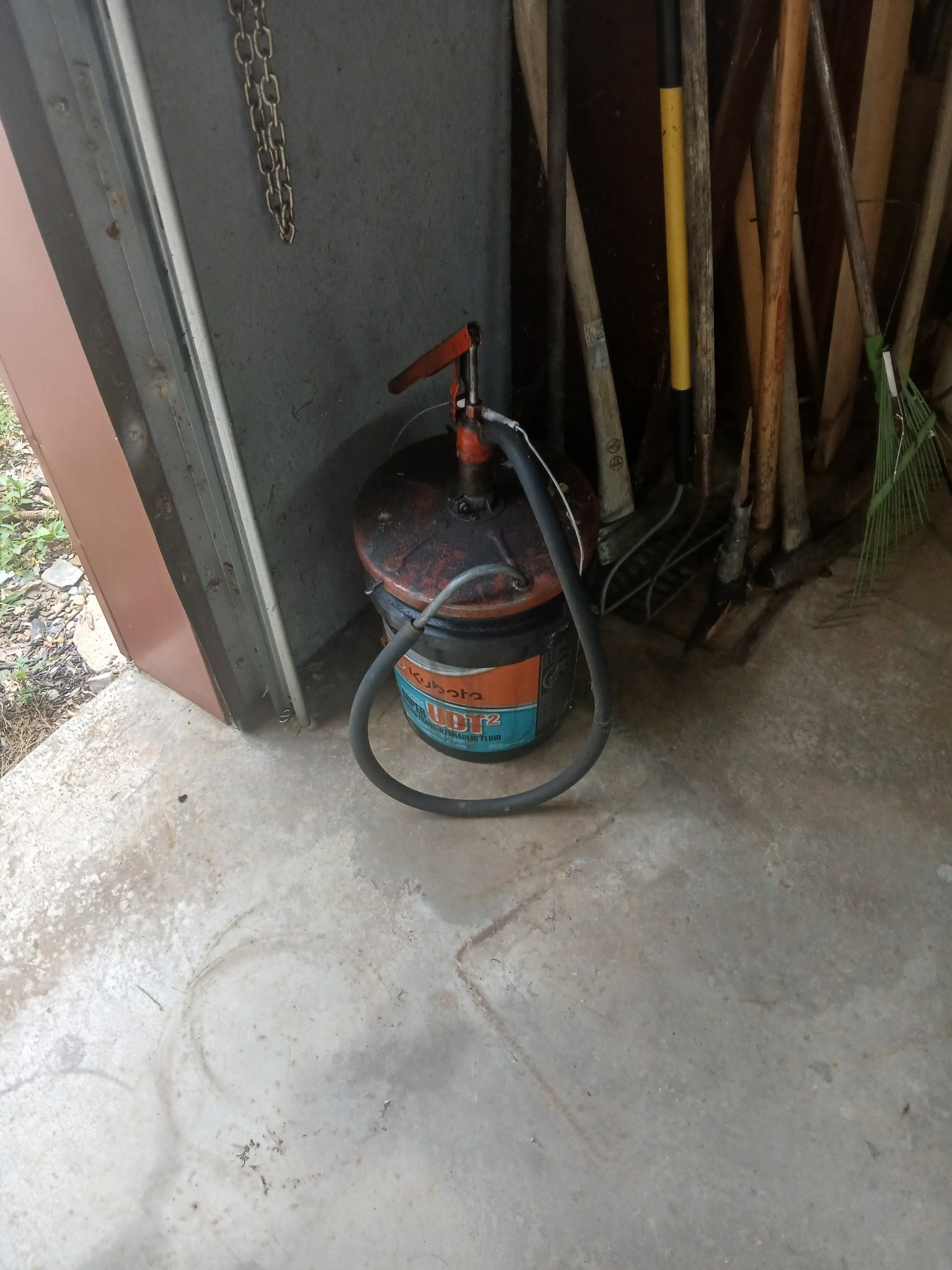

I pump them into the tractor. This guy is always at the ready be it a top off or full fill. Thats the way it was done on Grandpa's farm 70 years ago and for the last 30+ years the way its been done for in my "mini-estate" shop.
I see that the bail handle interferes with the pump. That would make it somewhat difficult to carry in my opinion.
Can it be arranged so there is a better handle position that can be carried easily?
I have a plastic version (hiding from me currently) that attaches to the pour spout of the lid. Depending on how the bucket, lid and pump are arranged can also cause difficulty with handling the pail of oil. So if I don’t find mine soon I may replace it with the version that you show (and hopefully it won’t be able to hide itself easily).
The handle is no problem.
