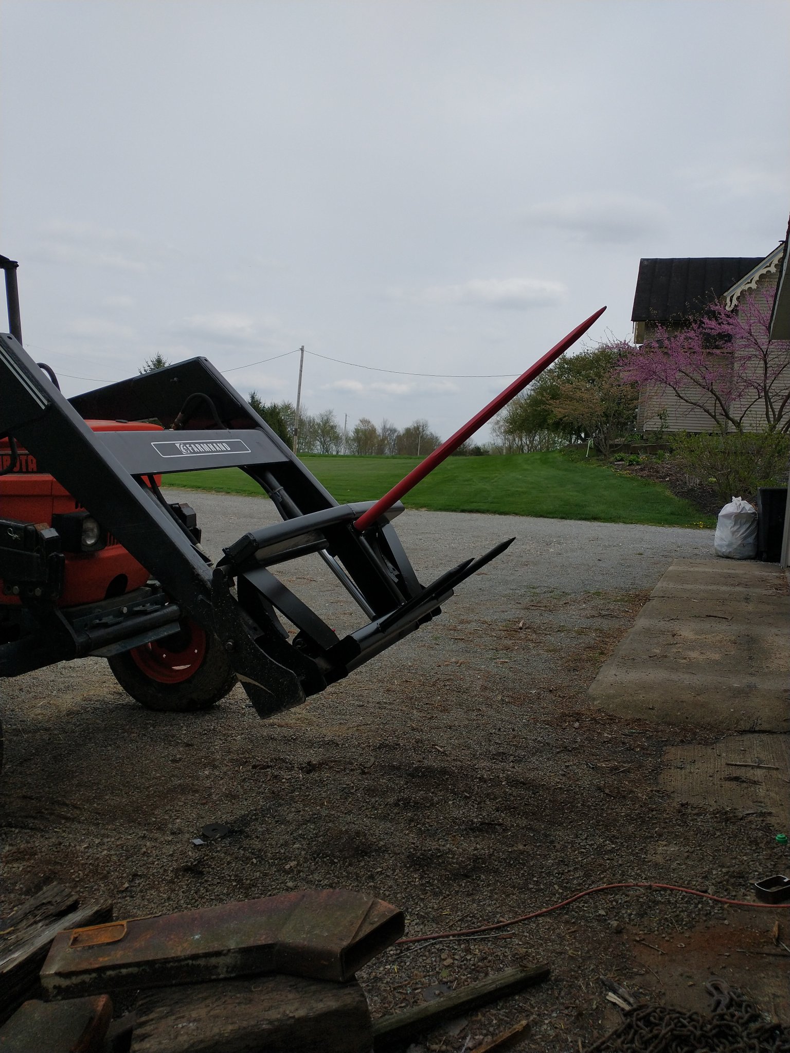

Whatever you buy, get one with a spear that has a long taper on it. They go into the bales much better than the spears that have the short 6 inch+/- tapered ends.
If you are handy with the welder, Vevor has some good deals on just the spear from time to time. Just used one of theirs to "remodel" my 3 point bale mover.

This is my home made front mount mover, but this is the type of "spear" that you want.

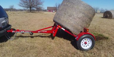

You are pushing the envelope for the capabilities of your L2501. Just because hydraulics lift something doesn't mean axles,bearings and other parts of tractor can handle it,at least long term without consequences. If you read through these forums damages caused by fels is secound only to "click no start". That being said you might be ok moving a few bales from outside pasture into area where cows can reach it. Hanging ballast or bale on back and one on the front then hauling down the road imo will soon cripple your tractor. And as you already know lifting high enough to stack is too dangerous for your wheelbase and weight. A single visit to dealer can easily cost more than a larger used tractor dedicated to bale handling. How many cows do you plan to have? That makes a difference in what you can make do with. There is an option that was very popular in the 60s and 70s most here may never have seen before. A 2 wheel cart with fork and boat winch that can be towed by truck or tractor. Many have gone to recyclers but if you ask around old and large farms they have them sitting unused that can be bought for couple hundred dollars plus the price of tires and maybe winch. My BIL fed near 100 head in pastures 6-8 miles apart when he started out. Even after he had good equipment he often used the cart rather than move his tractor to a remote pasture. If you can use a dump trailer you can move bales from where you buy them. You can't rely on having hay every year withing sight of your house. I recommend pallet forks since you will find many other uses for them.

A buggy as I described earlier and Maple Leaf pictured above would be fine for 10-20 bales per year. You can get them for a song or weld one up from scrap plus $100 for tires and winch. In case you aren't aware,it nor other farm trailers require brakes,inspection or registeration in Texas until loaded several thousand pounds. I do reccomend tail,turn,side marker and stop lights although not required. Are you closest to Denton,Greenville,Ennis or Sherman vicinity?

Thanks but the old ones I saw were $500 or more. New ones were almost $2k. I just need to move the bales into the barn or out to the animals. The farthest distance on our property might be 1/2 mile. It will be less since even with moving the the ring around since I dont plan on putting the hay all the way at the back or in the front pasture.

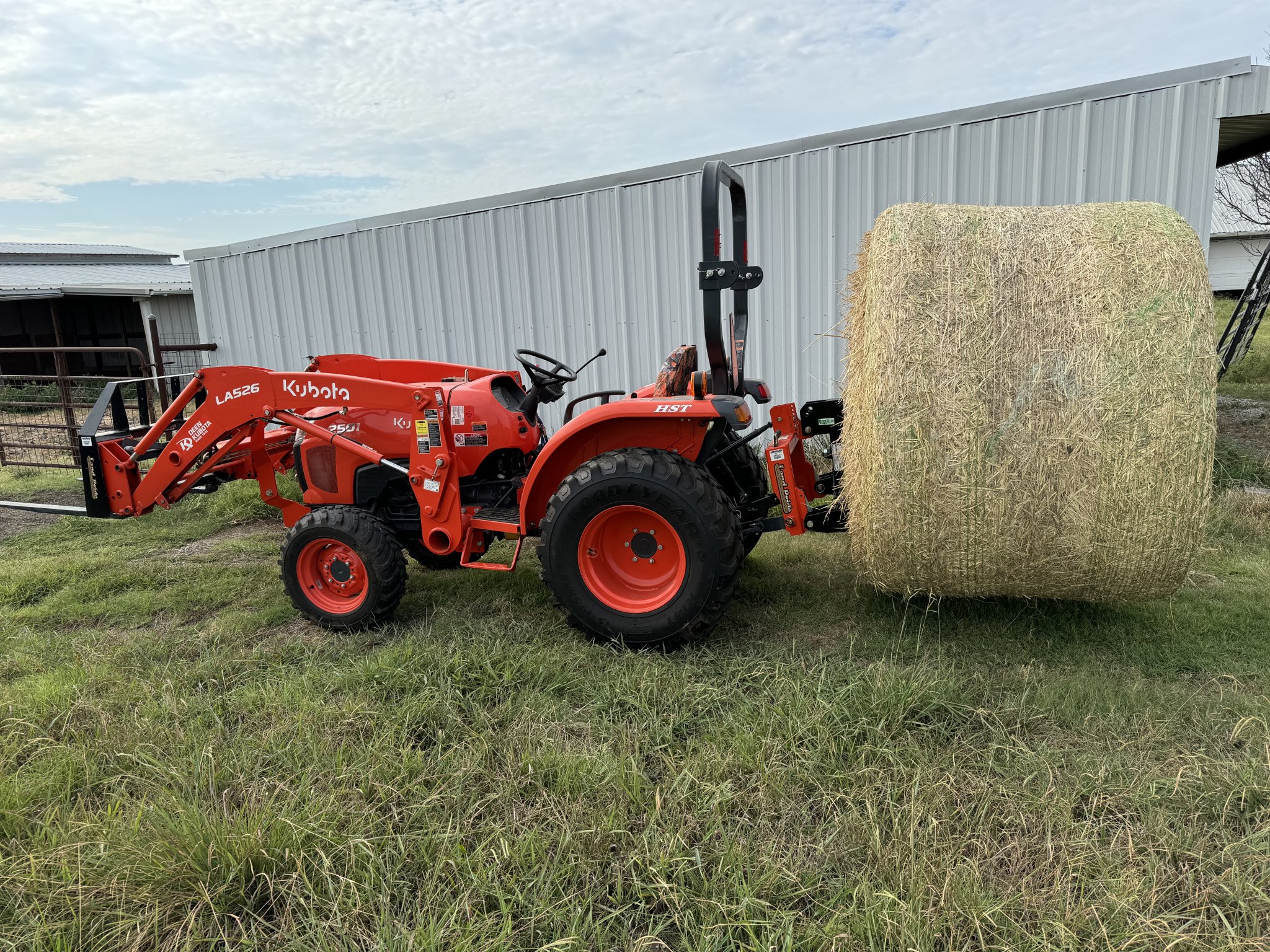

I bought a BSR10 this afternoon. I’ll be able to carry the big bales on the back of the tractor. Ill take some pictures and/or videos when I start moving the bales.

I moved 10 4' dia x5' high to' 4'x6' bales to the top of the hill which is the driest place we have. I think they weighed around 1000 lbs each. I was in low at 1500 rpm so it we a little faster than walking. My guess was that I move them 1500 feet from where they were dropped off to where I moved them too.
I poked the bale below the center and lifted them all the way up and I had about 10"-12" clearance to ground.
