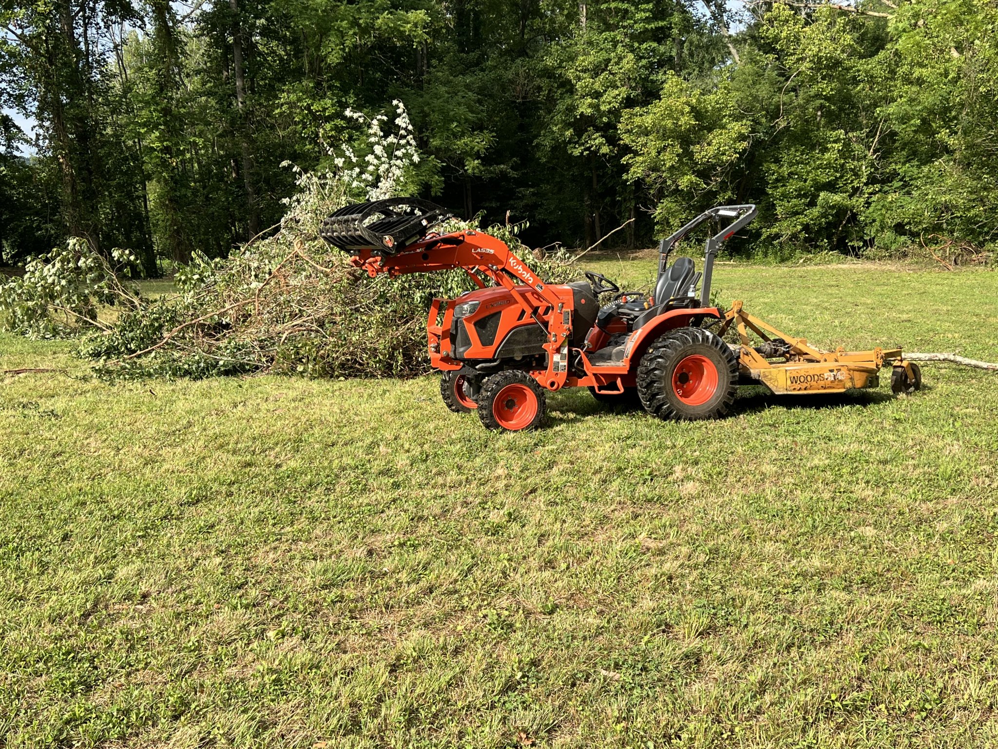

I have had the LandPride 60” since 2021.
It is a shade lighter than the 60” fel bucket.
It is what is normally on the loader, unless I am doing backhoe work.

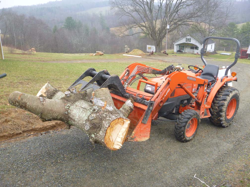

Good day.
On my B (I think similar to LX?), I have a LP 0660. Its a nice size and weight for that machine IMO.
I think your primary plan of use should determine the style. I think the clam shell style is maybe more versatile since you can use to rake the ground more effectively than a long bottom style.
I also have a long bottom style for my MX and it certainly supports/holds odd and large shapes much better, but it does not do very well at o rake the ground. There is a trade off for sure.
I’d give the other brands mentioned above a look if I were buying again. Beyond the steel spec and weight, I think zerk location, kickstands(especially for a clamshell style), and hose routing/protection pretty important. (Don’t forget to think about a brush guard / grill guard insert for the machine itself).
If I could only have one extra implement for the loader, it’d be forks over a grapple though.
Good luck. ☕

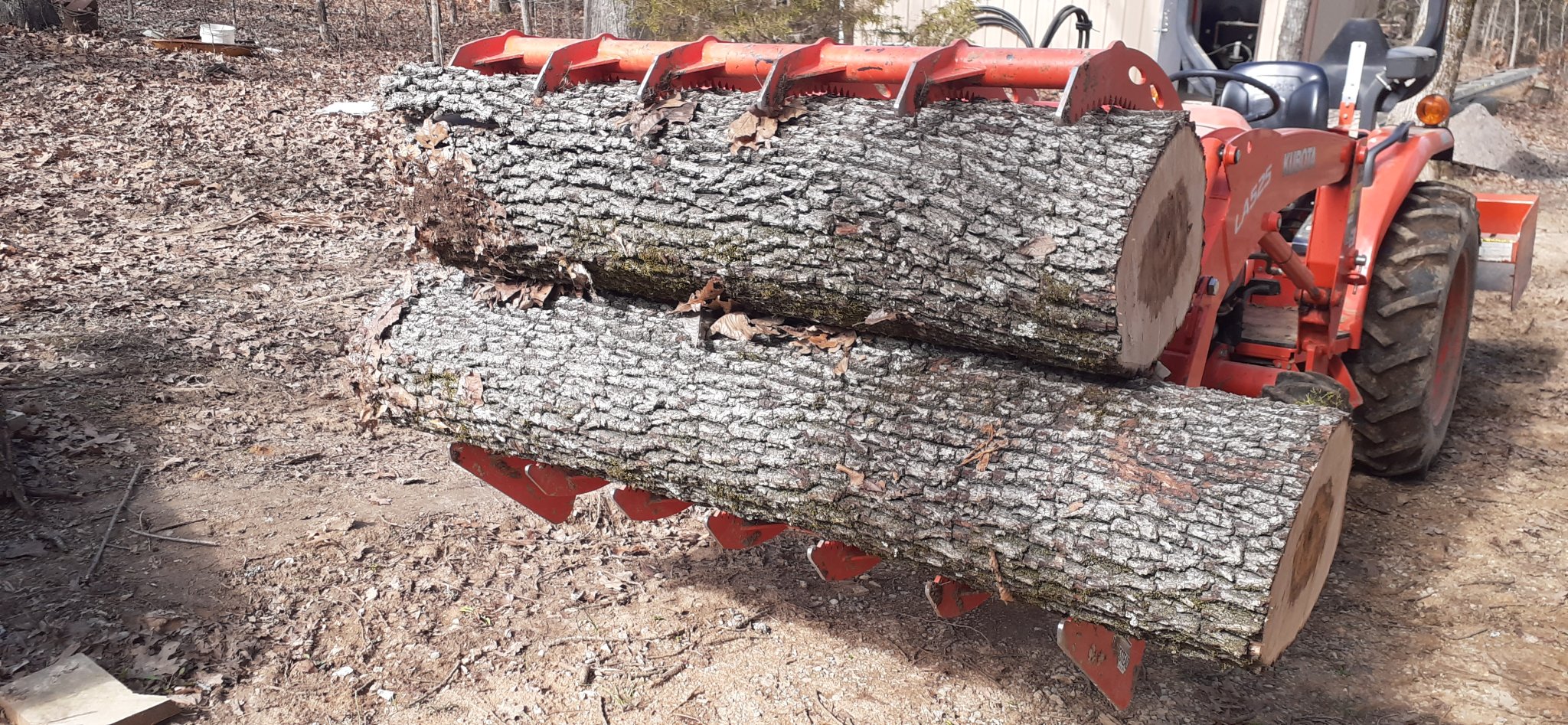

11,199
4,792
I chose forks over grapple 5 years ago. Overall a better decision.
They weigh less, means they can carry more
They are forks , so can carry skids of 'stuff'
They can carry a LOT of 'brush', once you get the hang of it.
They don't require $$$$ hydraulic upgrade
In the end, 'to each their own' , but base your decision on what you NEED 'them' to do.
If 99.44% of use IS brush related, grapples are probably best but if you have several tasks to do, forks are better.
Either way READ the specs and get the lightest weight implement for YOUR tasks.
