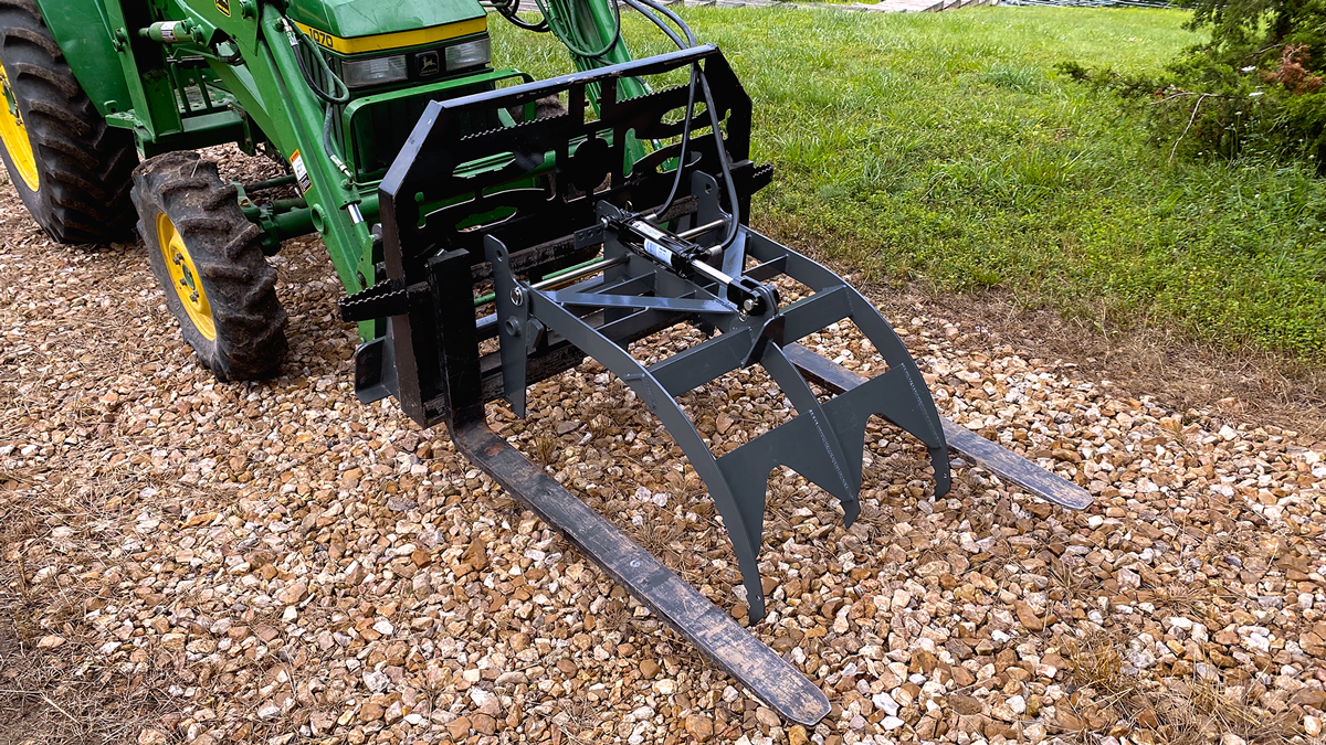

Other options I have found are bolt on grapples for the bucket, not a fan of this but some like them. I have seen pallet forks with removable grapple, that is something I am interested as well.
Having the ability to put on the grapple and use the forks to move brush easier or move a log around and taking it off to use it as regular forks. Seems like a good cost saving measure.

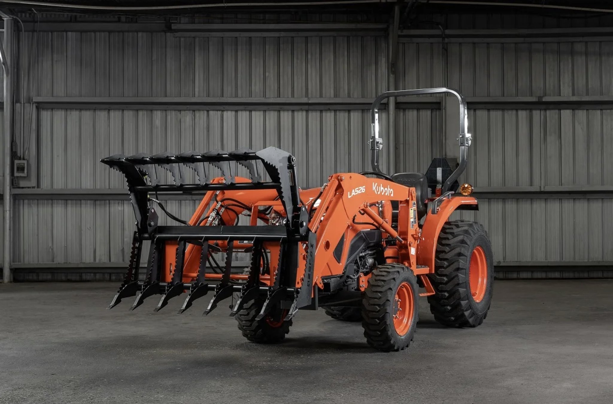

There is also an add on grapple for your bucket.
First one you list is a brush grapple.
Second one is a root grapple.
Third is a... waste of money.
Brush grapples do a great job at picking up material on the ground, they will float across the ground like a rake.
you can easily do some serious damage to the loader if you try and pry on things like a root ball as it has a lot of leverage.
That leverage and length also lowers the lift capacity.
The root grapple does a great job at digging up the ground to pull roots, rocks and such, it will dig in and not float, that can be it's bad point.
It does work great with logs and rocks and brush piles.
It will usually have better lift capacity because it's not as far out.
Moving Logs with a grapple is hands down easier than anything else.
One thing to watch, you might be able to lift a long log but you can very easily twist the loader if you hit the end of the log or it starts to swing.
Look for the lightest grapple with the weight / HP ratings to match your needs.
Having a heavy duty grapple on a L2501 you'll never be able to use it properly and it will reduce your lift exponentially.
And having too light weight of grapple you could tear it up.

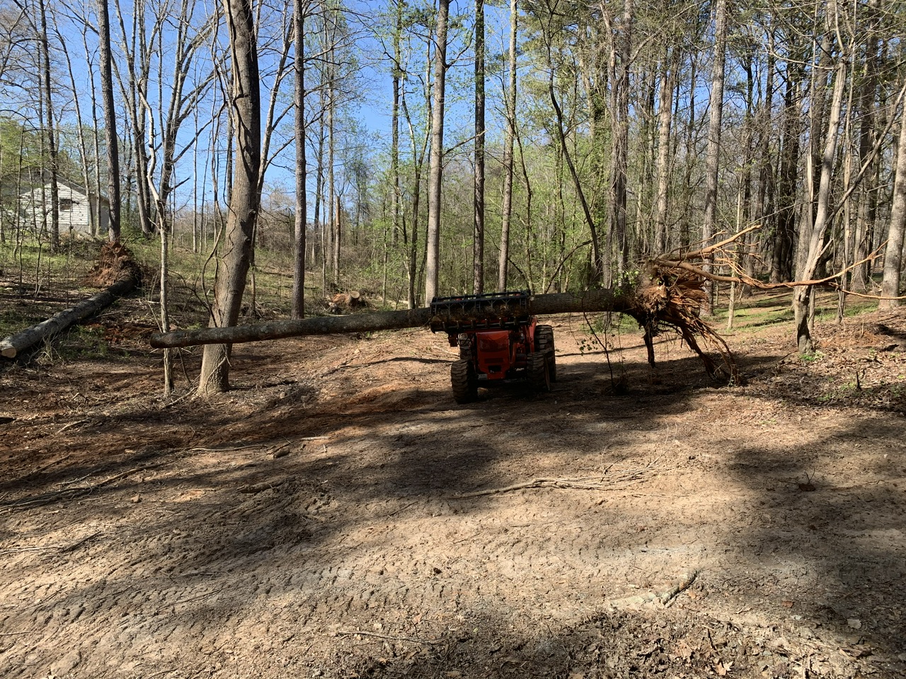

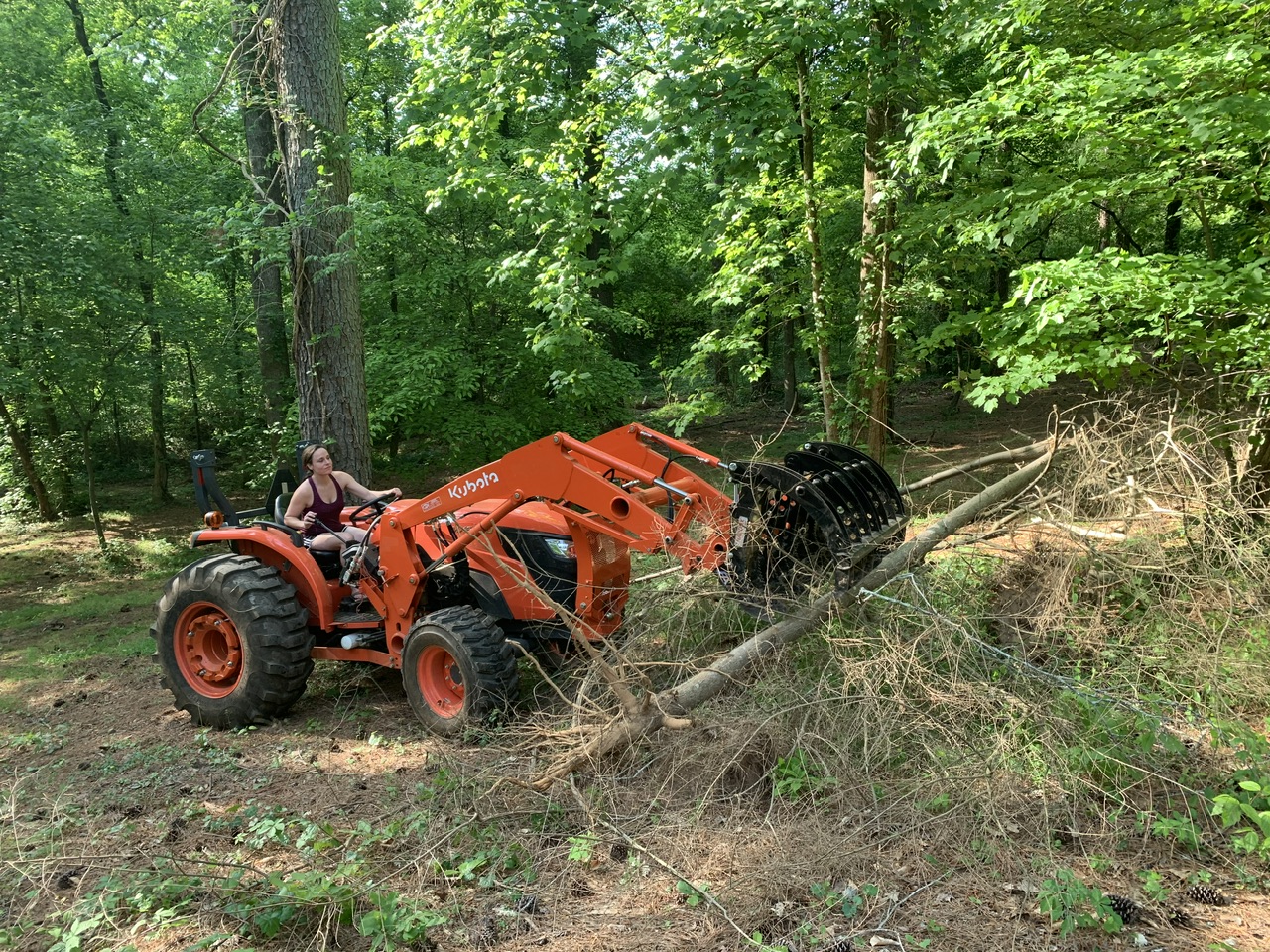

I’m partial to the root rake style myself. Had an EA 55 on the LX2610, and got an EA 60 for the 6000.
Handles uneven loads fine and can even pluck trees straight out the ground. Even the wife can use it!
Something in the 55” is the norm for your size tractor, though some match their bucket width, for whatever reason.
I also installed the summit kit on both tractors, very simple if you can spin a wrench and make some terminal ends.

I guess that seems to be the safest choice..it's just they are so expensive for that style for some reason and I wouldn't use it all the time. It's a tough decision to make. That's why I kinda liked the grapple add on for the forks. Depends which kinda you get, some of them open up quite wide and some don't. I kinda like them for what I would need but I agree the root rake style seems to be nicer.

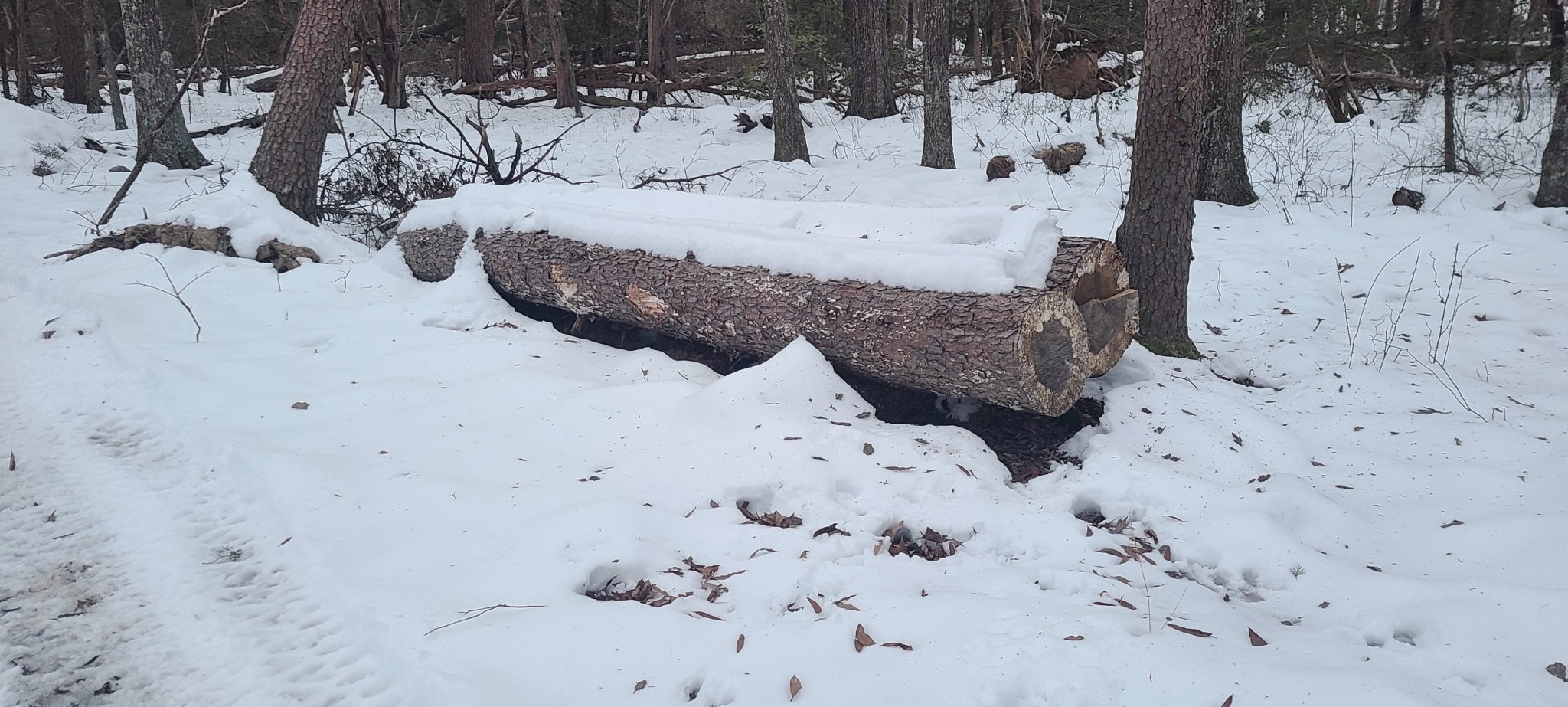

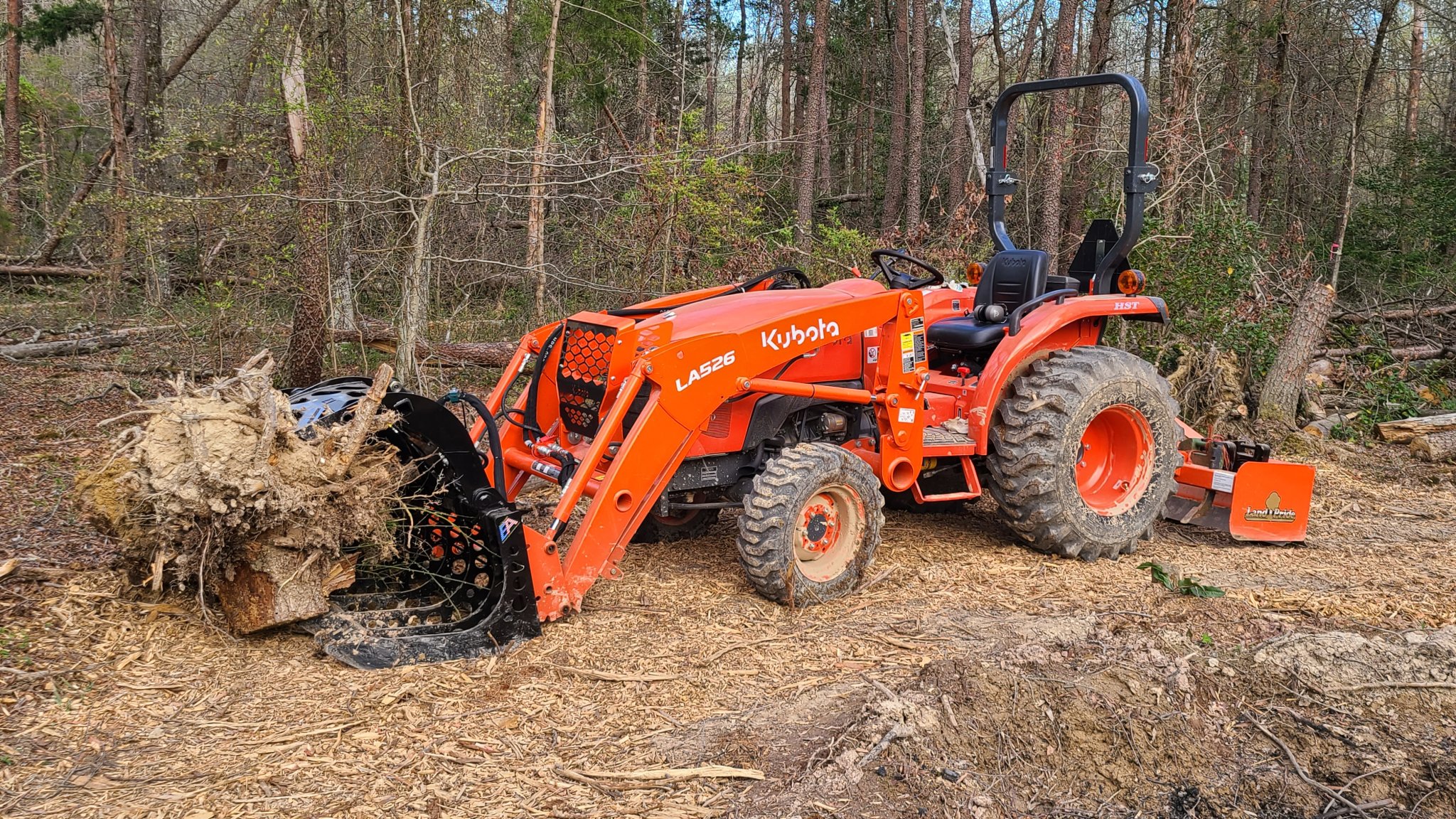

Your jobs sound like mine. Thorny scrubby underbrush. I opted for the first style. While it does gnaw away at lift capacity, it makes up for in volume.
The two logs below are about 22" diameter and 12' long. Each pretty maxed out my lift cap.
Each has to make their own decision. 😉
I was afraid to get flamed for suggesting the wicked 55" grapple, but I love mine as well. Also, adding a 3rd function is worth the price of admission. I use mine for both the grapple and the snow plow and it makes life much easier.

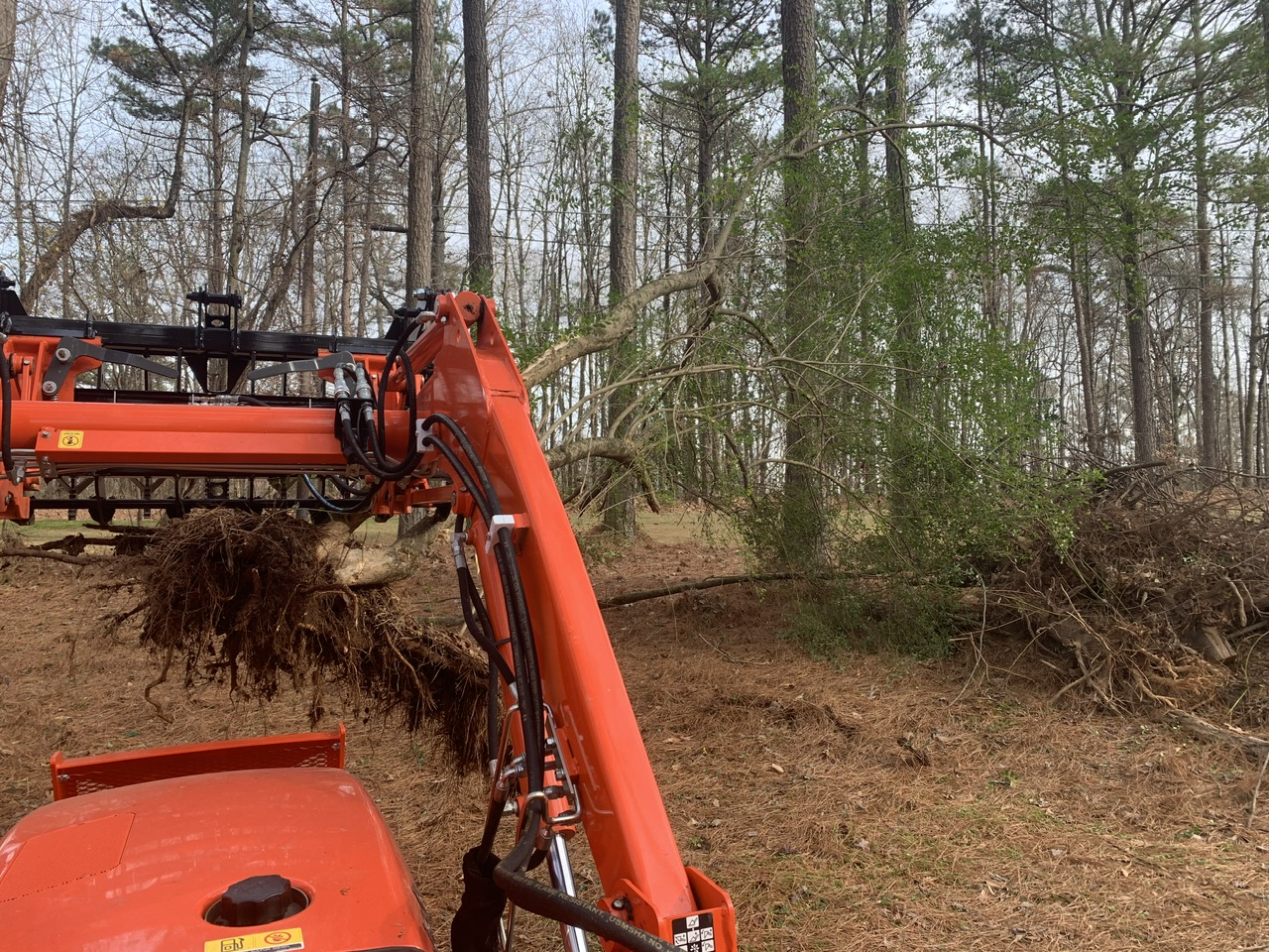

Just something to think about - if moving brush is a major use, a root rake/ clam shell grapple allows you to gather more than the other designs. Since the clam shell opens wider, you can compress a brush pile to the ground from overhead, and then you can close on the compressed pile. It will amaze you how much you can get in a single load, and you mostly avoid the potential of brush poking your tractor grill.

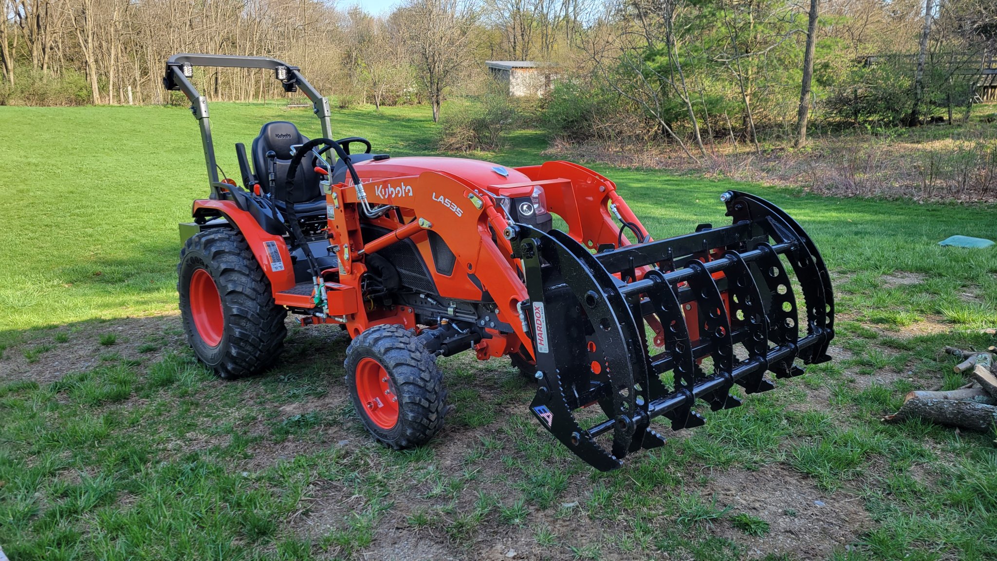

Food for thought: I rolled the LP SGC0660 (@250lbs) into the package in early 21 based on consolidated input from the brain trust here and couldn't be happier. My uses include initial major property clean-up of brush, deadfall & fire wooding in an old-growth forest on a ridge that hadn't been logged in 100y. My main other tractor use is landscaping and have massive amounts of glacially deposited boulders that constantly surprise me (think icebergs 😲 )
Contrary to those above, I generally keep the bucket on (buck rounds on site) and use grapple when I have large amounts of logs to move/stack. I occasionally use it carefully for rock but prefer the BH w/thumb as a safer option. FWIW I keep it inside and can switch on/off pretty quickly...
