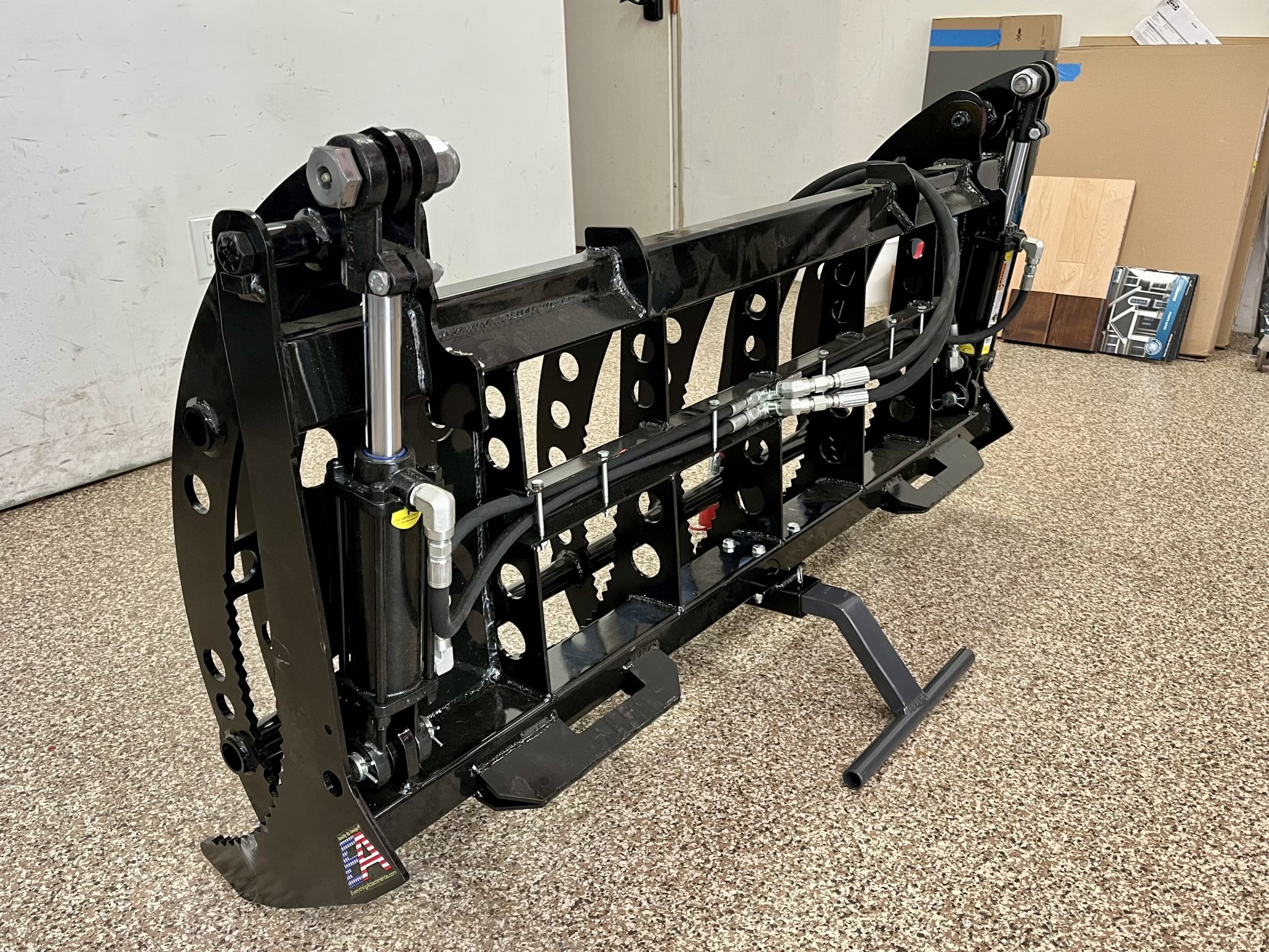

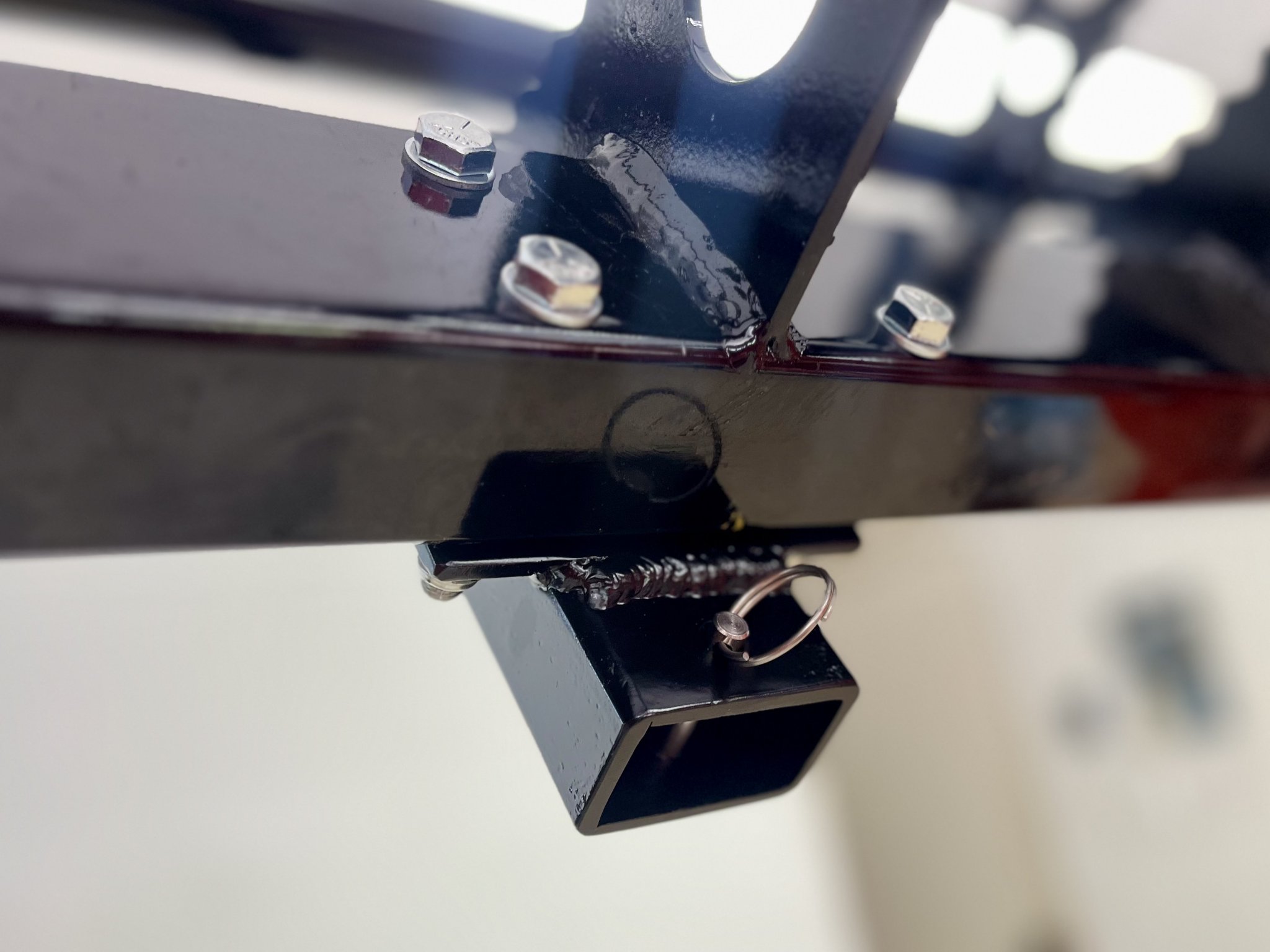

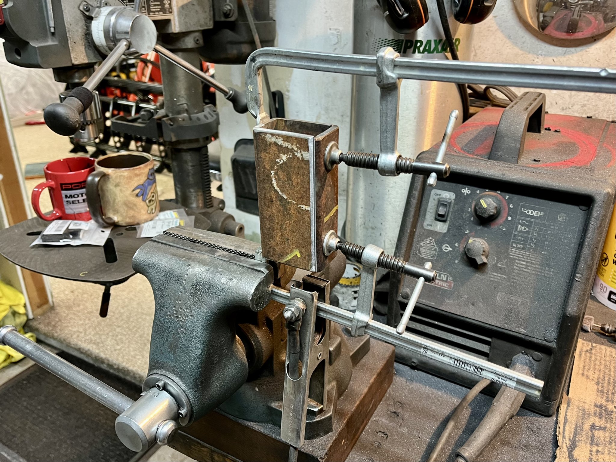

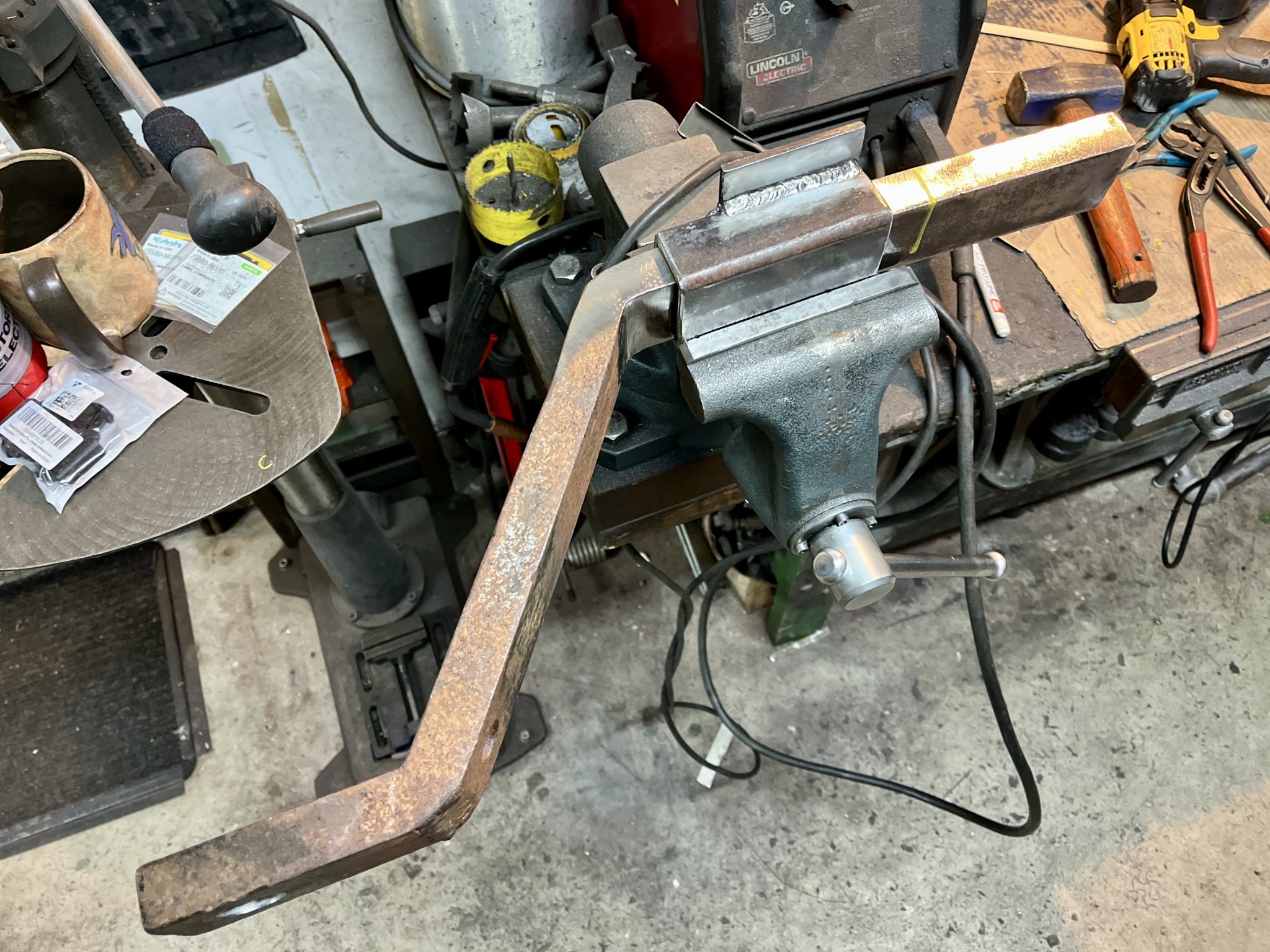

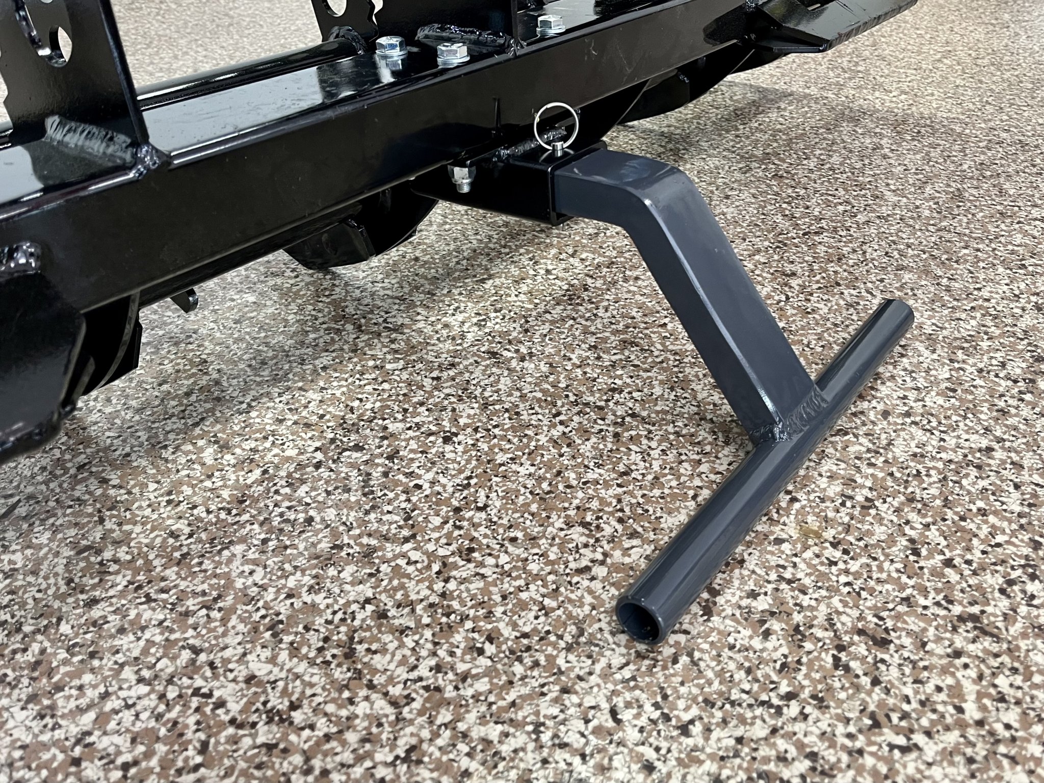

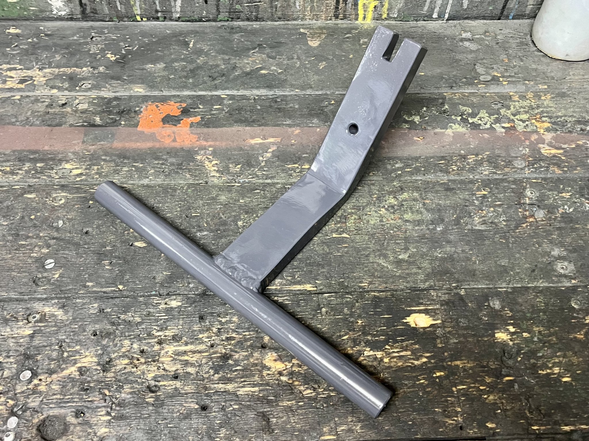

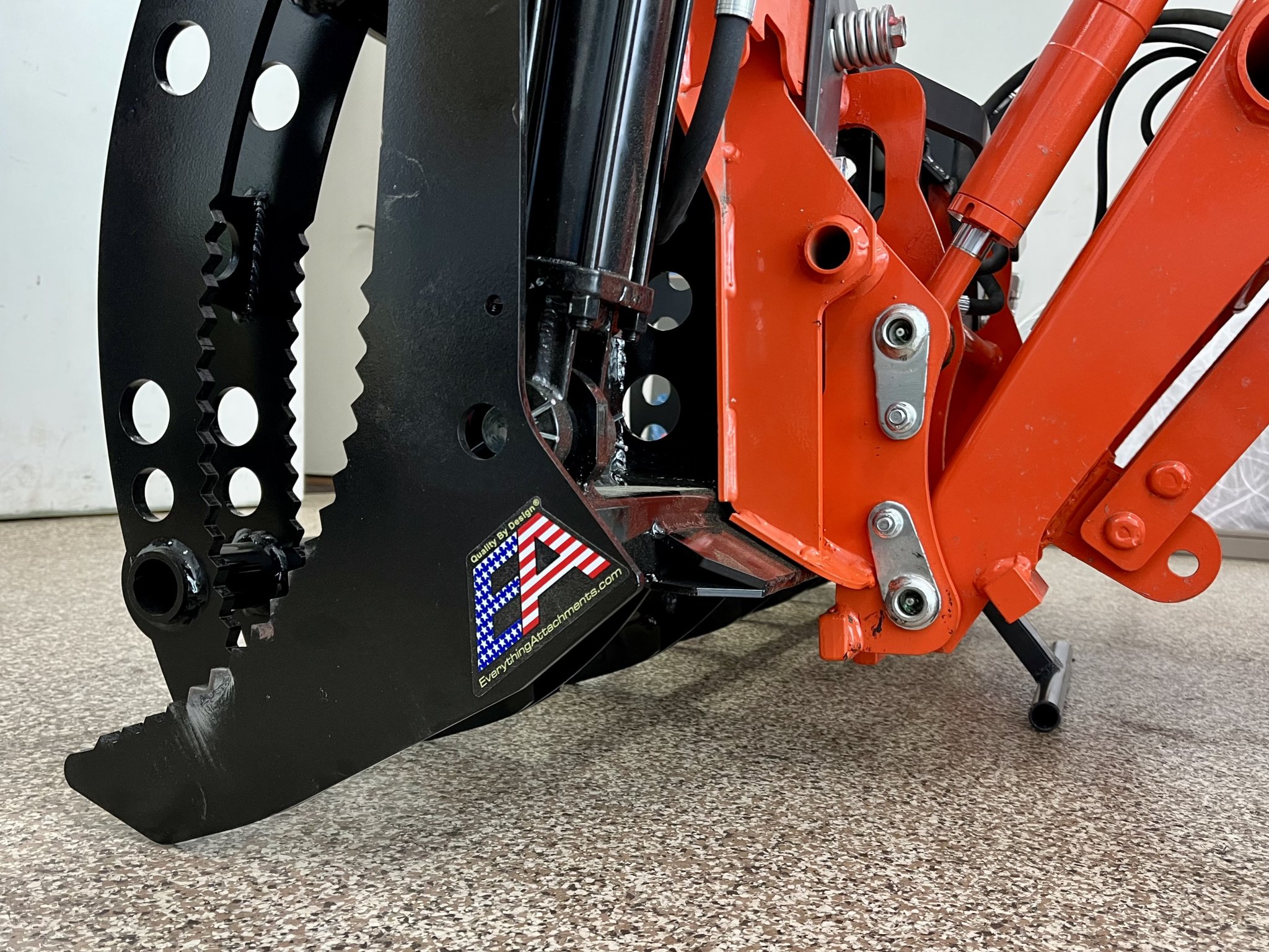

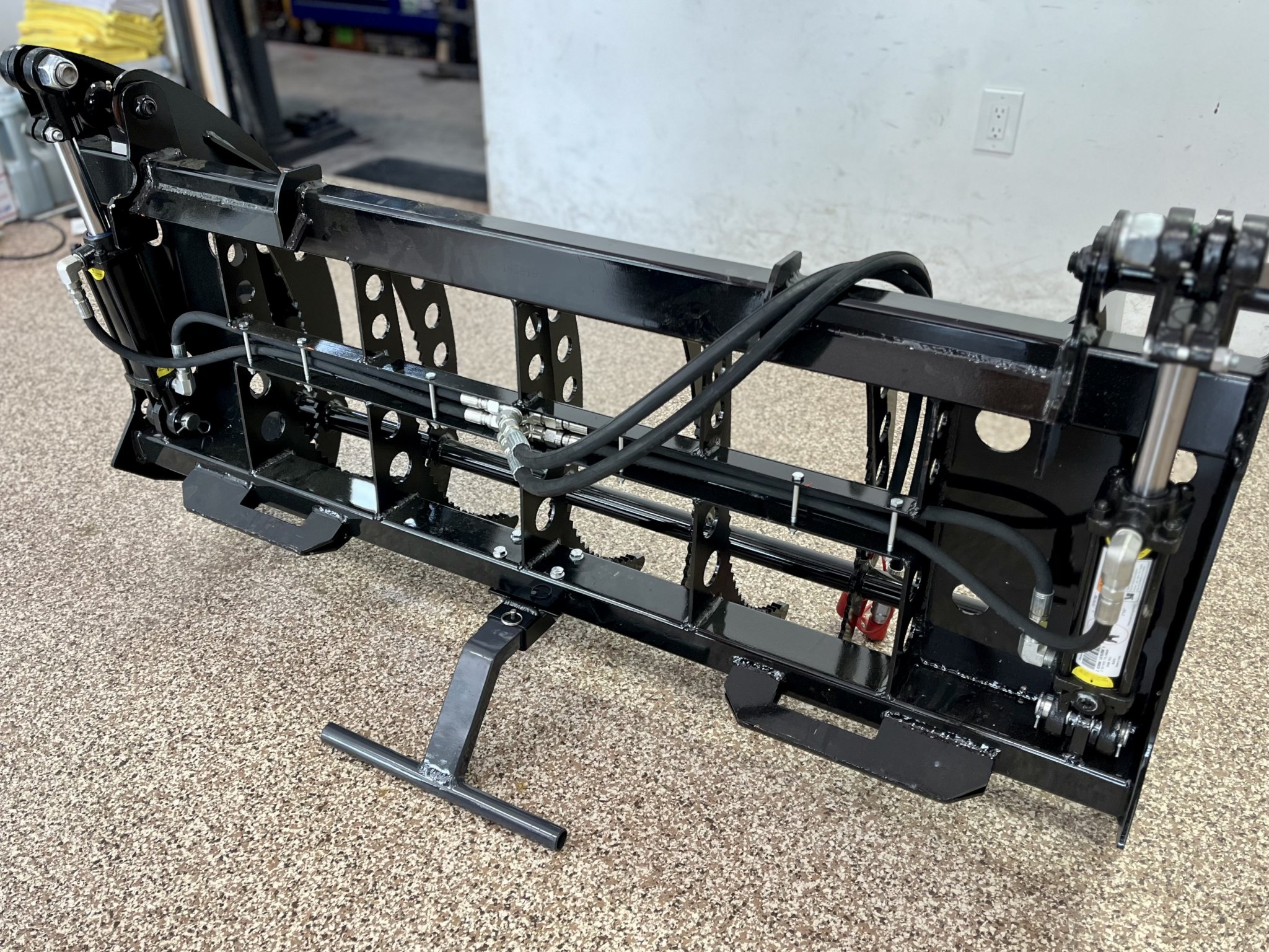

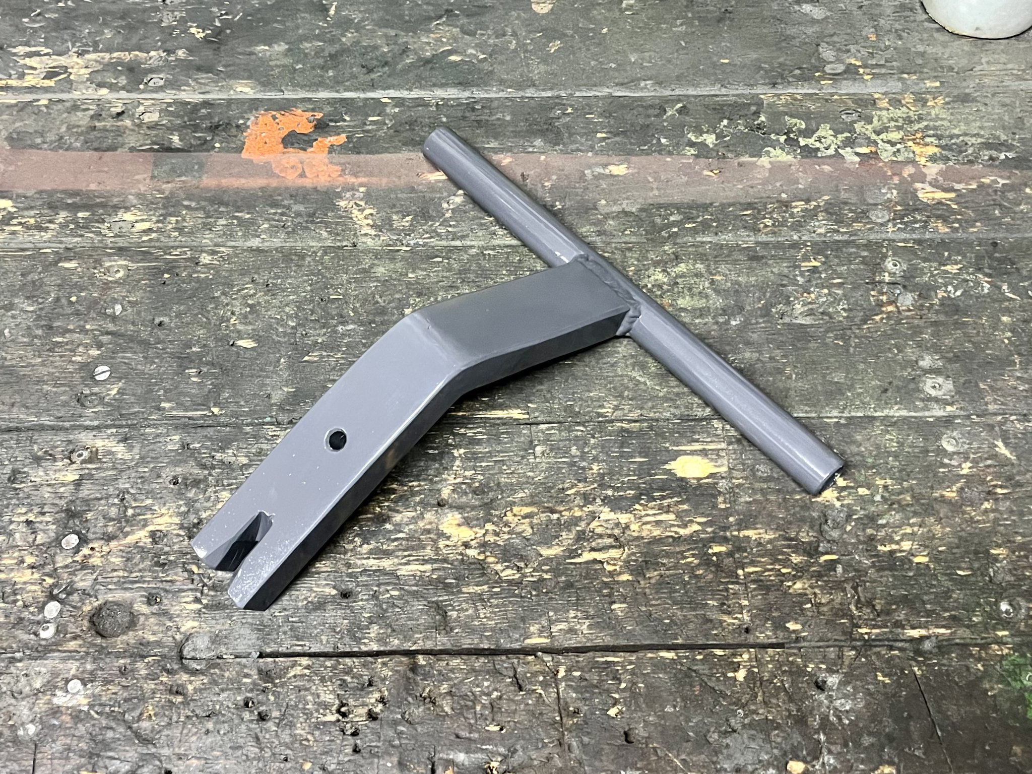

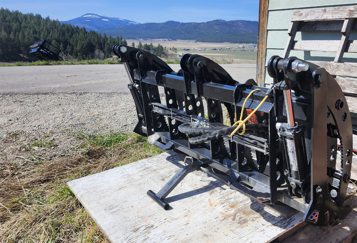

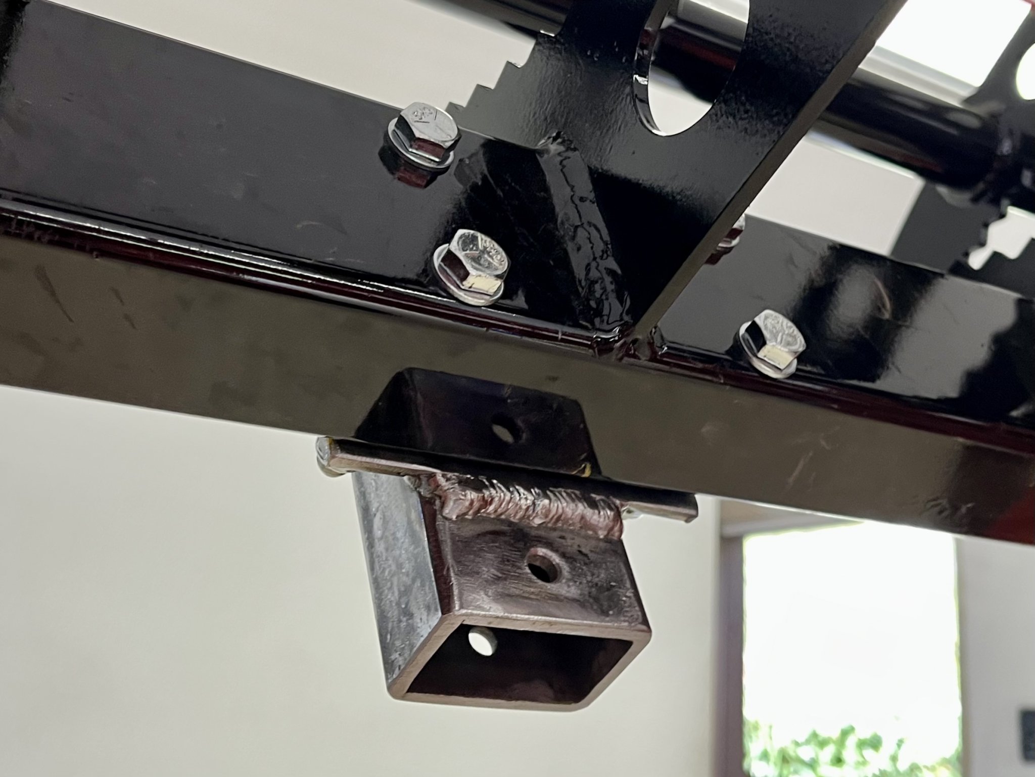

I recently made up a "kick stand" to support the EA 60" Wicked grapple. This particular model won't stand up on its own when it's closed and off the tractor. I don't need to worry about the cylinder rods during long term storage because corrosion isn't an issue up here. I want the grapple to be easy to get on and take off, I want it to fit on a pallet, and be stable when stored.
That's slick. I just received my 55" Wicked Light grapple and will follow suit if needed.
