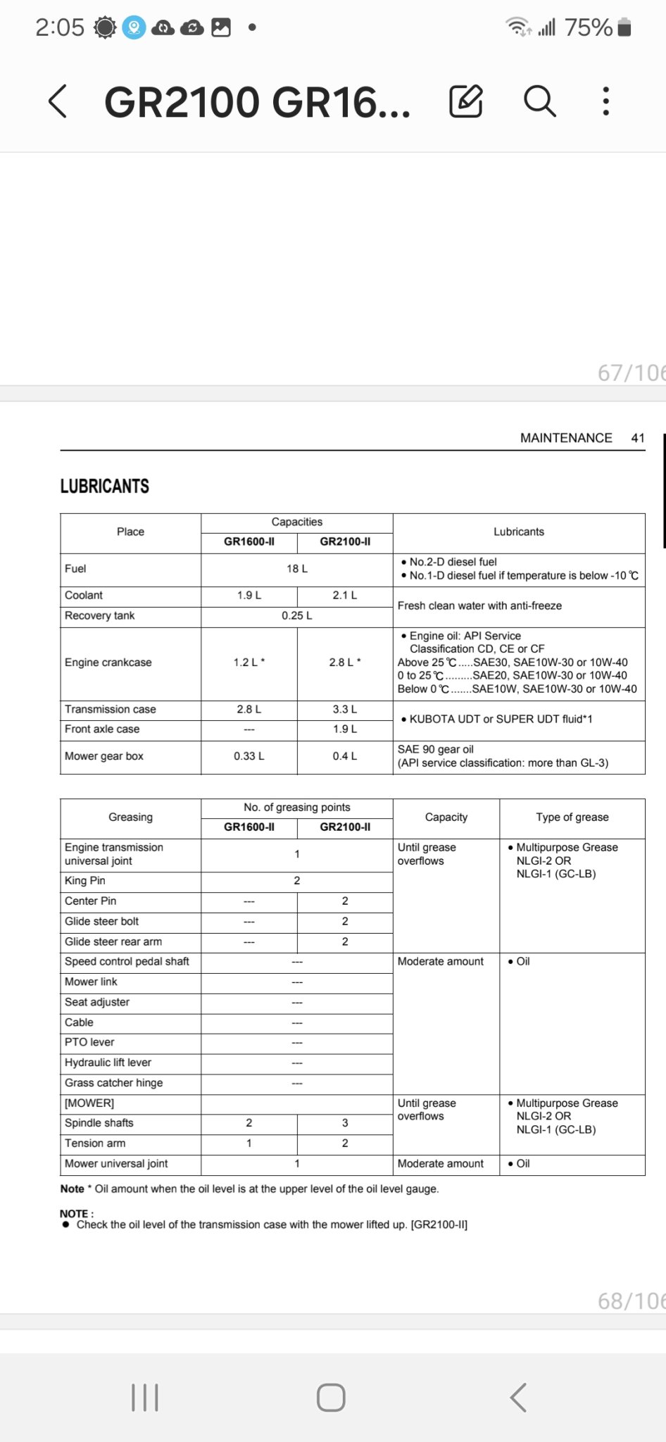

W wbillrad New member Equipment GR2100 Sep 24, 2017 3 0 1 lancaster VA Today at 10:29 AM #1 GR2100 manual is not clear on what fluid to use in the front axle. Have been using Amsoil 80-90 which seems to work fine but wonder if I should be using Super UDT?
