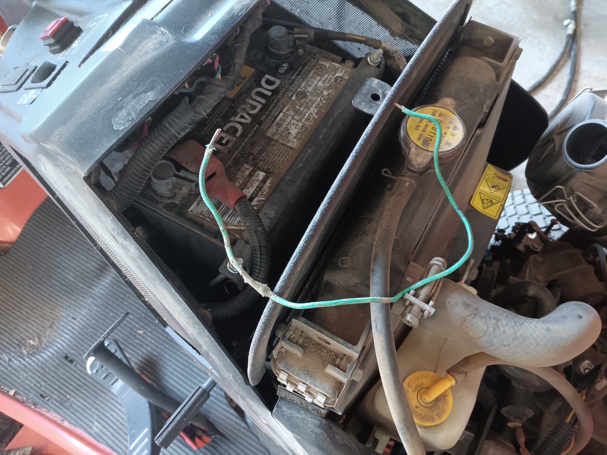

Here are a couple pixtures to illustrate hoq you jumper a starter.
The first picture shows the two terminals on the back of the starter.
Tye second picture is the gren jumper wire I keep hoojed in the hole on the top of the radiator screen.
I have a starter switch similar to the one in the third picture that "someday" I will get mounted in the dash to replace the jumper wire and make the process just like using the key.

It worked! Thank you for taking the time to help. Your instructions were great.
It's a little tricky as one person to put one's foot on the break, turn the key and place the wire correctly but I got the hang of it and it starts immediately.
Thank you again!! Had acres of grass to cut but was so happy to do it.
This is going to save me so much time and money!
