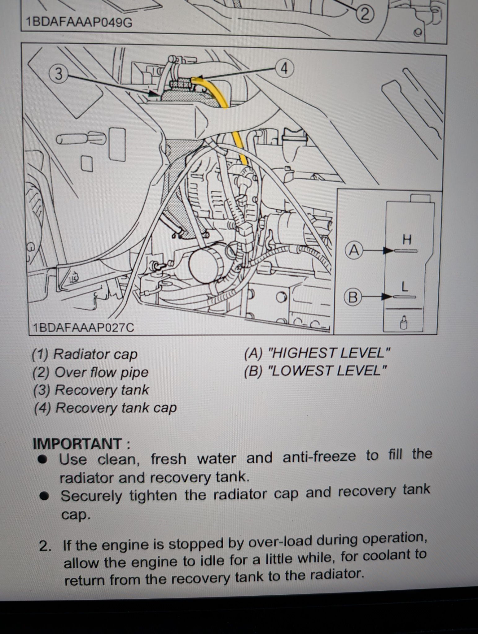

R Rober88 New member Equipment Kubota G2160 Aug 4, 2024 6 0 1 Canada Aug 4, 2024 #1 Hi, I bought a hose (marked as yellow) for the recovery tank. I realize it fits on the cap, but where does the other end go?
R Russell King Well-known member Lifetime Member Equipment L185F, Modern Ag Competitor 4’ shredder, Rhino tiller, rear dirt scoop Jun 17, 2012 5,341 1,402 113 Austin, Texas Aug 4, 2024 #2 It should attach to the radiator neck just below the cap. Look at #2 in the diagram just above what you posted. Sorry thought it was the rad overflow hose not the tank overflow hose! Last edited: Aug 4, 2024
TheOldHokie Well-known member Lifetime Member Equipment L3901/LA525, B7200DT/B1630, G2160/RCK60, G2460/RCK60 Apr 6, 2021 8,678 4,434 113 Myersville, MD windyridgefarm.us Aug 4, 2024 #3 Rober88 said: Hi, I bought a hose (marked as yellow) for the recovery tank. I realize it fits on the cap, but where does the other end go? View attachment 134248 Click to expand... It does not go anywhere. That hose dangles down the right side of the engine and dumps on the ground Dan Last edited: Aug 4, 2024 Reactions: 2 users
R Rober88 New member Equipment Kubota G2160 Aug 4, 2024 6 0 1 Canada Aug 4, 2024 #4 Ah, makes sense.. thought that might be the case. Appreciate the image. Thank you! TheOldHokie said: It does not go anywhere. That hose dangles down the right side of the engine and dumps on the ground Dan Click to expand... Last edited: Aug 4, 2024
