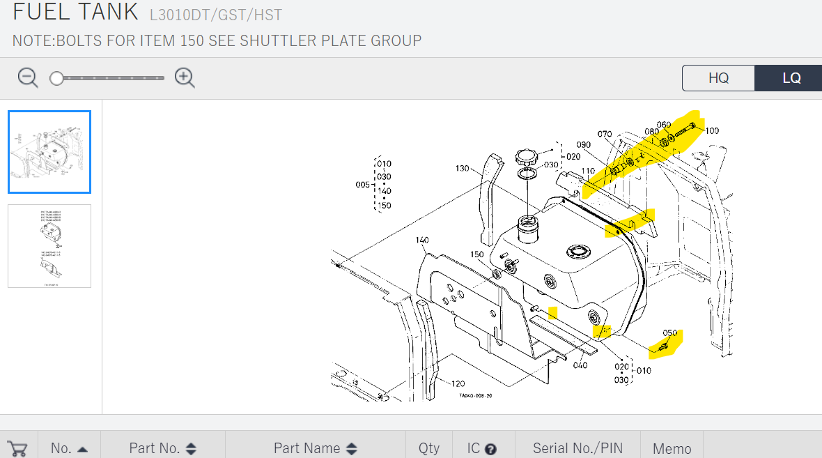

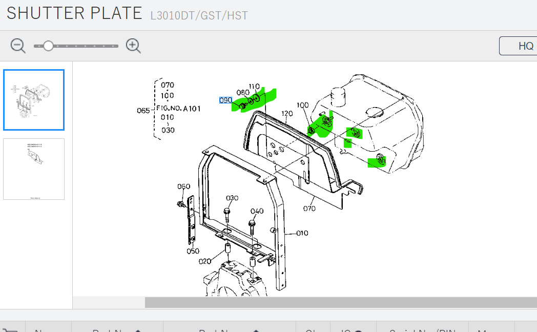

H Huskbota New member Equipment Kabota L3010 HST Aug 28, 2023 5 0 1 Tionesta, Pa 8 minutes ago #4 That would be obvious right? Did you ever remove one? Part number 010 goes over tank toward the rear. the only way I see to do it is to remove the muffler to allow plate number 070 to slide forward enough to allow tank out from under number 010
