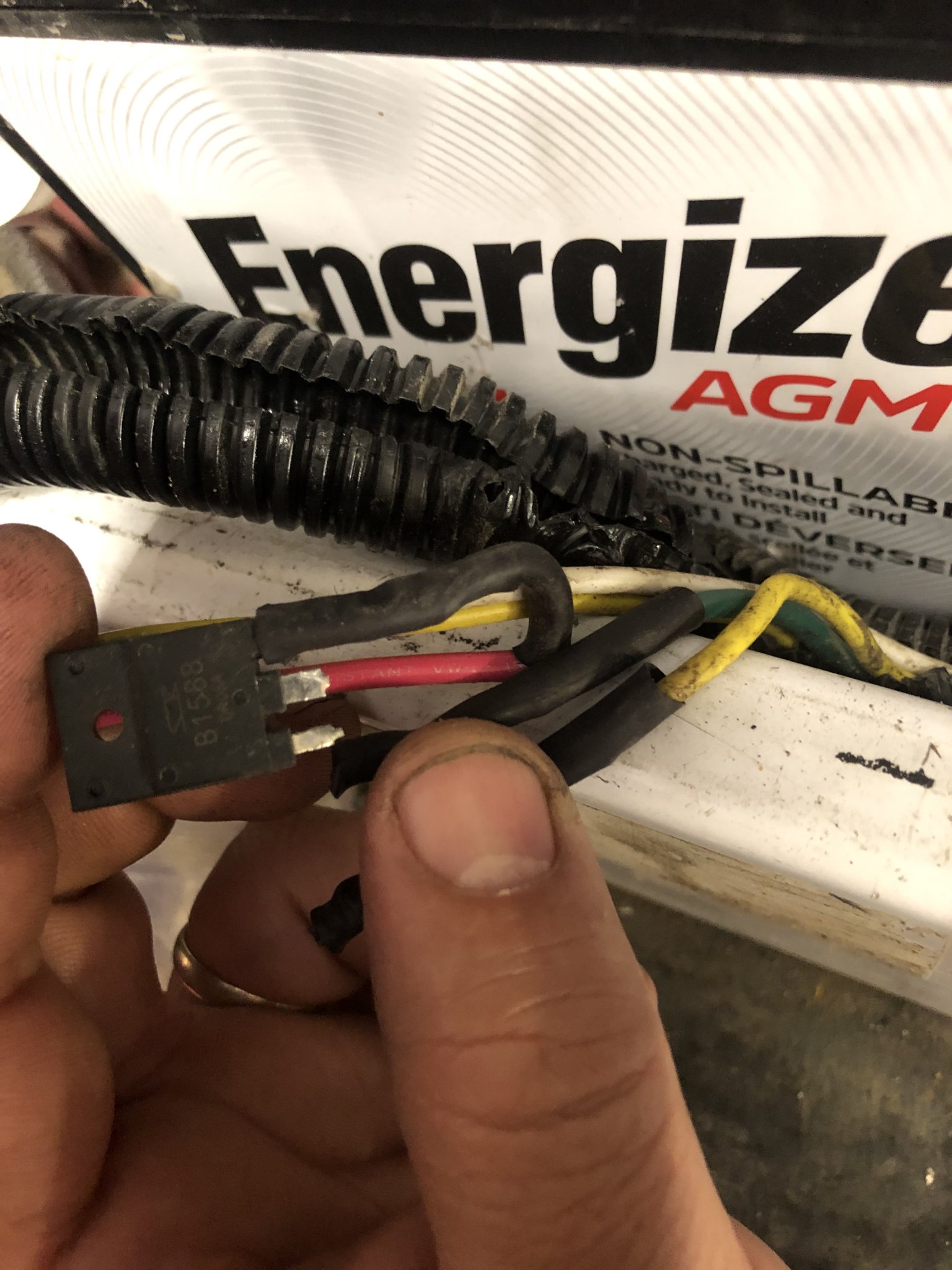

Another thought is I have this one terminal that was connected to the battery. I traced it to the flywheel sensor. Do you think that should be going to minus or plus? I think the sensor housing is grounded, because it’s like a threaded bolt, bolted to ground. So I assume it should be positive. But I had it connected to negative. Maybe that’s effecting it not starting? But I’m scared to connect it to positive. Don’t want to brick this unit

I guess If I unplug the connector at the solenoid and bypass it to a momentary switch, and back again, I can start it and still shut it off by pressing the momentary switch. But I wish I could figure out what I did wrong. Do you think a disconnected flywheel sensor could have anything to do with it? Would it be stupid for me to connect it to positive battery terminal? Do you know how those work?

Without the wiring diagram for your use I couldn't tell you what the flywheel sensor is doing or how it should be wired.
It shouldn't have anything to do with the shutdown solenoid but it might.
Tractor and normal kubota equipment doesn't use any flywheel sensors.
Can you get a wiring diagram for the unit?

Yea the two 30 amp fuses were checked. The only other thing is this mystery wire that I’m pretty sure is supposed to be hooked to negative. Appears to feed magnetic flywheel sensor. Maybe it’s supposed to go to positive? Maybe there’s a fuel shutoff tied in somewhere if the flywheel isn’t turning? I’m a noob so I don’t know if that makes any sense or not. Should I risk hooking it to positive? Maybe that fixes everything.. I was thinking maybe run a 5 amp fuse online, so if it’s not supposed to be positive, it might prevent burning something out. Scared to do it. But I think that sensor just feeds into the “shocker pass” system which I’ve had unplugged since day one.

Thanks for the schematic. Do you happen to have the control panel schematic? Your compressor has some shutdown features, oil pressure, engine temp, air compressor fault, that most Kubota tractors don't have. I don't see a flywheel sensor on here.
