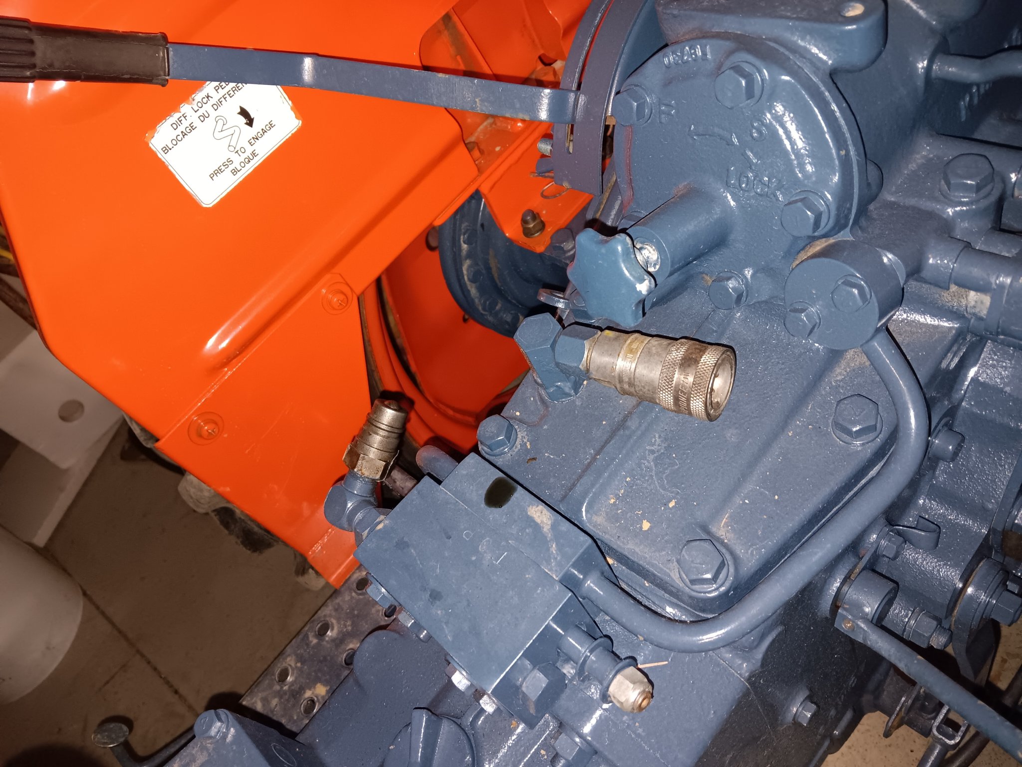

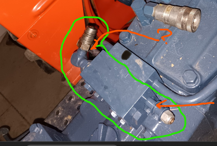

I don’t know what is going on with that block either. The female connection may be just a tank return. On my L185 that same cover has a port on the opposite side of the cover that is just an opening into the transmission. That is the hose with the 45 degree fittings.
@TheOldHokie made the block for the hydraulic takeoffs. The near side hose is power out to the valve the far side is the power return from the valve and the hose at the top is the tank return.
here is a thread that shows the fluid flow of the tractor before and after the adapter block (in post #1)
32,539
8,160
That block on his L185 is a diverter valve, I think automatic, but the other side might have a pull knob or lever.
It's set up as one output and no PB return (it's capped).
The tank return is behind it.

I dont understand "automatic". How would the 3pt get power when the outlet is in use?

The "auto" is just a guess, lack of info.
I would think it could work just like a proportioning valve on a steering circuit?
I fully expect you to tell me I'm wrong. ;)

I dont know whats right or wrong here :)
I dont see a "valve" so my gut intuition is its just a tee and you have to lock the 3pt to get pressure.

Is that a plug on the opposite side from the male connector?
Maybe it is the right block being used the wrong way?

Pretty sure this is a diverter valve of some kind, and the orange is a valve.
