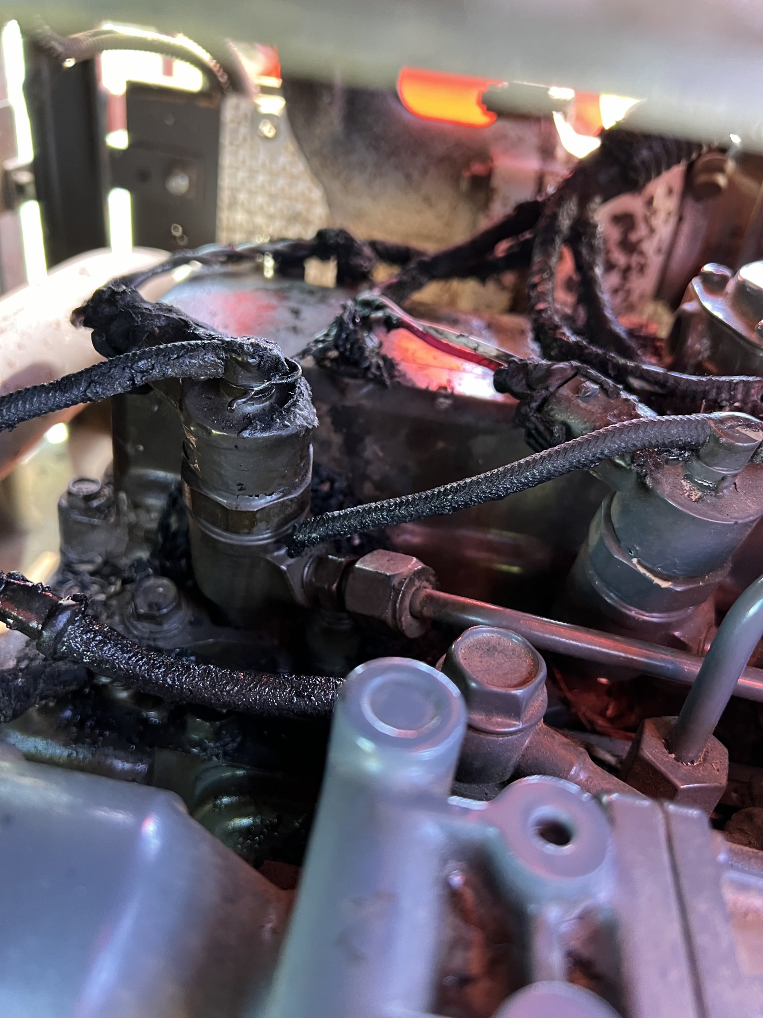

I own a 2019 Grand L 6060 HSTC. I was bushhogging the other day and saw the regen light illuminate. Then I smelled something and then I saw smoke. Immediately stopped the engine, opened the cowl and at the back of the engine there was a small fire burning (see photos). I put the fire out quickly (poured water on it). The tractor starts but there’s diesel fuel dripping from one of the lines. I had a diesel mechanic look at it and the estimate to replace the engine wiring harness is around 5k. Does this seem reasonable? Many thanks. JW

Seems low to me. There's 3 'wiring harnesses' I can find, EACH is $2K CDN ! The big issue are what's connected to the harnesses(sensors,switches, etc.) If their ends are damaged, probably 'need' to replace those as well. I do NOT suggest the 'cut/solder tape' method that Nissan Canada approves and uses !!!!
I suspect the 'estimate' will cost closer to $10K 'out the door- field ready'.

Checking on available insurance coverage is certainly a positive step…. but it’s likely any homeowners policy has a 3% (approx) deductible. This would mean that a home would have to be insured for at least $170K before insurance would even come Close…to matching the existing bid for the harness replacement.…. and in a case such as this…. “Close”… means a “Wash”…. and likely higher premiums after all the paperwork is done. I.E. — A homeowner’s claim would be a poor choice.
Before I’d spend $5K … I’d personally accomplish the repair using the “cut/solder/tape” method.
(If the OP considers himself unsuitable for this repair…. a radio or avionics/electrical repair person charging $125/hr could likely accomplish this in one day…for less than $1250.)
Is the “dripping” fuel line at a connection..?? perhaps with a fire-damaged O-ring which can be replaced..?
Or is it a plastic return line…?? Can you pic the area of the drip?

re: a radio or avionics/electrical repair person charging $125/hr could likely accomplish this in one day…for less than $1250.)
That's very optimistic , and I was trained as an Avionics tech !
Now IF the entire engine/dash areas were perfectly cleaned BEFORE coming to me, you still have to open each leg of the harnesses, check for damage, confirm/deny EACH wire is good/bad. ANY fire damaged connector has to be replaced, then tested. You'll obviously have to have GOOD wiring diagrams for THAT tractor( I saw 3 different versions of the harnesses ! ). All 'sensors' that have damaged wiring should be replaced , at least properly bench tested for correct operation. All replaced wiring needs to be SAME colour and gauge of course, for future trouble shooting.
IF it's ONLY the engine harness that IS damaged...1 day to remove and inspect, 1 day to repair, 1 day to test, 1 day to cross fingers and start engine.

Ya, Dont run it anymore than you have to. Next will be an electrical fire. Sure if you have insurance it should be easy. Otherwise if it was me Id source a used harness, even one from a different 4 cyl. As it looks like the injector pigtails, and the injector solenoid may be toast. The solenoids are removable, so you could just swap them from used injectors. The compensation shouldn't be an issue unless you change the body. The part leaking is the fuel return lines. Should be few bucks from Messick's. I would say anyone worth their salt can fix it for $500. A whole harness would be time consuming, and not necessary. This is coming from a mechanic/body guy. Id offer to fix it if you were closer...

I'm not saying do this - just another possibility.
Some of the protective covering looks melted. If the conductors underneath are OK, then it's not a big job replacing the covering.
Damaged conductors can be spliced; heat shrinked; or electrical tape wrapped. Then protective covering. Or, cut out the damaged area, splice in new everything across that boundary.
Plastic connectors can be replaced.
Hoses can be replaced.
Seems like a knee-jerk reaction these days is to replace everything.

Is there any chance that it was a bird nest that caused this? I've had wren nest on my tractors plenty of times.

I don't have the expertise he does, but my first thought was that could be pieced together, instead of a new harness......

Although it's hard to tell the actual extent of the damage without inspecting it personally, it does not look too bad to me.
Before I dropped 2K on a harness, I would start peeling back all the protective coverings and assess the "actual" damage. You might be into this for just a days work with your "crimping tool" and a few splices, and a few parts that are actually bad.
The biggest question is going to be the "computer" part. What parts have to be "matched" using a scan tool, or would splicing things cause bigger headaches due to resistance changes or such?

For example here is a connector
https://www.ebay.com/itm/385397474626?itmmeta=01HVS80C7136YESBHMDZMBTMMT&hash=item59bb7ac542:g:Xd0AAOSwzA1j4Tqx&itmprp=enc:AQAJAAAA8CmFLl8h2L5ZaTg1dOx0Ulm8ofsgODP0e/2e4Zx9eddkJL3gDYki8inrxqWerKBTE3h6fBezXUNuAOEtG1LwlK3B5h21JxNPpzLedXLBZndvmAqWWAKYhsRh98pIonrT6sczrcj/ayLg9apdKeMEAoTCNE4DA76xt7HLMWRb6rYdCzWtQjE7nEAvX58pLRQ5QUIBTB+4Ye65tepFGXdIVio3d/sIJcBt7iQp/10zi8kQx+2zCFEIXMSQfeFGTusC3mlpVLKXqP7oo1xSKGidDAHbHnGT3YP/wUqZOmXmDzb39nCqFYo/vwbngqq9BjTWPQ==|tkp:Bk9SR97DgajeYw
Here is a used injector to rob the actuators from.
Messicks part for fuel line 1J800-42500
