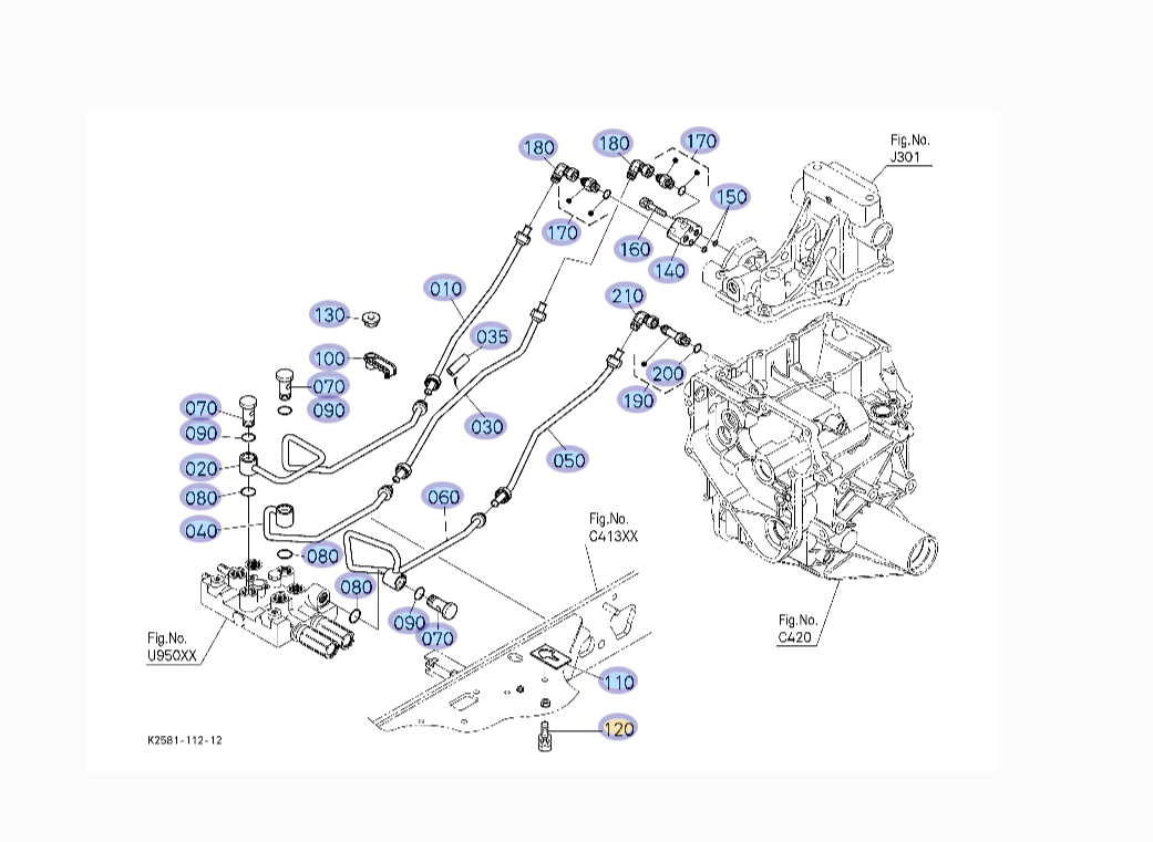

You can get a valve from Summit, Surplus, etc. You can get float on the boom, but not some of the fancier things Kubota likes to do, but it'll be good enough (you'll need a power beyond adapter). You'll have to mount it somehow in a convenient place, and you're ready to start plumbing. You'll need to run the 4 hoses, with quick disconnects, from the valve to the loader. Kubota uses hard lines and a bulkhead bracket to mount the QDs. You can use 1/4" hoses and bulkhead if you want. Then you'll need to run the pressure, power beyond, and tank lines as shown on the diagram below. You can use hose, but you'll need the hydraulic block 140. There are some guys on here that have made some to sell; maybe it'll fit yours.

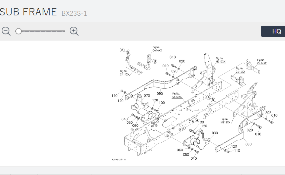

You are trying to install a loader that is meant for a tractor that is different and much newer, a BX23S.
Your Bx2350D was designed 10+ years prior.
Just look at the differences in the subframe and mounts.
The stock hydraulic controls and plumbing in parts is going to be extremely costly, there is a lot of parts to it.
And that is if you can still buy all the parts.
