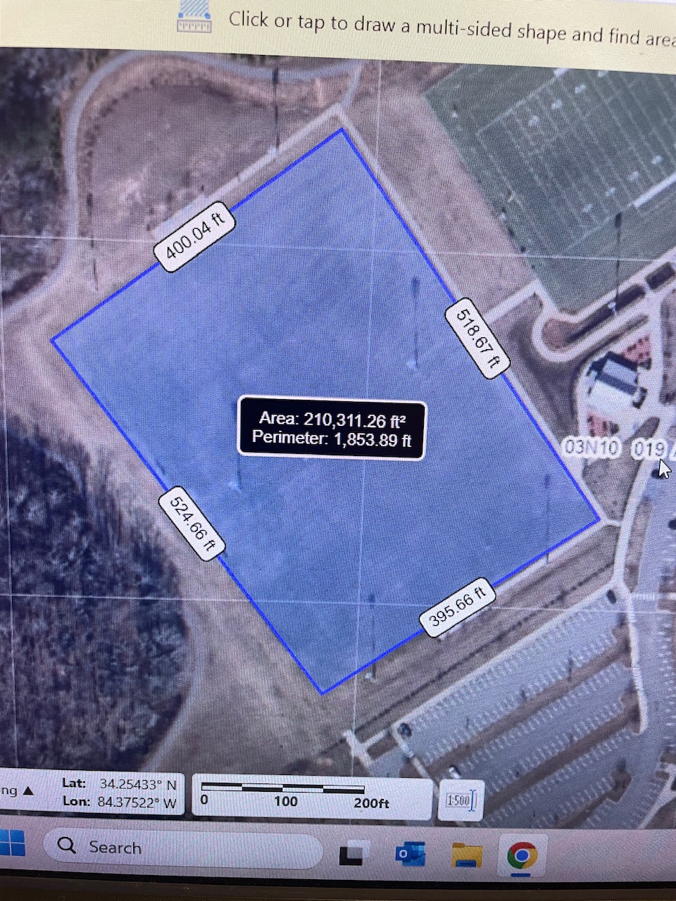

Yes, wide open multi purpose fields.
Just did some math on the fields I use to mow, 4.8 ac and I could do it in about an hour or so depending conditions. I always mowed in turtle.
This patch is 2 fields. Large enough for full size soccer on each.
Will mention the height of cut on the F’s is a set it and forget it. It is adjustable, but sorta janky and confusing if you have multiple operators changing things.

Sorry for the late reply. So this is to say you were getting about 4-5 acres per hour of production out of it? I was only getting 1 to maybe 1.5 out of my zero turn.

Maybe. It’s been 5 years since I’ve had to mow, I spin wrenches now. I could be remembering wrong and it was about 45-1 hour per field. That would be 2-2.5 acres an hour, as 4 just seems high.
I’ll ask the crew lead up there her thoughts, as that mower is still there.
Talked with her, they are mowing it with a 60” scag zero turn and it is taking them about an hour per field. So I have no idea what I was remembering now. Lol. I still say that 4.8ac can be done in under 2 hours with the F.

Thank you for the insight, it is much appreciated! I think I will use a rough production rate of 2 acres per hour using a 60" deck, and maybe 2.5 acres per hour if I run a 72" deck.
