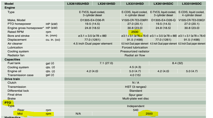

My new to me LX3310 says 2500 RPM is the correct PTO speed. Full throttle is exactly 2500 RPM on the tach. Could be they have adjusted the throttle to prevent over revving.
If you think that's what your LX3310 ( or operator's manual) says you need to go back to what it says about operating under the influence. PTO rpm and engine rpm are two different things.
I merely made a relevant observation that my Kubota's Full throttle setting is what the manual states as the correct RPMs for PTO operation.

Not the throttle, the governor does that (either electronic or mechanical).
I am fairly new to the forum.
I have seen several "I'm smarter than you" posts on this forum that are neither relevant or helpful. Seeing it from a moderator may indicate this mentality is deeply seeded and this may not be a place I am comfortable sharing My Knowledge.
I am fully aware of how a governor works. I was a certified MASTER AUTO TECH for 25+ years before turning to machine work for another 19 years before retirement.
Nowhere in My OM does it discuss a governor. It tells you how to operate the "throttle" and it tells you the correct RPM setting for PTO operation. 2500 RPMs on My model results in 540 RPM rear PTO speed and 2500 RPMs for the mid PTO. My observation to the OP was the full throttle setting on MY Kubota WAS the indicated PTO RPM.
Any more attempts to insult me may fall on blind eyes. You guys are TOO smart for me to learn from.

I misspoke, according to specs above your pto speed is indeed 2500 which sounds insanely fast but it's right there in black and white. I can't keep farm tractors and amphibious lawn mowers sorted out which isn't good when talking about Kubota. I just learned something else ,according to spell check Kubota is both singular and plural. No such thing as Kubotas.

Actually Wolfman your answer was not totally correct. Tractor manufacturers and other equipment manufacturers set the rpm limits for operating using adjustable stops on the throttle linkage. Yes the governor helps control and maintain the speed but the throttle stop on the linkage keeps you from adding more fuel and speed to the engine, keeping it at a prescribed speed.
