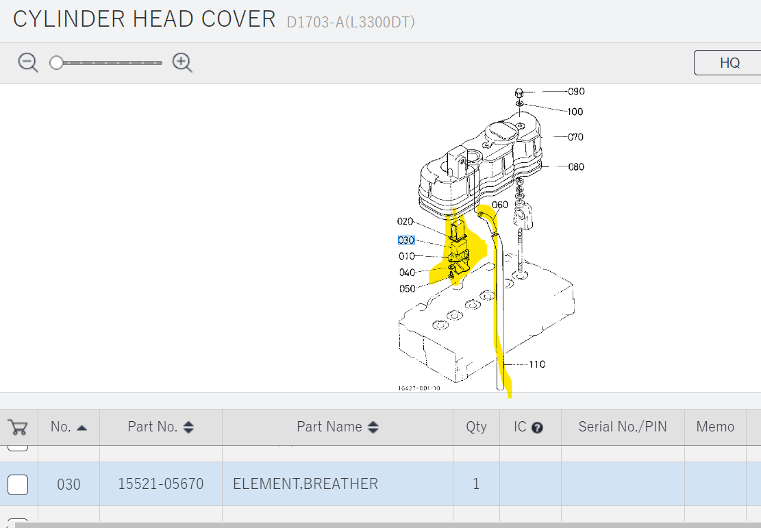

I have a 1994 Kubota L3300 with 400 hours . Cant locate the engine breather. I will need help locating it ,how to service it.Thank you every one at Orange Tractor Talks .

The crankcase breather is inside the valve cover with an open vent tube. If regular maintenance isn't called for, I'd clean it when the cover is off for adjusting the valves.
