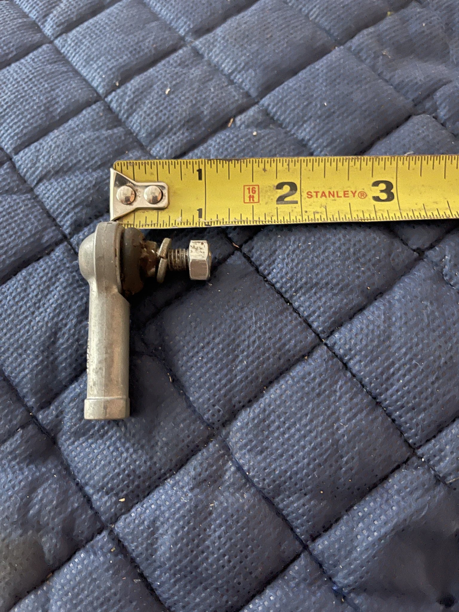

Three point hitch lift rod ends wore with lots of play on Kubota M6800. OEM part $$. The female and stud end are both 6mmx1.0 coarse threads. Can order 4 generic for half the price of the OEM.
