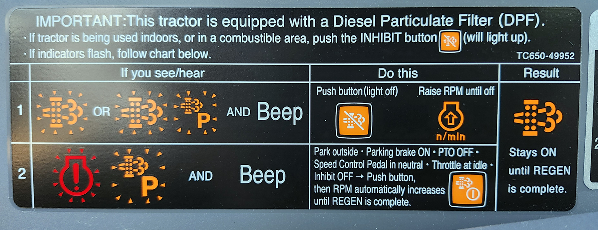

So my L3302 DPF lights start flashing, ok no bid deal look at the decal on the fender for instructions and it screwed me up.
1) So if the DPF lights come press the inhibit switch and raise the RPM ? What?
