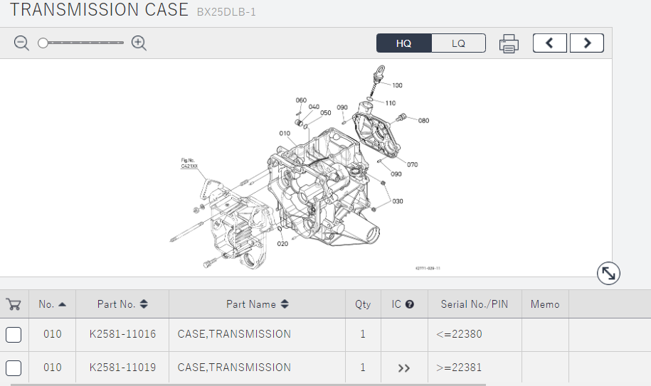

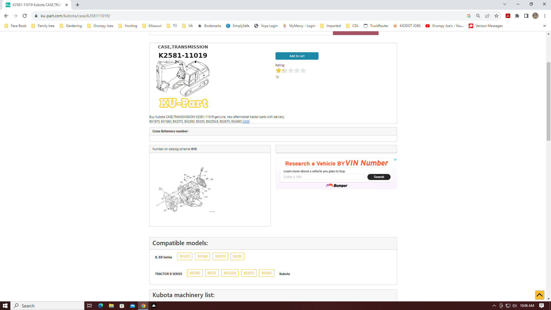

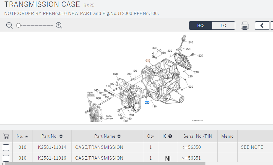

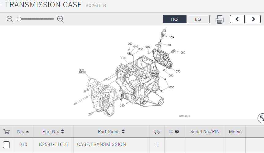

There is a reason for the case to have more than double the cost. Here it shows the application for each case. The upgraded case is priced at $1450 where the standard case is at $550. Do you seriously think there is little difference between the two? It is the reason I chose the LBH model. Parts for the engine are based on serial number but the model "BX25DLB" and serial#376501 only tells the model and series of the tractor. Parts for all but the engine are by model as tin and plastic parts vary by model.
View attachment 113431 View attachment 113432
I don't know where your getting the serial number from because that isn't it, Kubota serial numbers are only 5 digits not 6?
The parts for the entire tractor are most definitely based on the tractors serial number!
I also don't know where your getting your prices from as I listed both cases from the most common supplier of parts and they do not show a $500 difference in the 2 cases????
I listed the parts prints for both and they look the same to me.

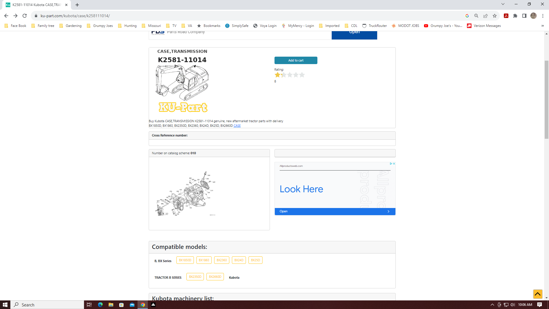

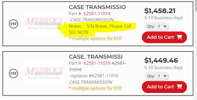

Lets just argue because we think we are better. Most of this post was done on my phone. THere are typos li serial number. drop the "0" and that is the serial number. The company that gave me a quote on K2581-11014 read this post and told me about my typos and that he was offering a used case. He left that out of our talk. What is the point of this post is the dealer repaired the transmission twice and twice the result was loose parts and continued problems. THe first with loose bolts and leaks the second also loose bolts but the transmission siezed. Why they used the wrong parts or even if they used new parts can never be proven as the copies of the billing sent to me from the insurance group KTAC show different part numbers and prices. Both also include repairs not specified.

Despite Coyote Karen in the end it seems to be working out well. I took the tractor to the parent shop with more mechanics than employees at the first shop. The first shop drained the oil and claimed the failure was a wear issue as there was brass in the oil. Before going 95 miles out of my way I checked out the damage externally. All 5 shafts turn freely, input both axles and both PTOs. When the Differential Lock is engaged in 2 of the 4 possible lock positions the axles freeze and the other 2 will not engage. I pulled the magnetic filter out to look for metal shavings. Nope brass is not metalic. I did fing a lot of metal on the screen.
When I explained this to the shop manager he agreed there was something more than a worn part causing the failure, The mechanic started tear down Friday at 9AM and by 5PM they still were not ready to talk about the failure. I take this as a good sign. I am sure the mess inside was pretty bad and more than what a 1 hour of use would cause without help. Bad news is most likely there is another complete rebuild coming and I will be without a tractor for a while. 2 months is a long time not to have a tractor with 11 acres. Things are really getting ugly but cool weather slows the growth down too.
As for the wrong case. My model has only has one case left to use due to the change in inventory. Early on there were 2 options and yes the serial number determined which case was used, but when the old case ran out all went to the newer model. Using current application charts and current knowledge of what your tractor needs is more important than having a history of old drawings. Messicks keeps current on most parts and the application drawings. Best part is Messicks is almost a one stop shopping location for most tractors. Everything I have on my farm they carry replacement parts or refer me to great independant dealers to help out.
