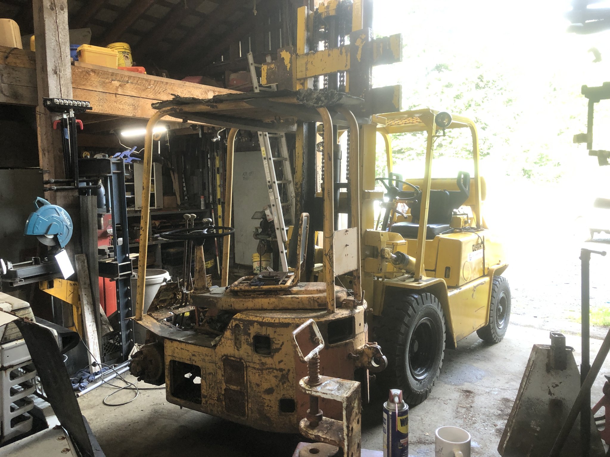

The victim with the boom already removed:

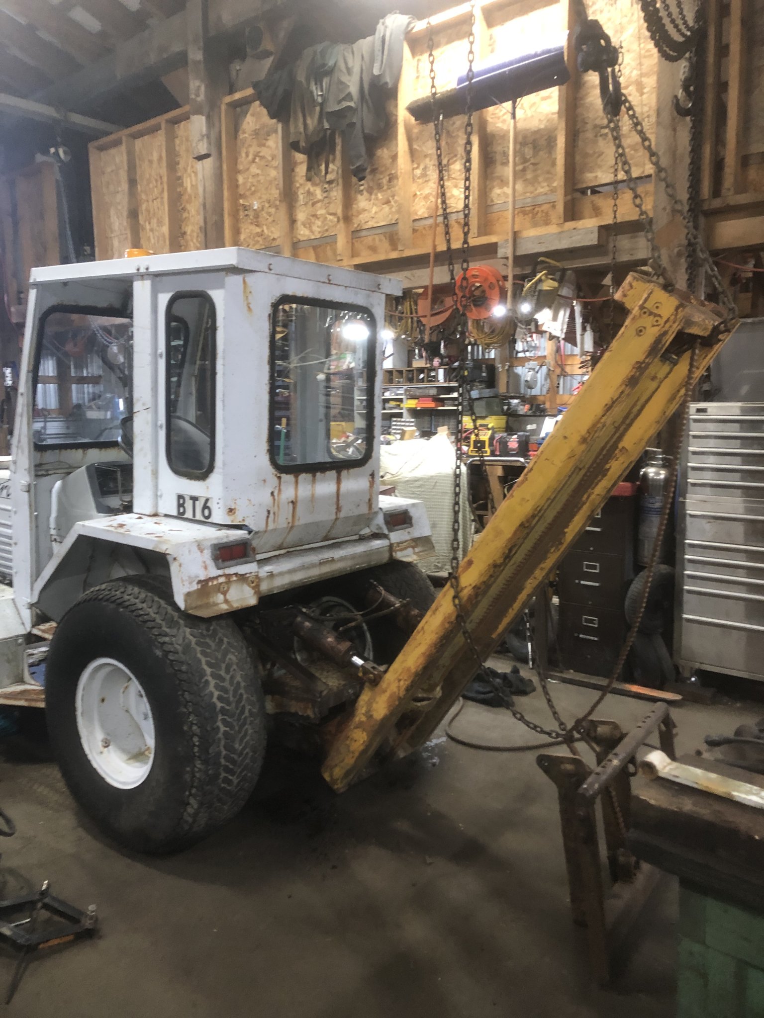

in the bottom right you can see the solid steel plate that that the kubota came with bolted to the rear. It was extremely heavy.

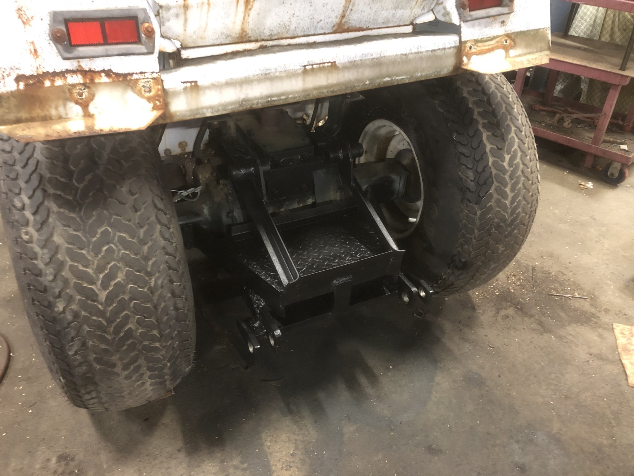

Picture of the painted frame. I tried my best to grab every threaded bolt hole I could find. on the top I got all 6 rearward facing holes and 2 on each side of the differential, just below the cover plate.
