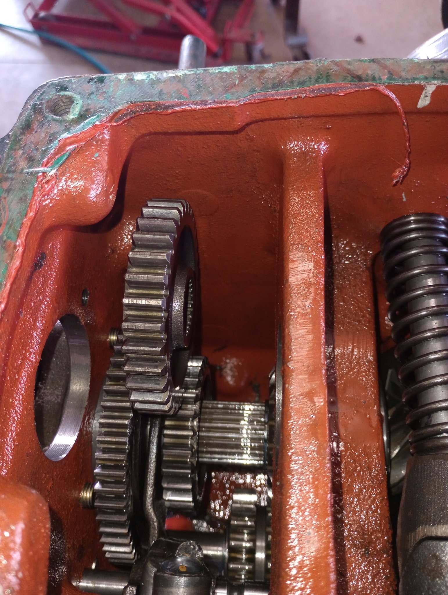

It's a real tight spring!
A real bugga to install 🤯
This might help 🤷 [ATTACH said:
93333[/ATTACH]
Sorry this is the only pic I have with the shaft, not showing the other end.
There is not much involved with it.
Only thing I could suggest is remove the plug & try to centre the shaft with a screwdriver.
