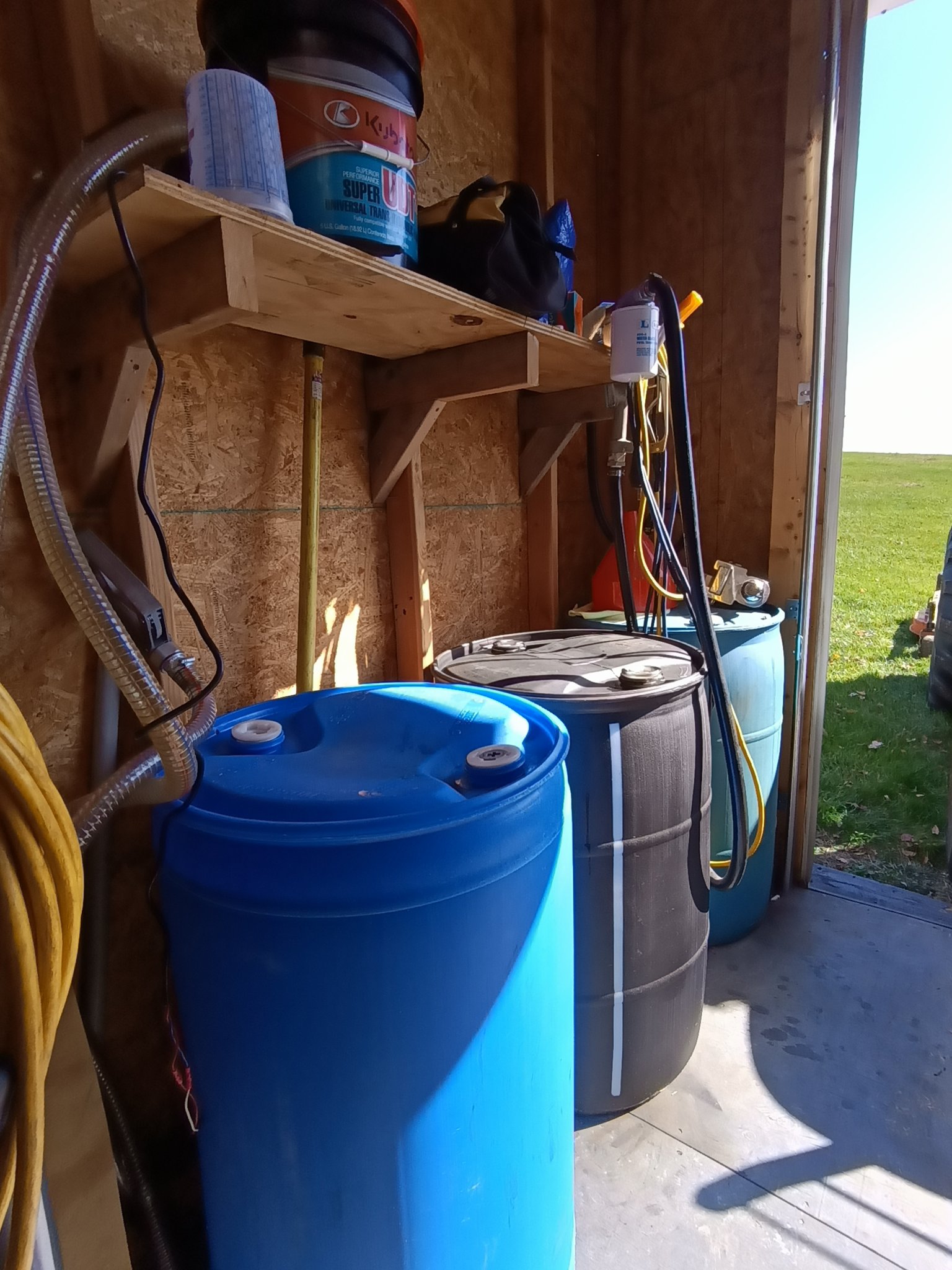

Used, cleaned, cheap plastic drums available locally. HF 12V pump with "flat two" trailer plug, since fiddling with battery clamps isn't appealing. Each piece of equipment has mating connector. Fuel supplier delivers ORD in quantities of 100 gallons or more. The hose is long enough to fill equipment outside the door.

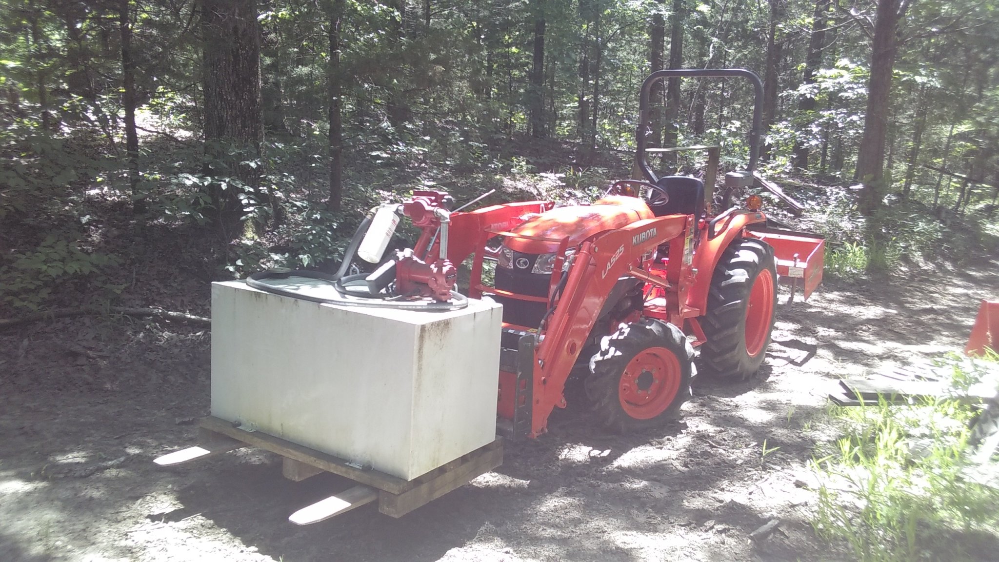

I have Delta 96 gallon tank that I bought at Rural King in 2015 and haven't had any problems with it. I built a skid for and put it in the back out my pickup to fill. Strap it down to keep it from killing anyone. Put a Fill-Rite pump with filter and meter. I used Anderson SB-50 connectors, one on the tractor and one on the pump. Ran fused power to the connector on the tractor. Pull up next to the tank, plug the pump into the tractor and fill it up.

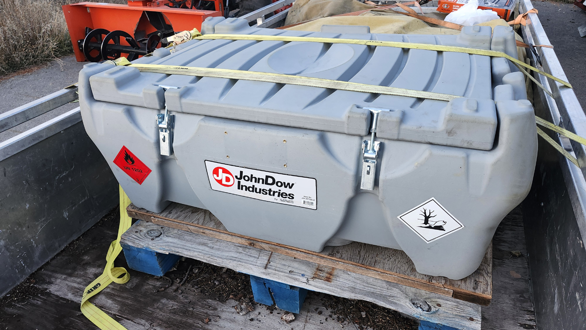

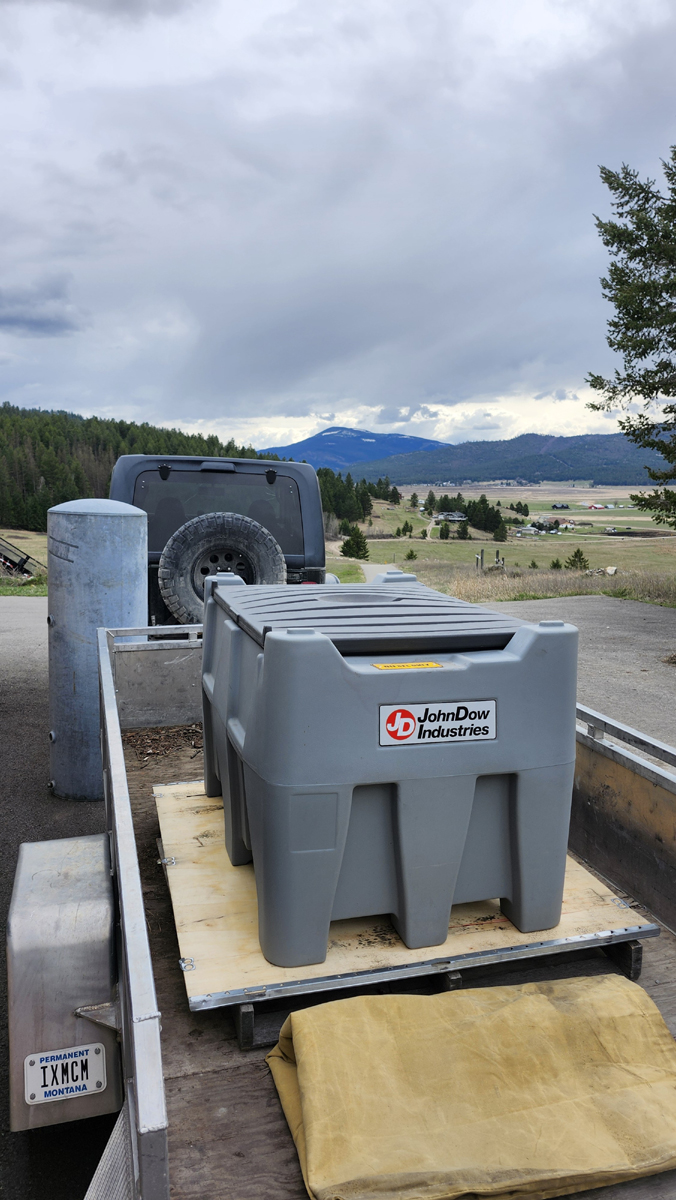

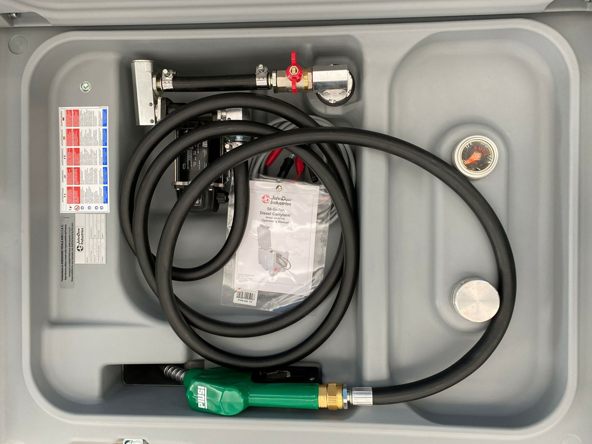

I bought a JohnDow JDI-AFT106 (106 gallon) fuel tank about four years ago and based on my experience with that system bought another JohnDow JDI-AFT58LP (58 gallon) fuel tank about 18 months ago. The 106 gallon tank has a provision for a separate DEF tank but I doubt that's in my future. JohnDow systems use very nice, good quality hardware, fittings, pumps, etc., and the same isn't true for the Chinese knockoffs such as systems from VEVOR and similar. On the upside for most of us, we're not filling up every day, 260 work days a year, so how good does this stuff have to be? Probably not that good to be a significant upgrade over 5 gallon containers.
Every gas station around here has off-road diesel and three types of on-road diesel (in the winter months). As for water in the fuel, I've never had that issue in close to 25 years of owning and operating diesel equipment. I guess I'm just lucky.
When I think about how much money I've spent on diesel over the years, and continue to spend, the cost of a decent fuel storage/dispensing system pales in comparison. The cost to fill up that 106 gallon JohnDow storage tank is about 1/3 the cost to buy that tank. I like nice, purpose built things and not cobbled together stuff. Some like putting time and effort into making something from nothing and I get that. I do that all the time, mostly with steel, and particularly when good options are few and far between, but that's simply not the case for fuel storage and dispensing. There are numerous decent to excellent turnkey systems available.

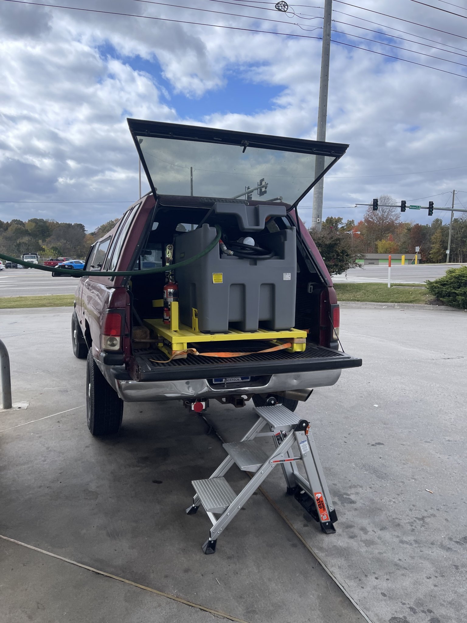

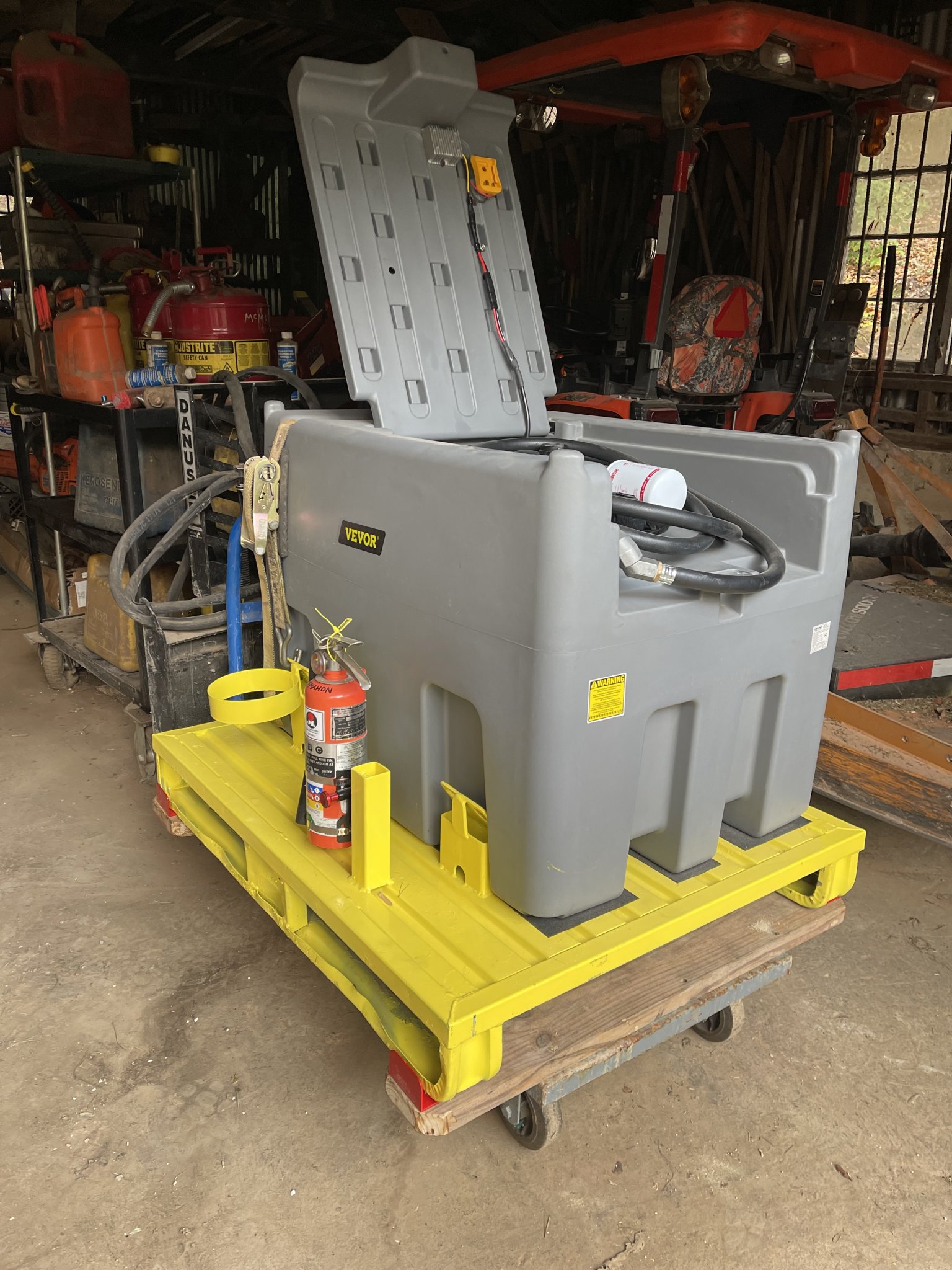

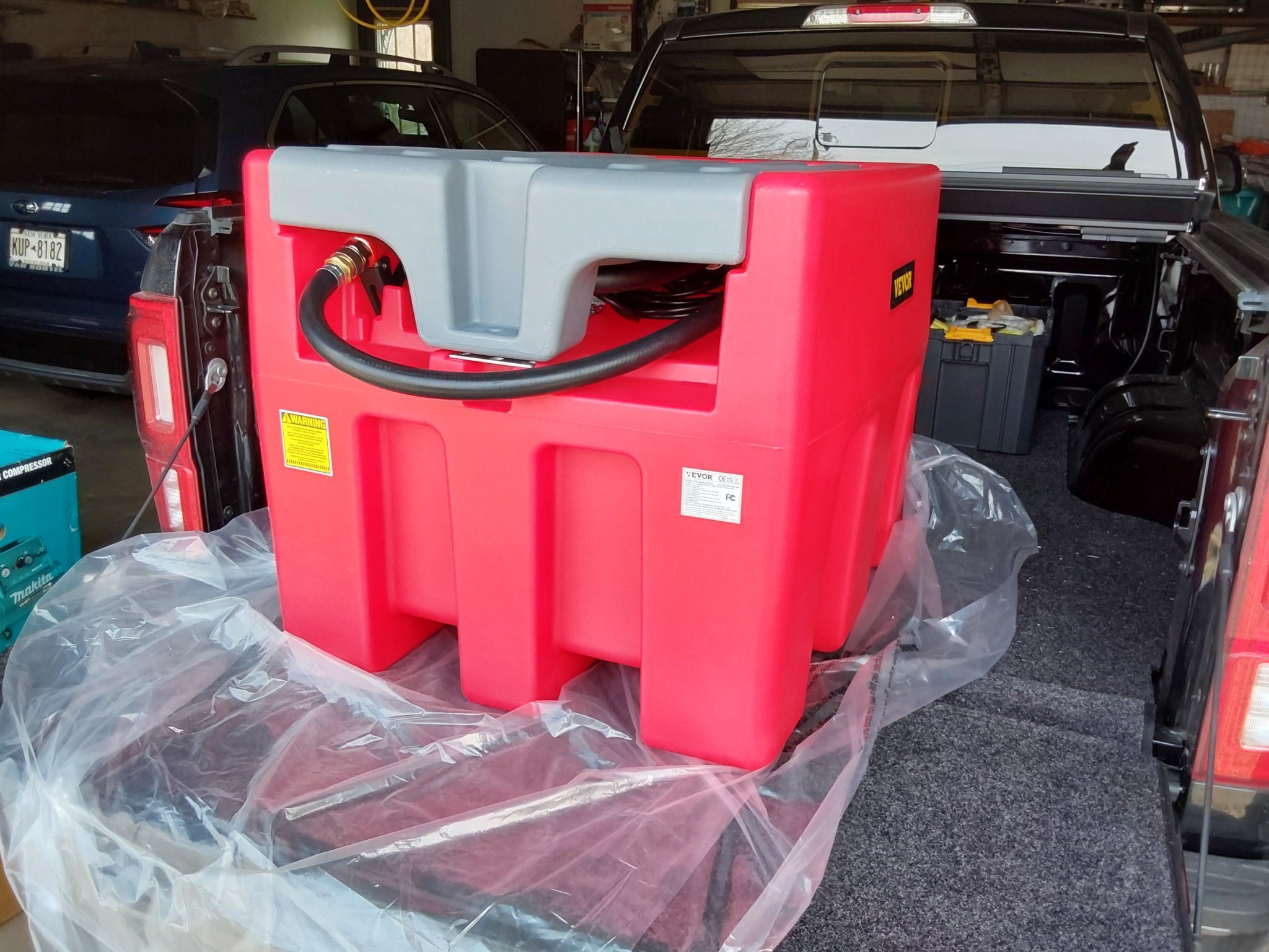

Set up Vevor 116gallon tank last year. Modified to work either 20v Dewalt battery or 12v clips. One 5amp Dewalt battery could dispense full tank. Have used about 60 gallons so far and appreciate not using 5gallon cans.
Metal pallet helps moving. Dolly allows moving in cramp tractor shed. Filter for particulates and water absorption polishes the fuel.
I have pallet envy! Seriously! I could use 20 of those things, but in Kubota orange!! 😂
And your battery system is slick. Could you provide some details on how you accomplished that? I have a spare car battery that I leave on a trickle charger, and have the option to connect to tractor, truck or Jeep batteries, but using a DeWalt 18V or 20V battery seems very convenient.
