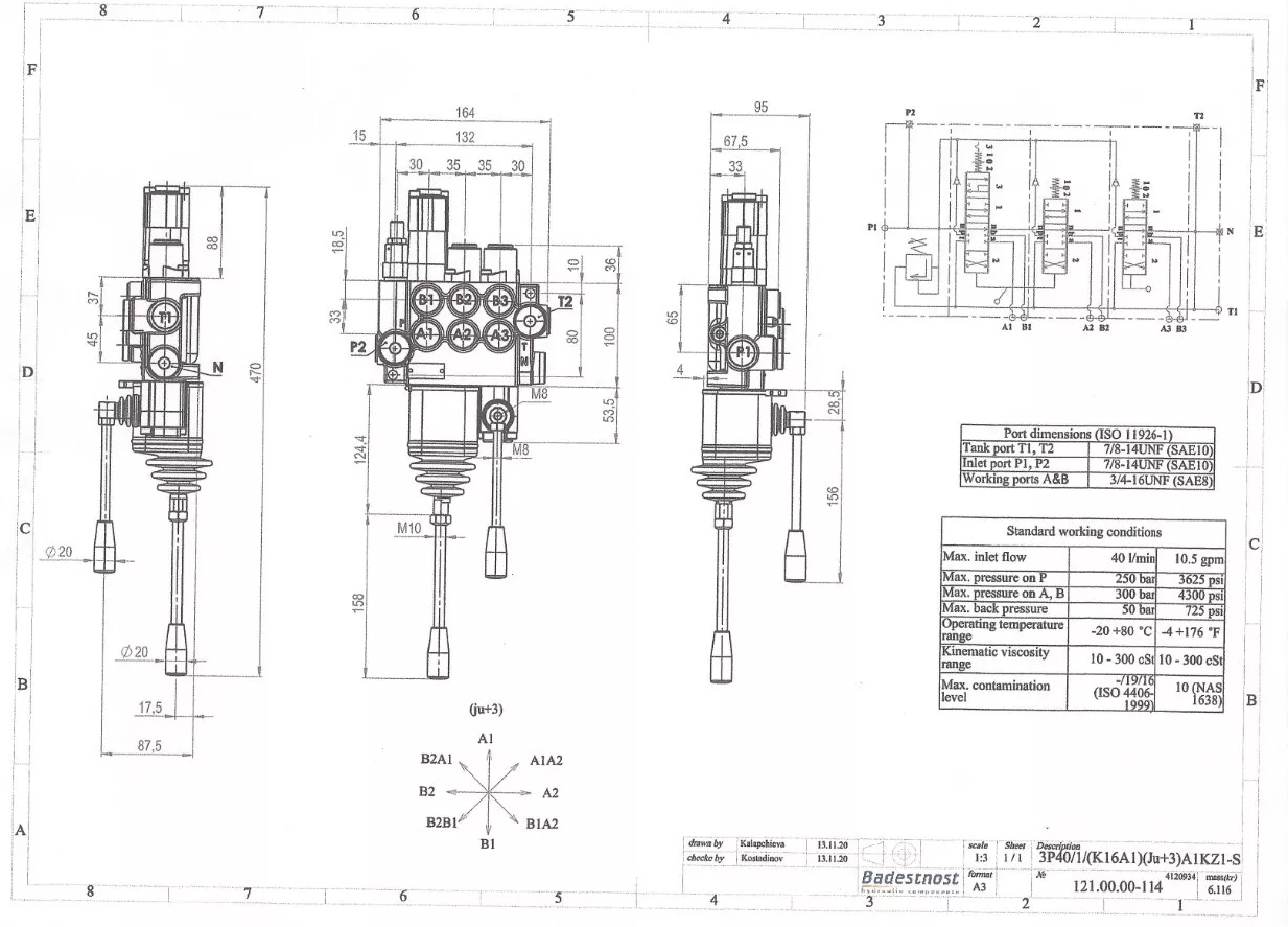

*ETA* It looks like Chief is just re-branded Badestnost valves which are the same ones available from Hydraulics-Master.com. This is a brand manufactured in Belarus and sold out of Poland. Does anyone know what the quality is like?

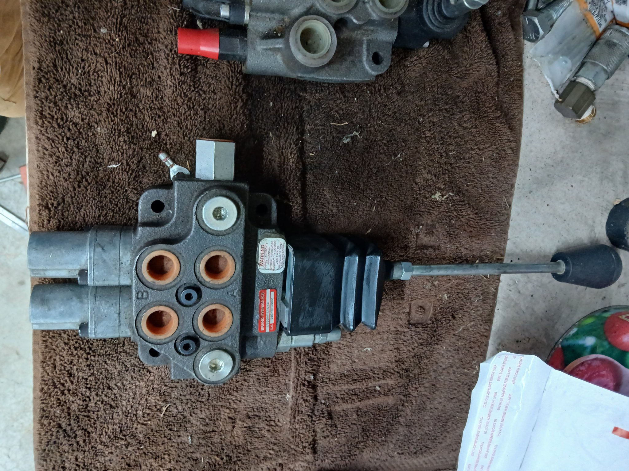

![s-l1600.jpg s-l1600.jpg](https://www.orangetractortalks.com/forums/data/attachments/133/133309-58d6b681c31c9f21ba4558113eee802b.jpg)

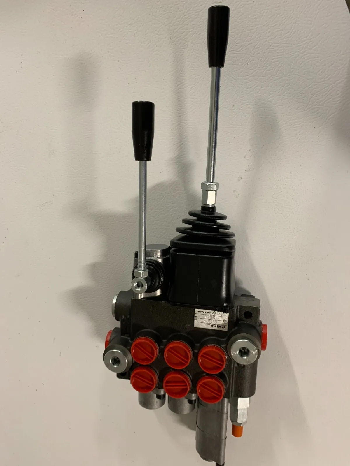

![s-l1600-2.jpg s-l1600-2.jpg](https://www.orangetractortalks.com/forums/data/attachments/133/133310-02136fb48cb0ac8089cc319b448ea0d6.jpg)
