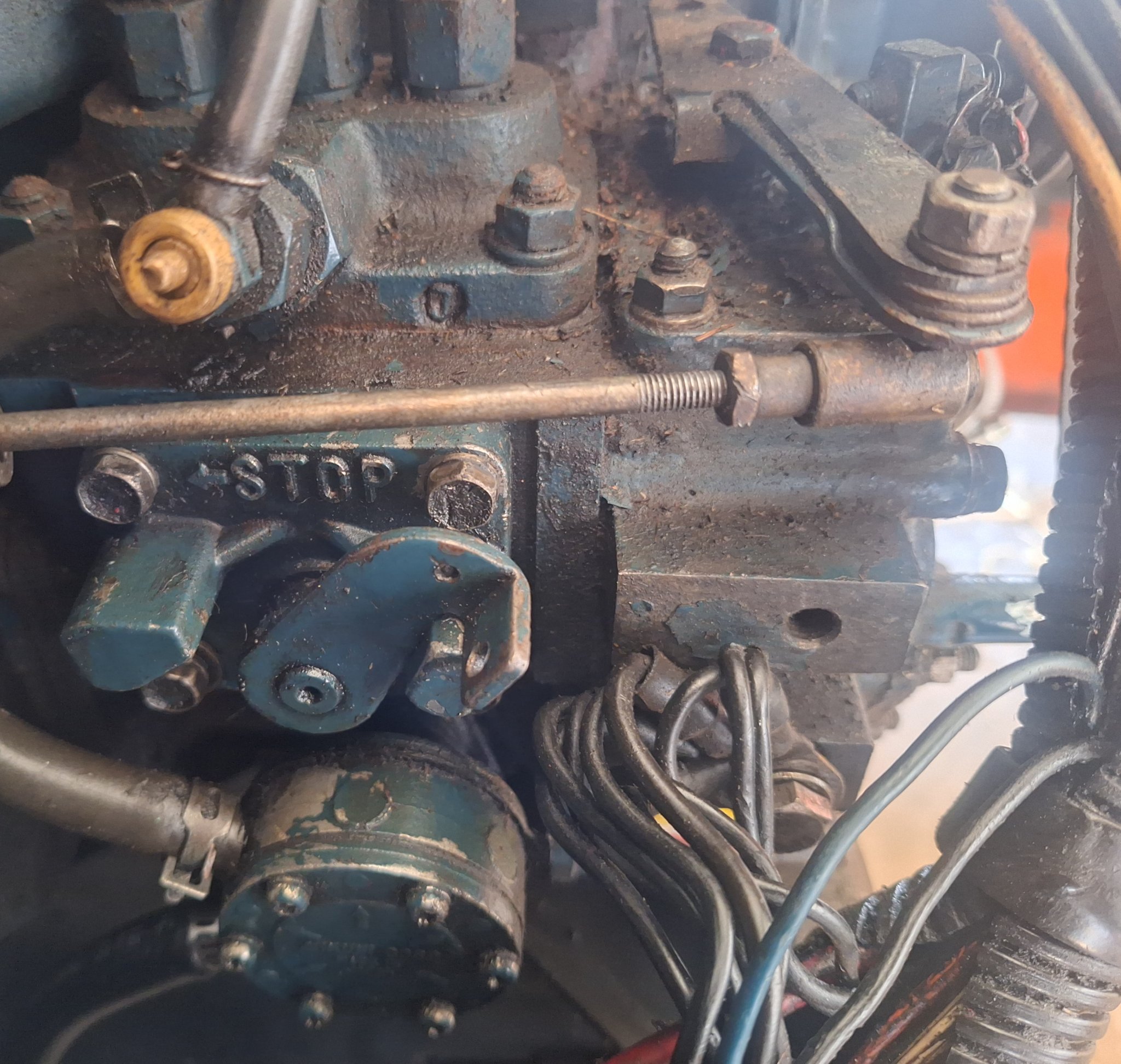

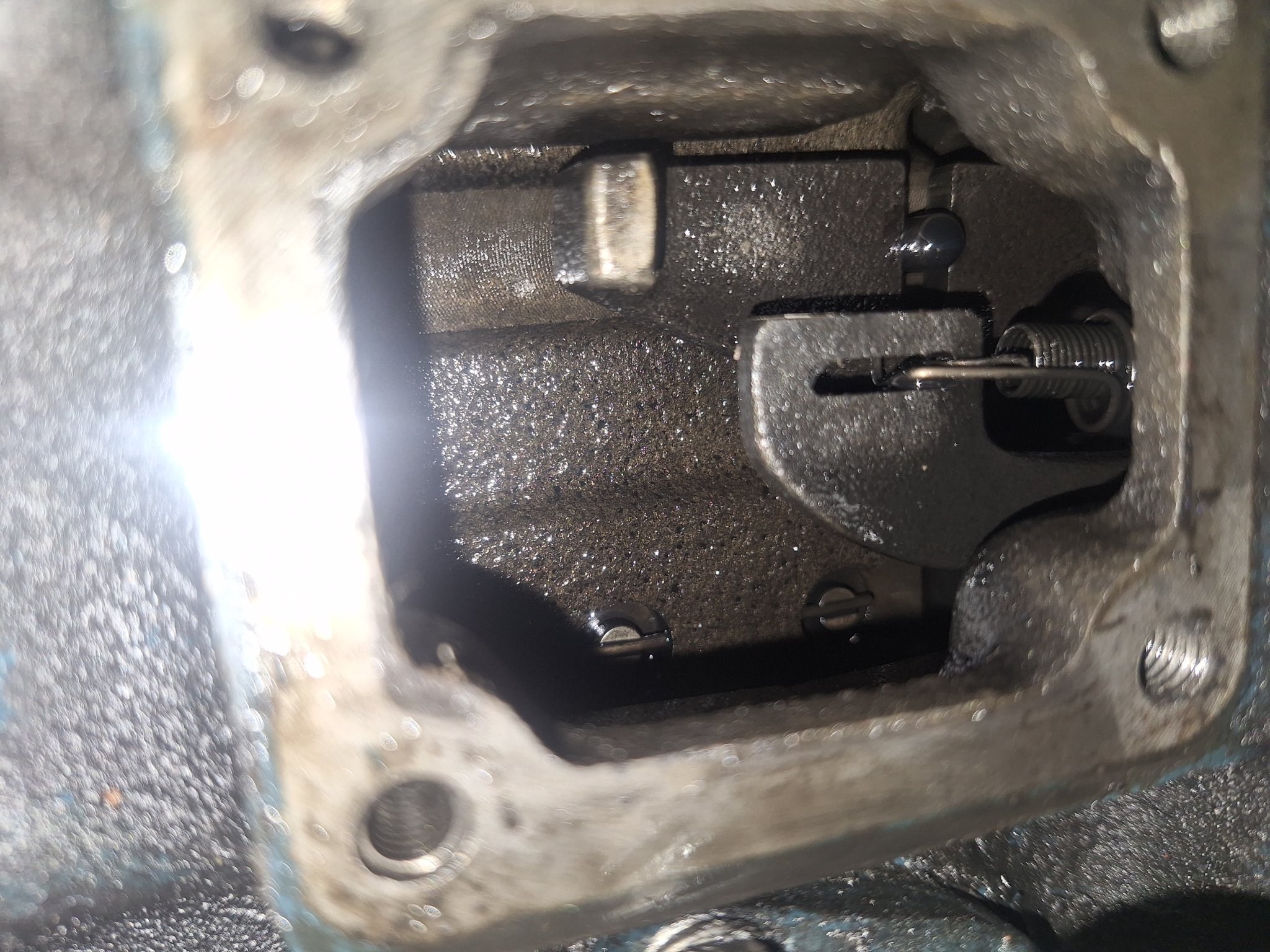

hey, sorry only getting bk now,
So just a reminder my issue is, fuel coming to the pump but not through the pump to the injectors...its almost like the fuel shut off is engaged.
I've uploaded photos of the fuel shut off above and opened it up.
It moves as it should, if I slide it forward with my finger when I let go it springs back, so I can't see any issue there with that,
Secondly the throttle lever ontop I can pull it forward and when I let go it springs back so feels normal.
What could be going on here? What else could it be??

View attachment 152506 View attachment 152507 View attachment 152508 hey, sorry only getting bk now,

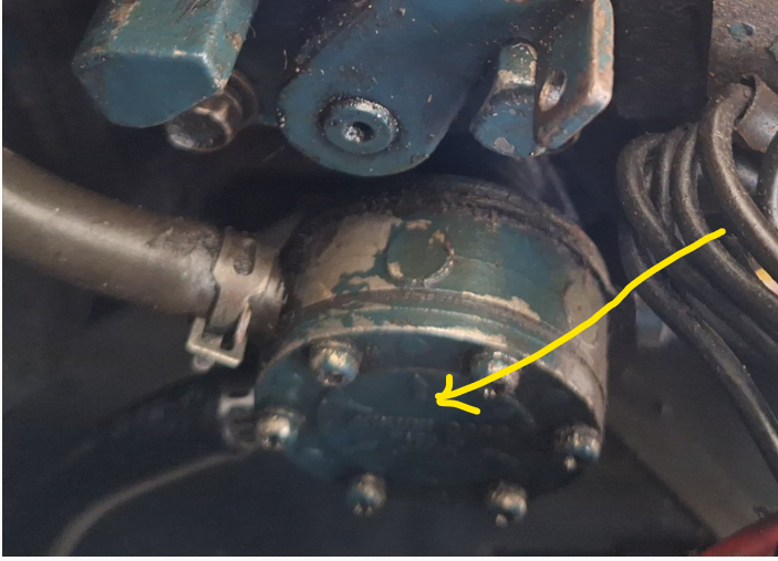

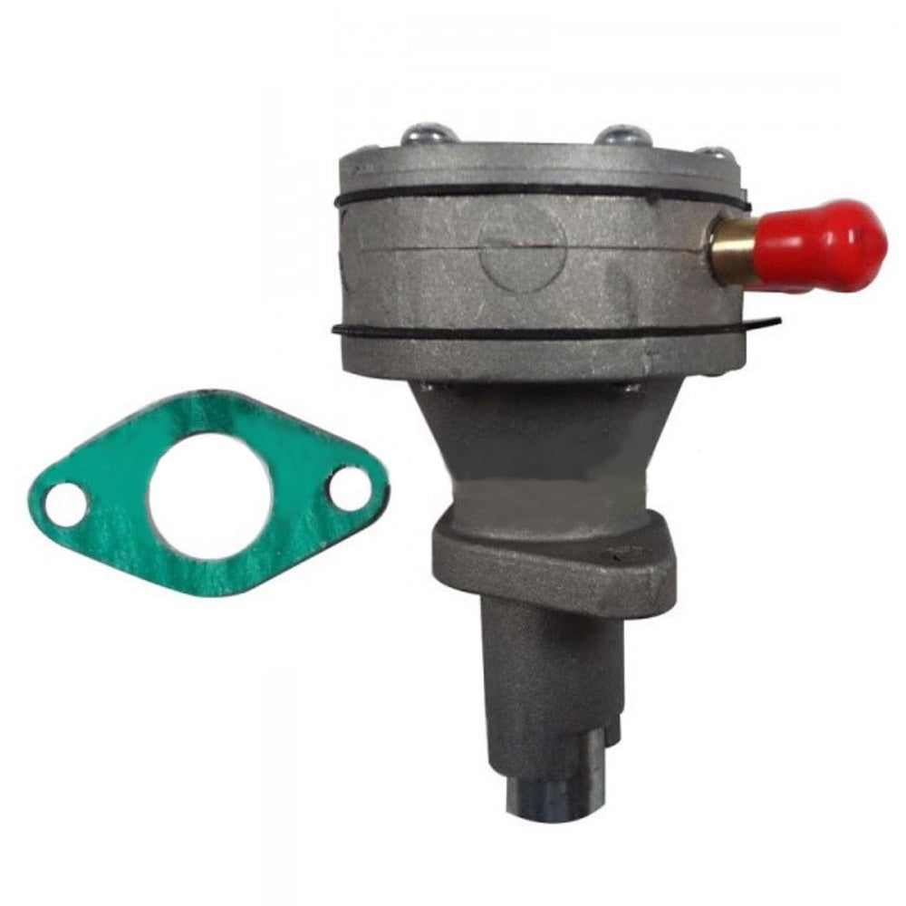

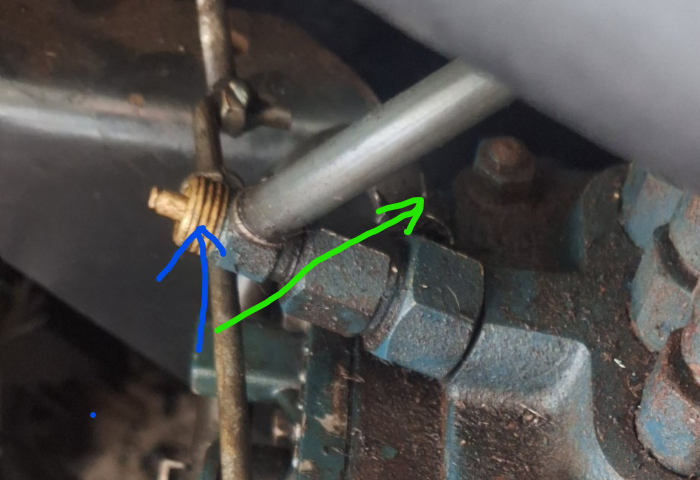

Common failure point on these engine is the lift pump (yellow) which when bad, will not push fuel up to the injection pump.
Bobcat and other units like this also tend to have problems with fuel pickup in the tank.
Pull the fuel line off the side of the injection pump (green) and crank it and see if you get pulses of fuel.
If you don't get pulses of fuel go down to the lift pump and see if you have fuel going to the lift pump.
if you don't then you will need to chase the fuel line back to the tank and maybe into the tank.
The valve above (blue) is the jet start valve, it bleeds air out of the line going to the injection pump, below is a new one, and only lightly tighten the wheel, common issue is they get over tightened and break the wheel off.
If you do need to replace the lift pump, below and you get it and the clocking (direction of in and out) on the pump is not the same, that is easily changed.

Hey thanks for the reply,
It's not the lift pump plenty of diesel coming to the injector pump, yes the wheel broke on the jet valve but I can still open and close it so the fuel has been bled to here,
For some reason it's not pumping through the pump? The stopper is sliding back normally, can the pump just fail like that? Doesn't seem logical but I'm all out of ideas

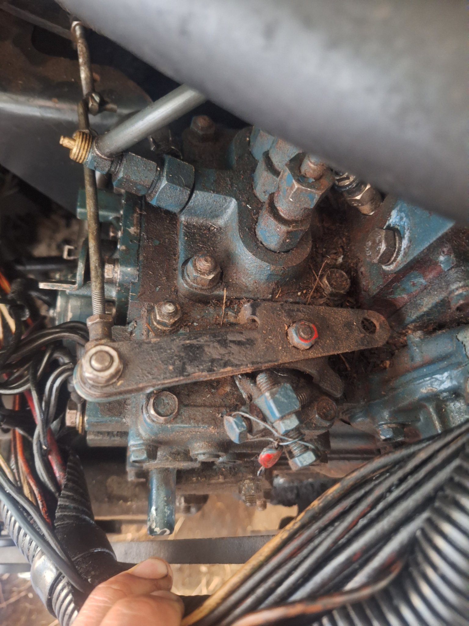

No the injection pumps don't just fail.
You say that you have fuel to the injection pump, how do you know that?
It doesn't look like any fuel line or injector line has been removed from the input or output of the pump.
Take the injector lines off the top of the pump, and crank it, you should be getting about 2" fountains out of the delivery pumps.

chriscorr
Kubota D950 engine - bobcat 553
Dec 20, 2024
Ireland
The red circle is the indeed pipe to thr injector..the other pipe is the return....when I first got this engine last year, I waa able test the engine by running fuel direct to the injector pump that I've circled and if cranked it will start.
Not in the picture above but I've got fuel plugged direct to the pump so there is 100% fuel at the pump.
With the injectors of there's nothing coming out, just a tiny dribble.
I cant understand why it's not coming through properly
