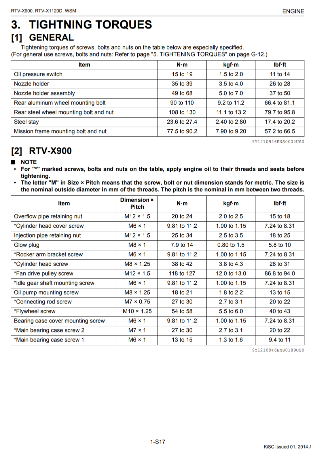

I have what appears to be a 2018 RTV X900 with the D902 engine. Can't seem to find accurate torque specs for rod and head bolts. Also can't seem to find an E4 specific repair manual. Does anyone know if the torque specs on the D902 are the same regardless if it's an e2 or e4?

The engine manual is in the WSM.

Thanks for the help. I've never owned or worked on a kabota before. I hope you'll excuse my ignorance, but what is the WSM?

But in the KUBOTA world, WSM = Work Shop Manual = Service Manual ;)
