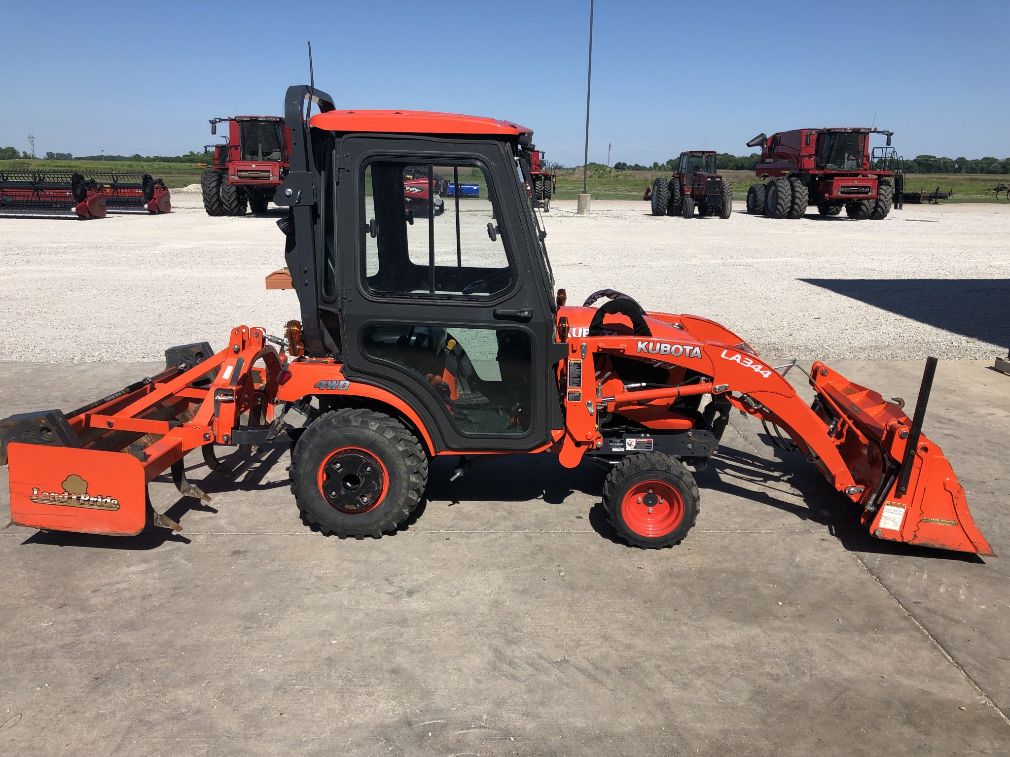

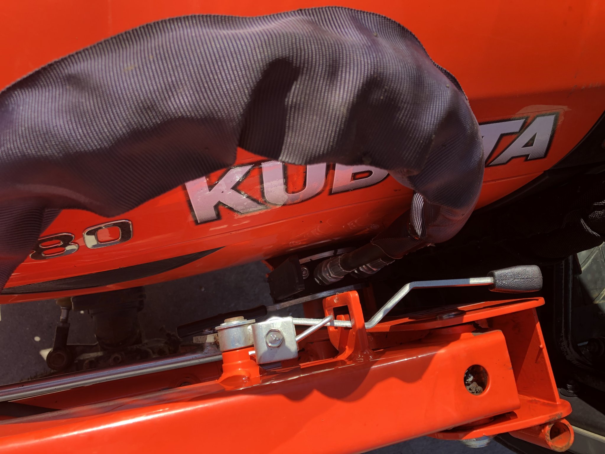

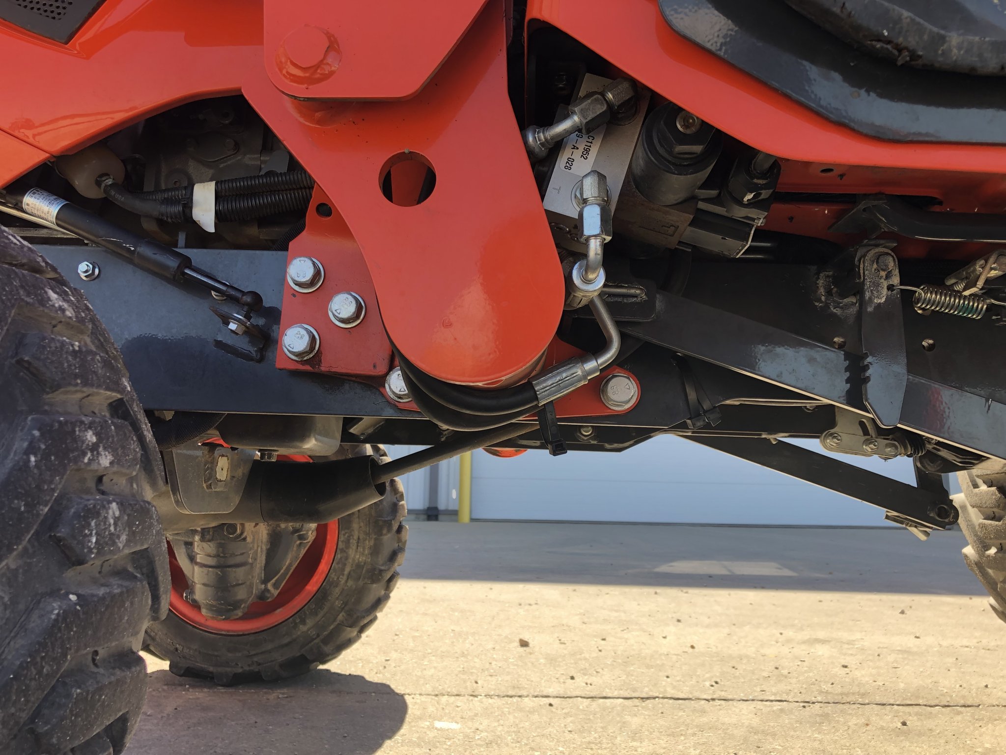

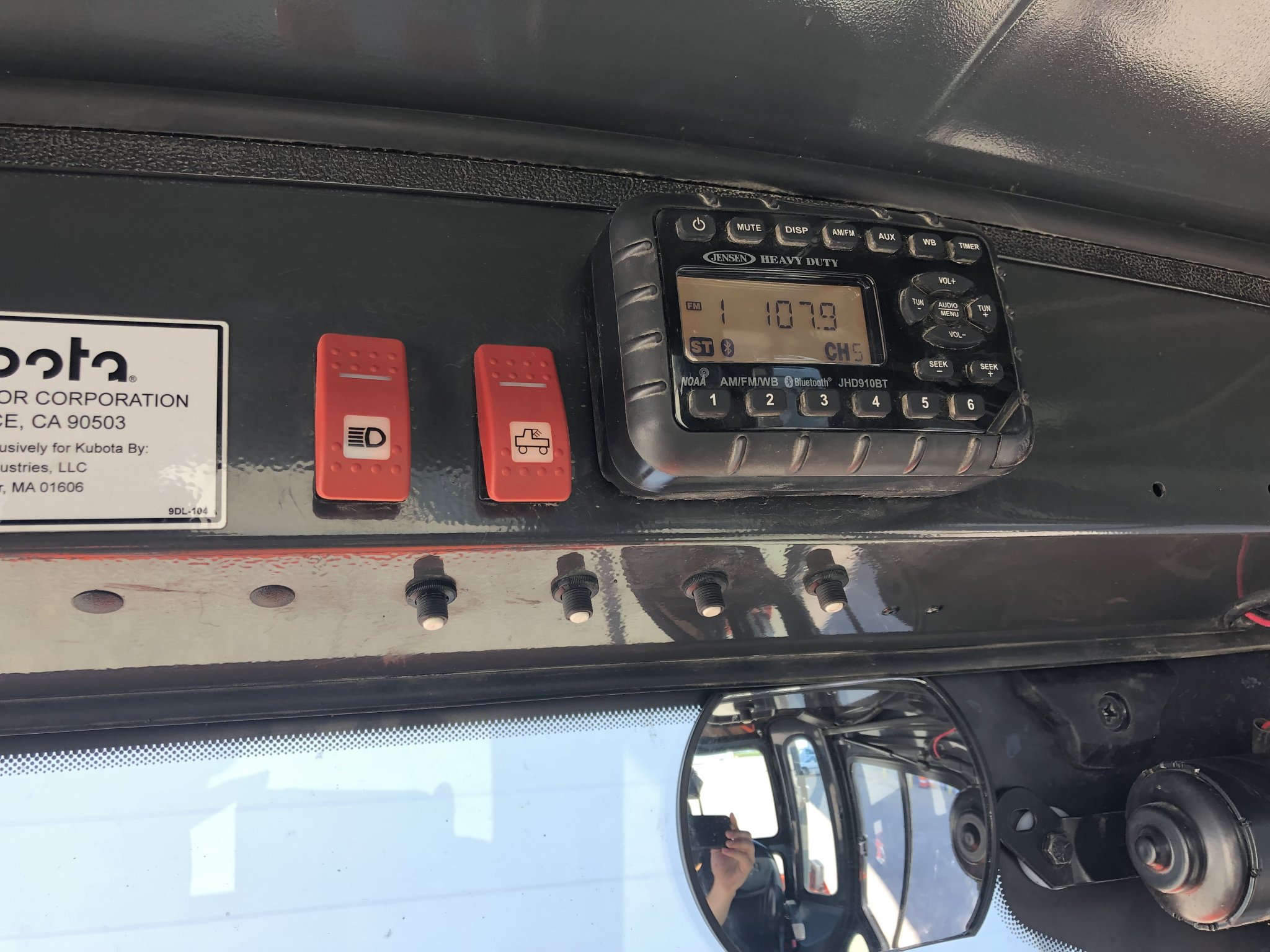

So most of the custom work I did on the tractor was to add a true 3rd function to the tractor (not a diverter style) and to modify the Land Pride CB0550 50" combination bucket to go on the new swift-tach loader (it was designed for the BX70 series tractor). We wanted to keep the swift-tach loader functionality so I had to fabricate a single lever coupler for the two additional hydraulic lines and installed that on the left side of the tractor, opposite of the standard 4 line connection block. I also added a bluetooth radio and speakers to the cab and steel wheel weights (no cheap plastic would do). So all in all I am pretty sure this is the nicest BX2680 that exists. I probably spent a total of 60 or more hours working on this tractor.
It is a 2017 model BX2680 with a LA344 loader, true third function, level indicator rod, Land Pride CB0550 combination bucket, BX4070 Cab with heat & seal kit, front and rear LED lights, front and rear wipers, radio, two rear remotes, Land Pride QH05 quick hitch, and steel wheel weights. Currently has 642 hours on the meter.
