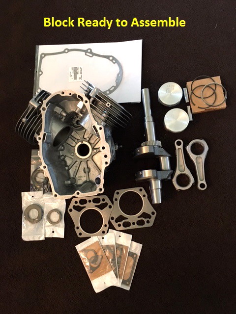

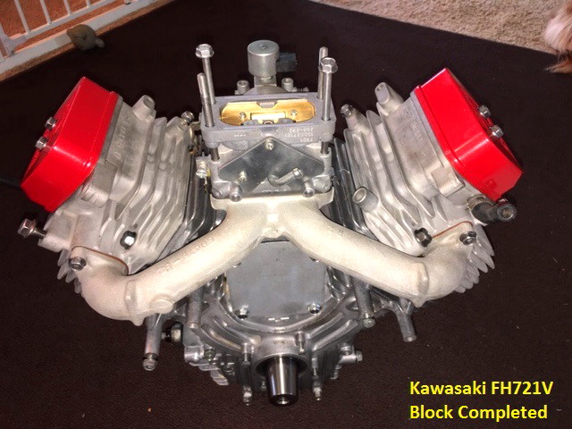

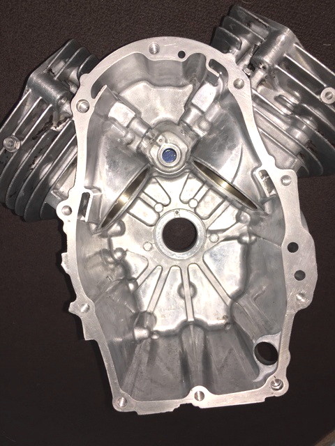

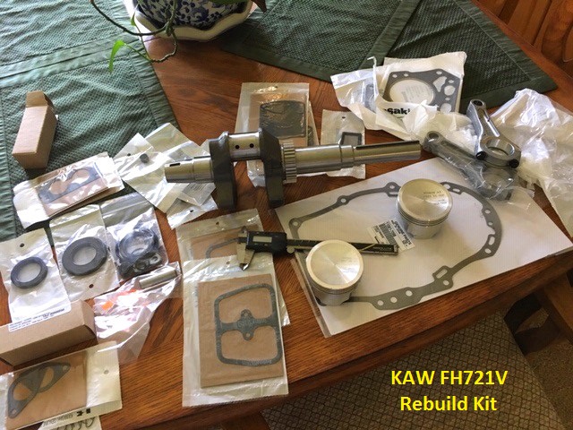

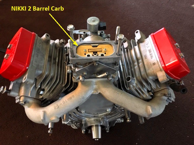

Rebuilt my well used FH 721 Kawasaki. Had it bored .020 over and then I reassembled with new crank, rods, upper and lower crank bushings, new pistons and rings. Lapped the valves and installed new springs, push rods and valve stem seals.
Too hot down in my shop....so reassembled on a rug on the dining room floor. Wife unit didn't like that much. But she'll get over it.
View attachment 138214 View attachment 138215 View attachment 138216
