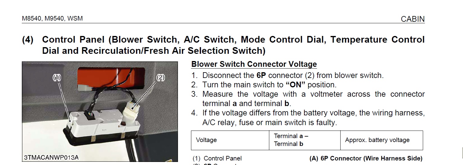

Look at the following taken from the WSM. This may be the w=switch you are talking about as a guess.
It looks like the switch assembly just pries out.
