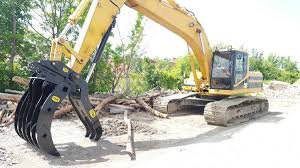

I have 50+ acres that I will be partially clearing with a L6060, a KX033 mini-ex with a ripping tooth, and a 1 ton dump truck (GMC 3500 HD diesel). Mostly hardwoods and generally sloped land, steep in spots. Plan on clearing 2-5 acres for house, farm, septic, PV panels, etc. The mini-ex is great for picking up logs and loading them into truck for later processing.
I like Homestead Implements and am contemplating getting a box blade for leveling and thought about their heavy duty grapple. The grapple goes for about $4000. For those that have cleared land before, is the extra $4000 for the grapple worth it in efficiency and time savings over just sticking with the mini-ex? I will have plenty of brush to clear and chip as well as firewood to process. I'm in NH, the Granite State, so rumor has it there will be a "few" rocks/boulders to contend with. I have a 3rd function kit installed.
As always, appreciate all comments, suggestions. Best to all.

I read Gaspasser's post as asking about implements , especially grapples. I take it he has decided to take on this work with the equipment he already owns.
I think a grapple, can not speak directly to the 4K Homestead , is an invaluable tool/implement for the work you described and the work maintaining 50+ acres going forward! There will be times that your on your L6060 doing 3pt work and a grapple will come in handy without the need to head back to the "shed" and climb on your KX033 mini-ex.
The fact you already have the 3rd function kit installed seems to me a easy decision to make , adding a grapple.

Depending on what you are doing with your acreage, I think it would be pretty easy to find regular use for a grapple. I don’t think they are as versatile as forks, but for their purpose they are pretty helpful. I think if you had a grapple it would be real easy to deal with the trees logs left after have something come in to clear the place. (If you are going to clear that much with your L I’d definitely want the help of a grapple). Afterwards, if you have that much acreage there will be trees down often enough I think you might find a grapple handy regardless.
if doing yourself, I guess I would also wonder would a skidding plate/winch be helpful? I guess I would also have to think about a grapple on front or one on the rear that has swivel function to it. Sort of depends on how you want do the job I guess and process/pile the logs up. Either way I’d want something to help grab and transfer/move the logs brush etc. just my opinion.

FEL grapple is the most used implement on our hillside farm. Invest in a good one.
The volume and size of my wood debris makes tractor size chipper impractical. Have an accessible gulley that eats house size piles of trees, stump and brush. Easier and safer than burning. It amazes me how fast it rots away. Black top soil deposited 700’ lower into a small paddock. Have a few piles in the remote fields too for wildlife habitat. County conservationists prefers piles vs burning or chipping. We have so much wildlife it’s like living in a zoo.
