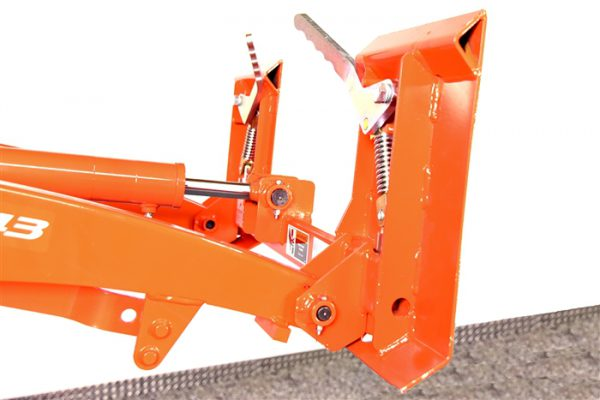

Is it a SSQA bucket or does it mave mounting pins.
I would think it's SSQA.
If it's SSQA, you will just need to make sure the L4060 has SSQA and it will fit.
31,647
7,469
It doesn't look like they ever made the cb1060 in a PIN on version they are all SSQA or as Kubota calls it a Universal Quick-Attach.
So yes it will work as long as the L4060 has The SSQA or the Universal quick attach on the loader.
Old Machinist
May 27, 2024
193
199
NE FL
Your L 4060 will also need the hydraulic capabilities to operate the clamshell.
