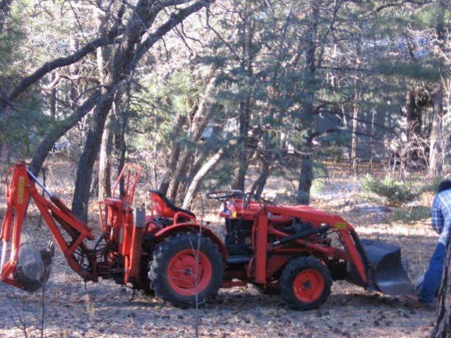

Does anyone know of a bolt-on, non-hydraulic thumb for a B670 Backhoe on a B7100? Seems like it would be a mighty handy item.
