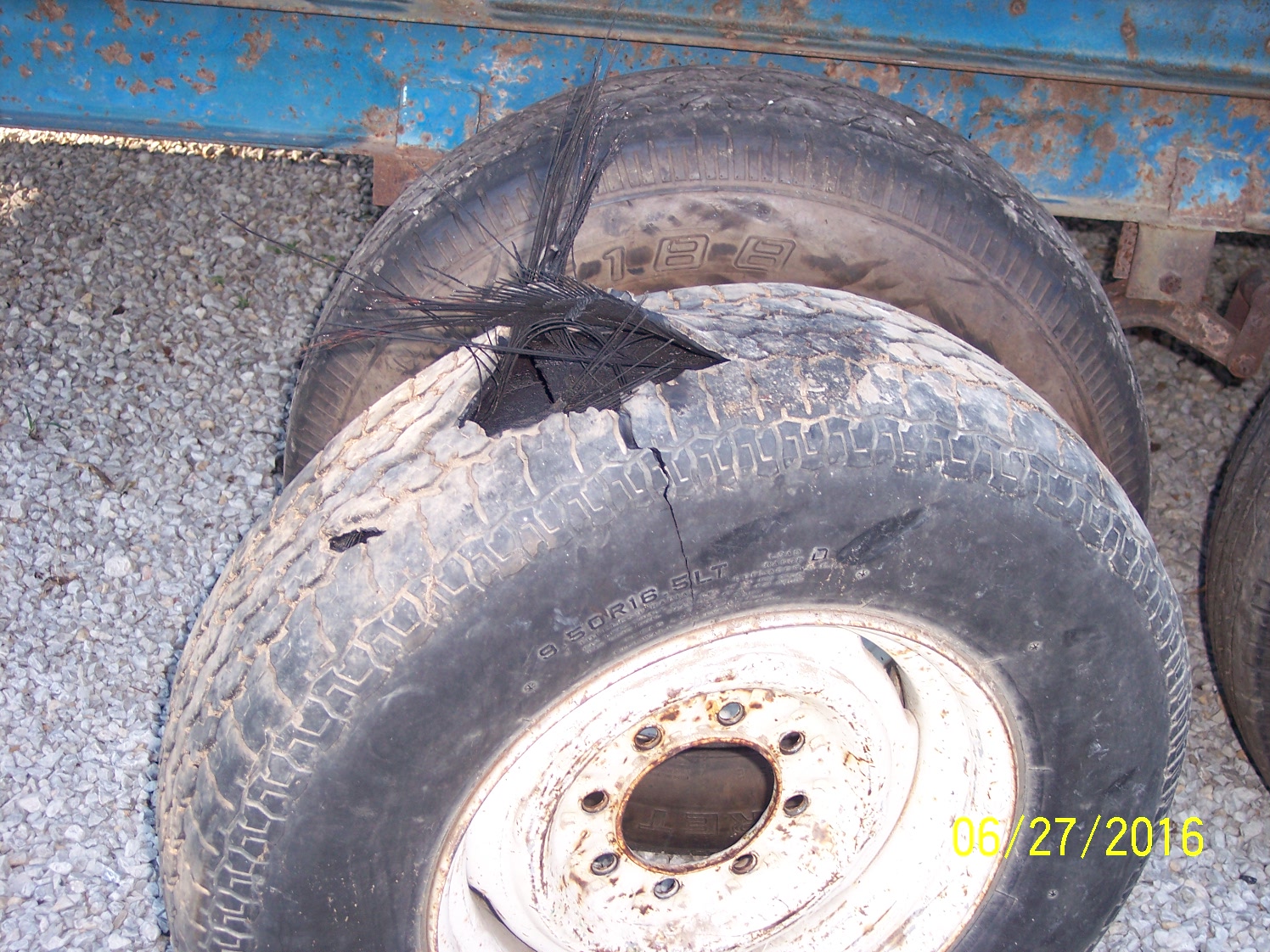

Whenever airing-up a tire… it’s a good idea to keep your head and body away from the tire as much as possible in the event a tire sidewall or belt “blows”. Consider placing the fender between your head and the tire and standing as far from the tire as possible.
When a tire fails…it is explosive…and can be seriously injurious or fatal.

I have a remote air inflater (multi-range, just change out the quick-change dial indicator, certified up to 600 PSI), however as far as I understand, explosion is not much of a concern on tractor or other low-pressure tires. Generally you should hear a "zipper" sound as a dry-rotted or damaged tire starts to pull apart and the cords break/separate, and it's not violent--scary, and you should get far away fast and in-line with the vehicle so the vehicle body shields you from a potential explosion, but generally not violent.
However, over 32 PSI like with the newer 52 PSI vehicle tires, small high-pressure trailer tires, and of course large truck tires with lots of surface area and pressure are dangerous. Tires are designed to not explode, and for the most part deflate slowly (as designed), so generally people are safe inflating tires that haven't sat flat for a while.
That isn't a car tire, but a truck tire. The way that they all moved away from where they were seated, I am inclined to believe that this was a setup to blow the tire apart. I can't believe that anyone is stupid enough to put an air chuck onto a tire valve stem and walk away. Assuming that the compressor tank holds 150 PSI it wouldn't take very long before the tire was inflated to operating condition.
