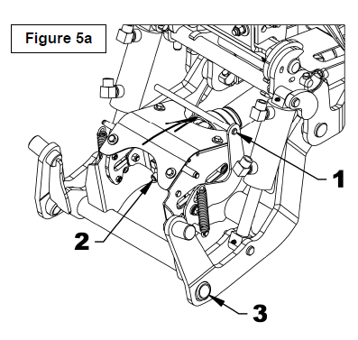

To turn the auger by hand - PTO(Power Take Off) or Tractor not running - push 'engagement Lever(#1 in drawing) away from snowblower(it has a rather stiff spring) towards front of tractor - this disengages the snowblower from tractor mid-PTO.
When done make sure to move engagement lever towards snowblower to re-engage snowblower to tractor mid-pto and turn the auger to make sure the 'dogs'? are re-engaged(can no longer turn the auger by hand.
THANK YOU! I'll go try this out. This is the info I needed. May I ask where this diagram is from? I have the owner's manuals for everything, as well as the shop manuals. But I'm a bit overwhelmed with everything, including figuring out how to even use the tractor. So, I'm just trying to take it a little bit at a time.

The reason that it is in the assembly section is that part is a portion of the LX2940 SUBFRAME & 4-POINT HITCH - the framework behind the snowblower allows for the mounting of the snowblower/snow blade/ and a rotary brush for cleaning snow off surfaces.
After removing the snowblower the subframe is easily removeable also by disconnecting the PTO shaft from the mid-pto disconnecting a couple of hydraulic hoses that go to the lift cylinders on the subframe and removing two pins(rear one first then the front pin) and lifting the front hooks off the mounting frame.
