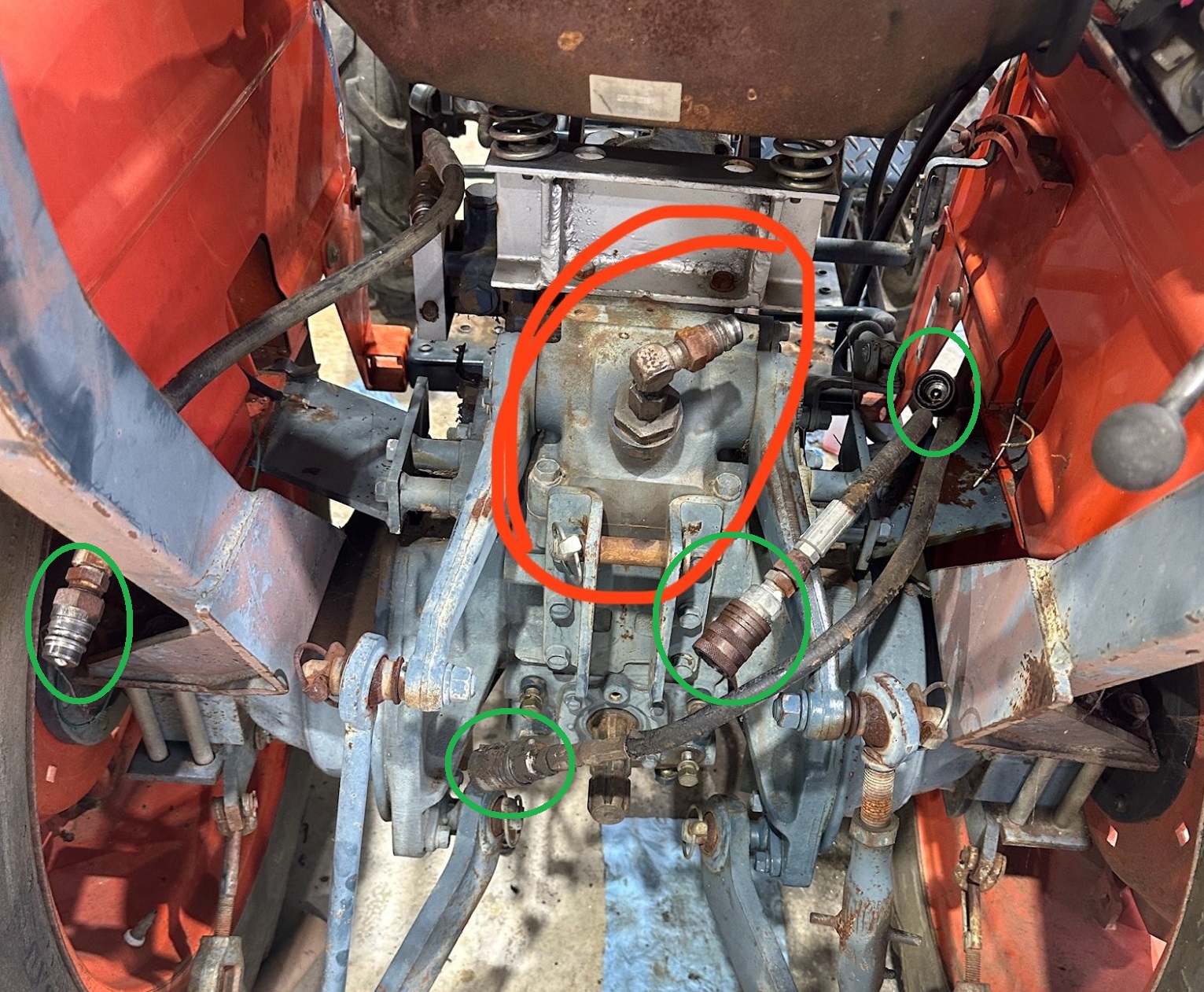

Yep you shouldn't have a problem running it.
You will need to make a loop off of they hydraulic system to a spool valve (hydraulic valve) to run the top cylinder.
I would suggest you add a two spool valve, as they are close in price and gives you options down the road.
Post a picture of the loader outlet block under the front seat.
