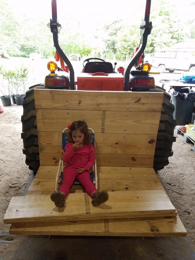

I needed a carry all so I came here and searched threads to get ideas on how I wanted to fabricate mine.
It will serve many purposes, a ballast to carry 5 80# buckets of concrete to offer a little ballast when using FEL. Fire wood, garden supplies, tools, feed, etc.
I plan to add some tool holders later but I want to use it for a while as is to see exactly what and where to attach things.
I know the handles are large but they were free so that is what I used.
The wood cost me a little over $100 and the TSC pallet fork was $129.00, the concrete for the buckets was $20.00, so carry all cost me about $229.00. I had the bolts, nuts, lock washers, flat washers, screws etc. left over from previous projects.
I plan to stain it a shade of orange, it is made of yellow pine, I chose not to use treated as it would shrink and twist while is was drying.
Let me know if anyone has questions or would like dimensions and as I trick it out I will add pics as it progresses.

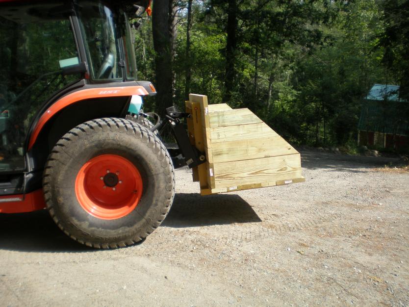

I purchased a County line from TSC and wish I had bought a King Cutter instead. The County line 3-pt. set up is too close to the front of the frame and I had to notch the 2-bys I used so the quick-hitch could hook up and the top link is difficult to attach as you have to slip it up from the under side. I haven't finished it yet, but when I do, I'll add more pics.

Looks like you have some very efficient help painting. Enjoy every minute.

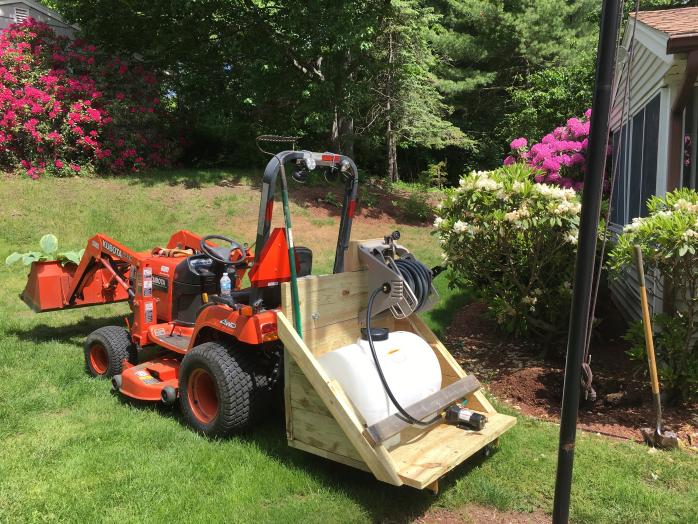

Built mine similar to the rest. I attached a tank for spring planting so I could have water wherever I needed it as we planted out gardens. 12v pump running off an aux source on the BX powered the 5gpm of spray power. Perfect for working around the house where I don't have a hose source easily.
I convert it to a cord wood hauler in about 3-4 minutes come fall.

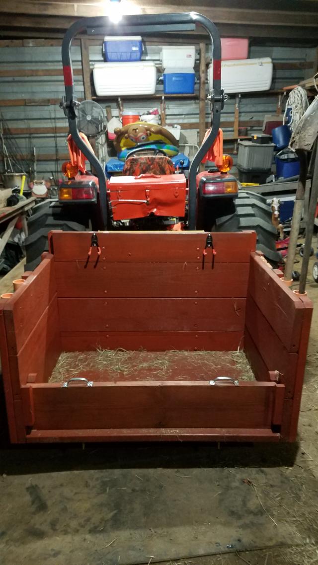

The bottom vertical 2x is screwed to the end of the floor 2x in 3 places and to the vertical 2x at the front. I stacked each and screwed at the front.
Then I counter bored a hole at the bottom of each vertical side board and screwed into the on below with 3" screws.
The 2x running up the outside also help hold them in place.
It is very rigid and has worked out well so far. You can see in earlier pic I moved the tailgate out a little to give more floor space.
Let me know if you have any more questions and I could take some close up pics if need be.
Couple weeks ago I added some weights underneath it. I drilled 2 holes through floor and stacked a 50lb and a 25lb weight on top of each other, then took a bolt, flat and lock washer and secured to floor, adding 150lbs to eat without compromising floor space.
I'll post pic of it over weekend when I put it back on tractor to haul some wood.
