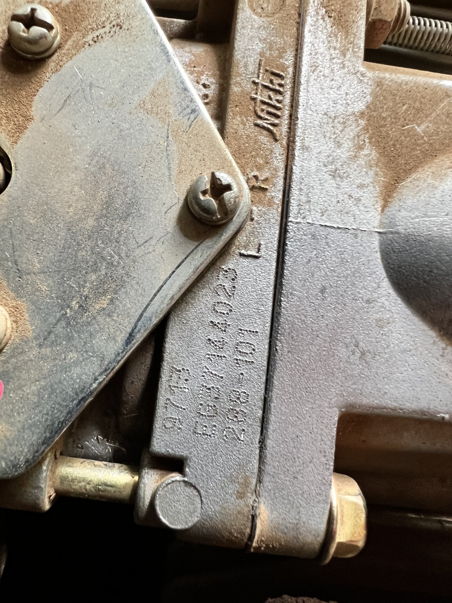

Any suggestions on a replacement carburetor for a ZG327? The one on it now is a Nikki part number on it is EG37144023. Local dealership has one but cost is $700. Hoping to find a less expensive one.

That's probably the KUBOTA part number, what's ON the actual Nikki carb ?
Pictures would help !
Curious what's wrong with the carb , as there are repair/rebuild kits for them $30-$40.

See attached picture. The choke linkage is broken so no way to control the choke.

The choke linkage is broken off the side of it. Can’t control the choke.

So is this unit really from 1997 ?
Would really need to see better overall pictures of the carb. I can't see the broken choke area.
Nikki probably made 100-120 of that style,so once you know the HP and bore sizes, it'll narrow down the search to an economical replacement, Heck you might just need the 'main body'.or fix the 'choke linkage'...
For sure I'd be doing a lot of 'surfing' before I shell out $700 for a $40 carb !
Similar to GeoHorn, I replaced the carb on a Honda 9HP engine with a $20 Chinese clone 15 years ago. Motar mixer is still running fine.
hmm... looked at specs, 26HP, carb looks like what's on a B&S.

he said choke is 'busted' but no pix as to HOW it's 'busted'.........
similar shaped units....need more specs to know if they'd fit of course...
Allow me to clarify. The choke linkage on the outside of the carburetor, that I assume is somehow connected the choke butterflies inside is broken off. So I am able to open or close the choke because there is nothing to connect to. I am thinking because of this, the choke butterflies are moving around inside the carburetor which every time I hit a bump or go up hill they are partial closing causing the engine to loose power/boog down and emit black smoke. If my thinking is incorrect, let me know.
