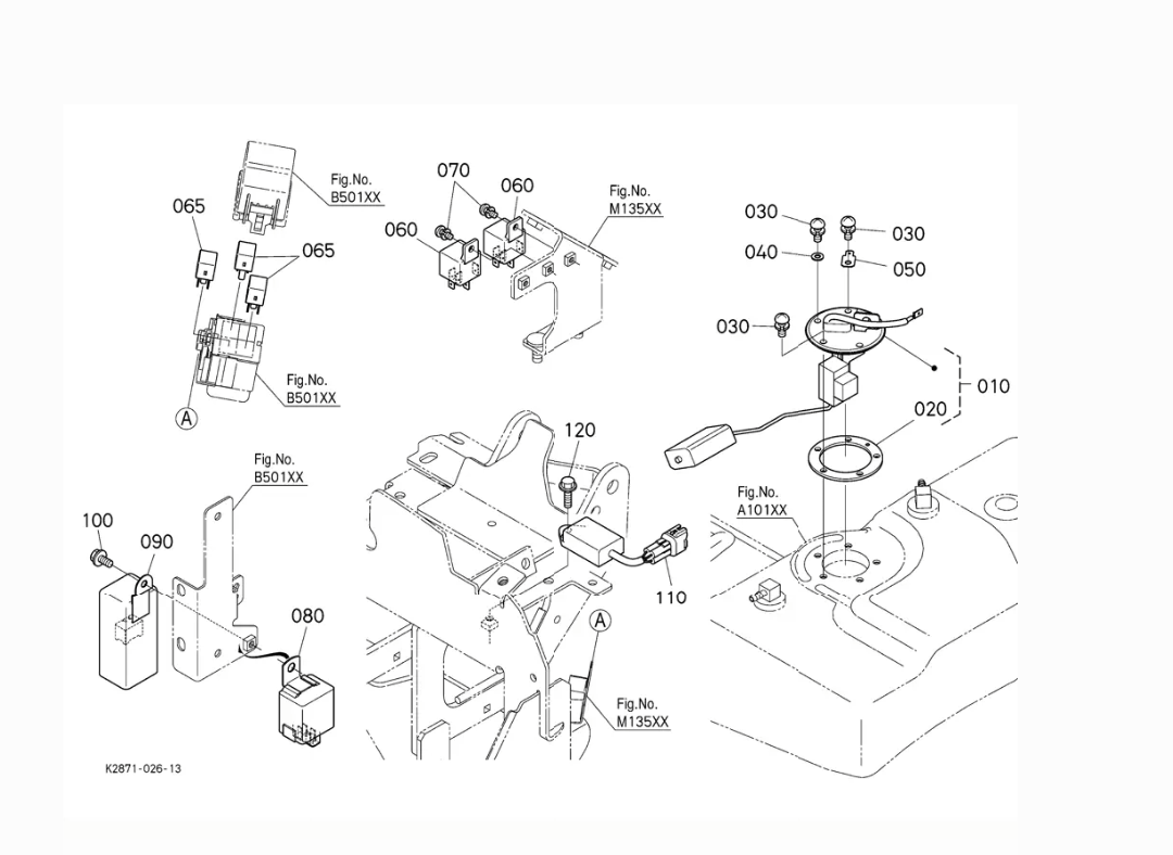

Yes, there's a relay. It's listed, but maybe not pictured, on the Electrical Sensors and Relays page. It may matter whether you have the BX23S or BX23S-1 model.
12,769
5,559
#060 are the relays, all the same, about $22 CDN. My guess, is the left side loner is the gloplug relay.
The 'sticking' is usually due to the relay contacts pitting from the arcing as the high current is switched. A higher quality relay will minimize this.

Based on what you have said i think you should have someone with experience diagnose reason light malfunctions. If the problem turns out to be bad relay GreenJay's diagram makes replacement easy. Adding to GreenJay's excellent information, a pair of those $22 relays in parallel should out preform OEM and save you $100.

I don't know, but there's another drawing, looks like possibly some plug-in relays. This is from Messick's.
