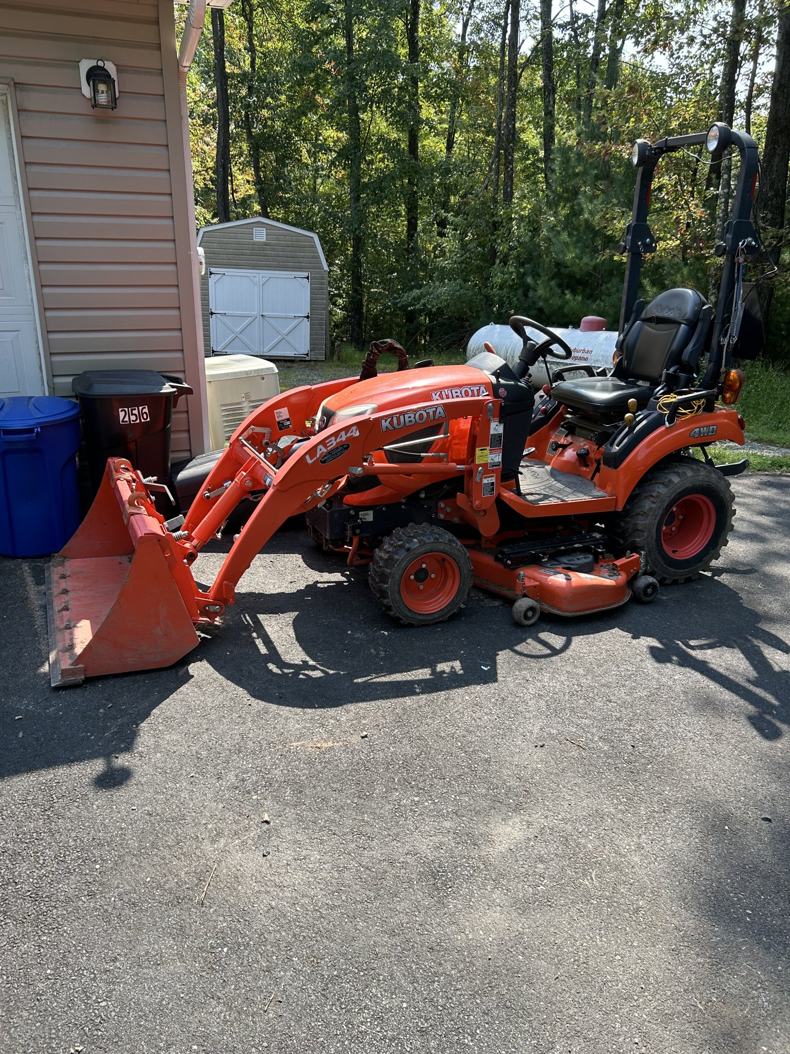

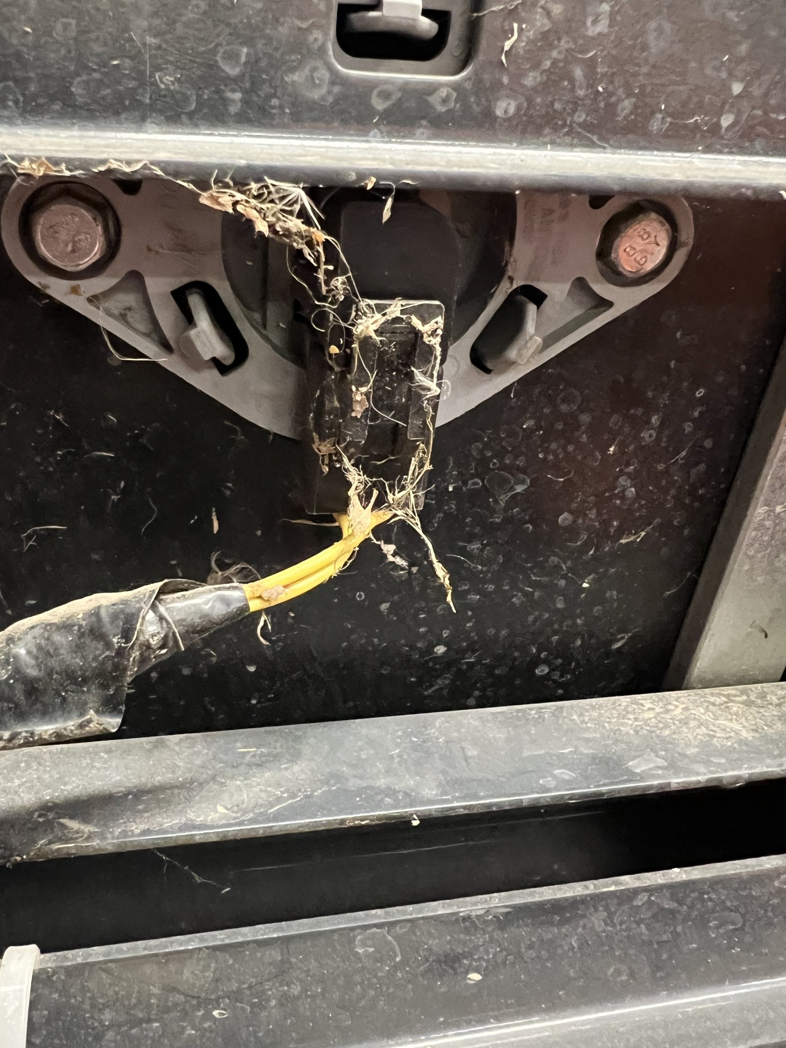

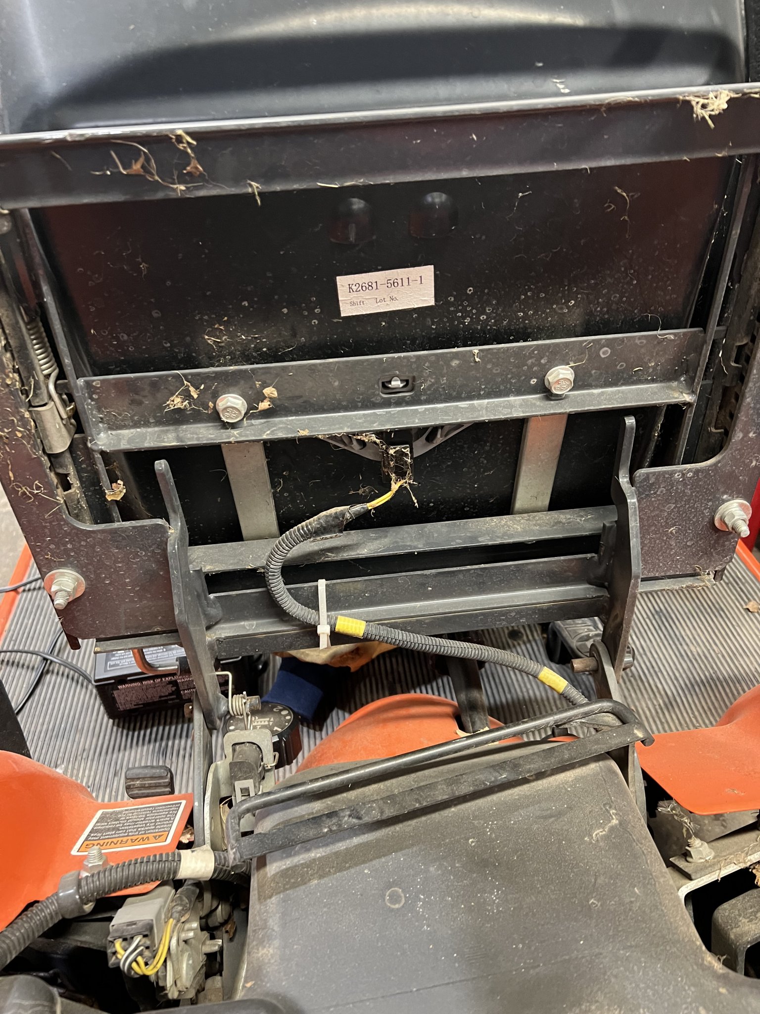

Something new, My BX2380, I bought new, now only 225 hrs. Starts beautiful, warms up fine and Smooth, then when I press the forward or reverse, it stalls. Or when. Sitting there, i hit the mower pto, stalls, as if I’m mowing and get off the tractor seat.
Now recently, the seat cover cracked from the cold. I just bought a new cover, didn’t get it on yet. But I tried getting off the seat, and unlatching it, and then banging it in place. Nothing. I unplugged the seat switch wire and replaced it. Nothing.
Yesterday, after playing with it after an hour, it started moving beautifully. Well, today stalling again.
Any thoughts.
Im getting ready to trade up a bit larger.

Bad seat switch, some models have mutiple seat switches.
