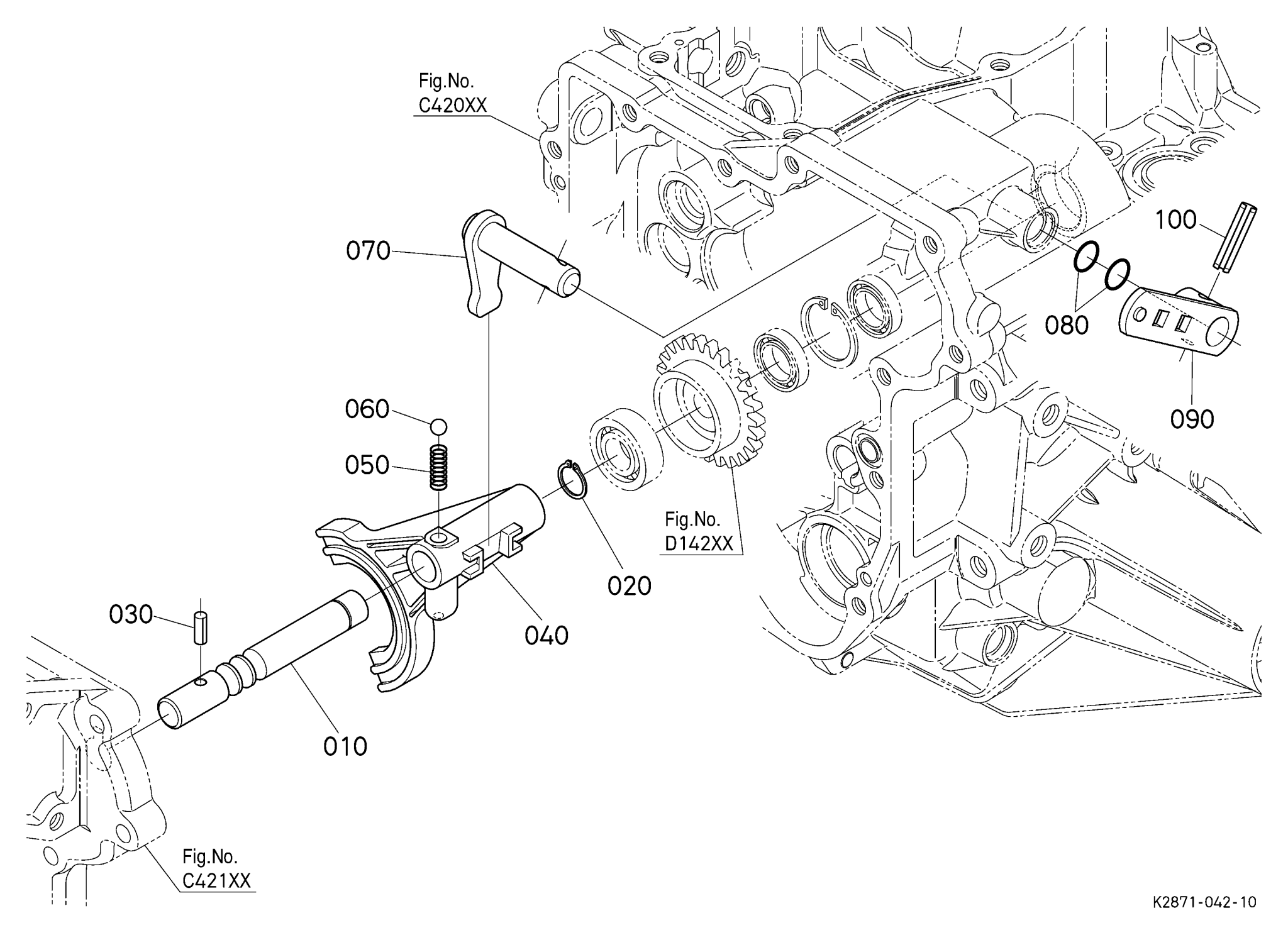

Can you verify that #100 rollpin is still in arm #090 and that it moves ? There should be some 'resistance' when going to the 3 positions. it moves crank #070 that moves #040 on shaft #010, so 'clink,clink, clink would be normal and felt.
Is that roll pin on the linkage for shifting between mid and rear pto? It definitely still has the detente when shifting into the three positions. I’ll verify the roll pin is still intact but it will be Friday till I’m back at the tractor.
