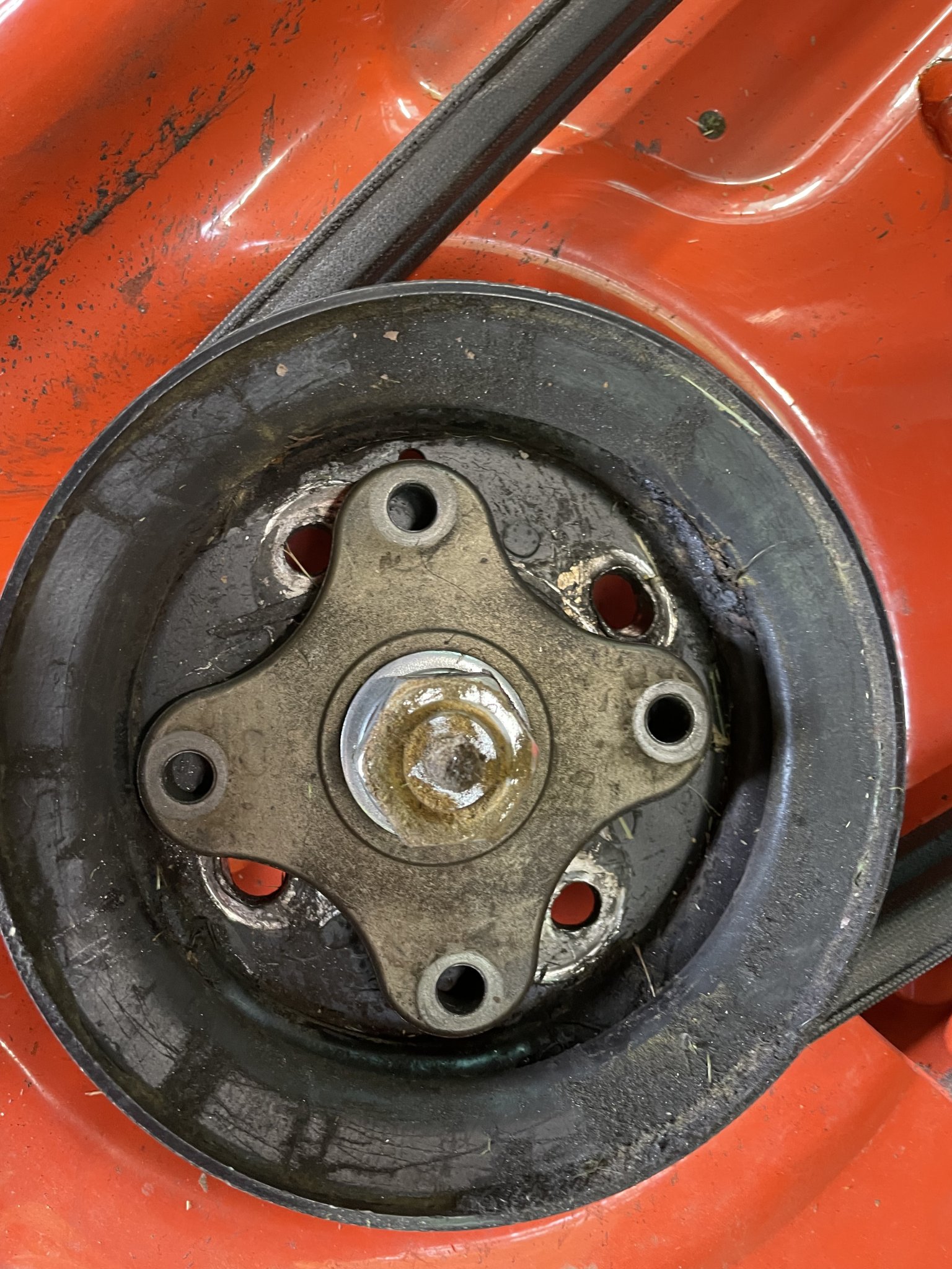

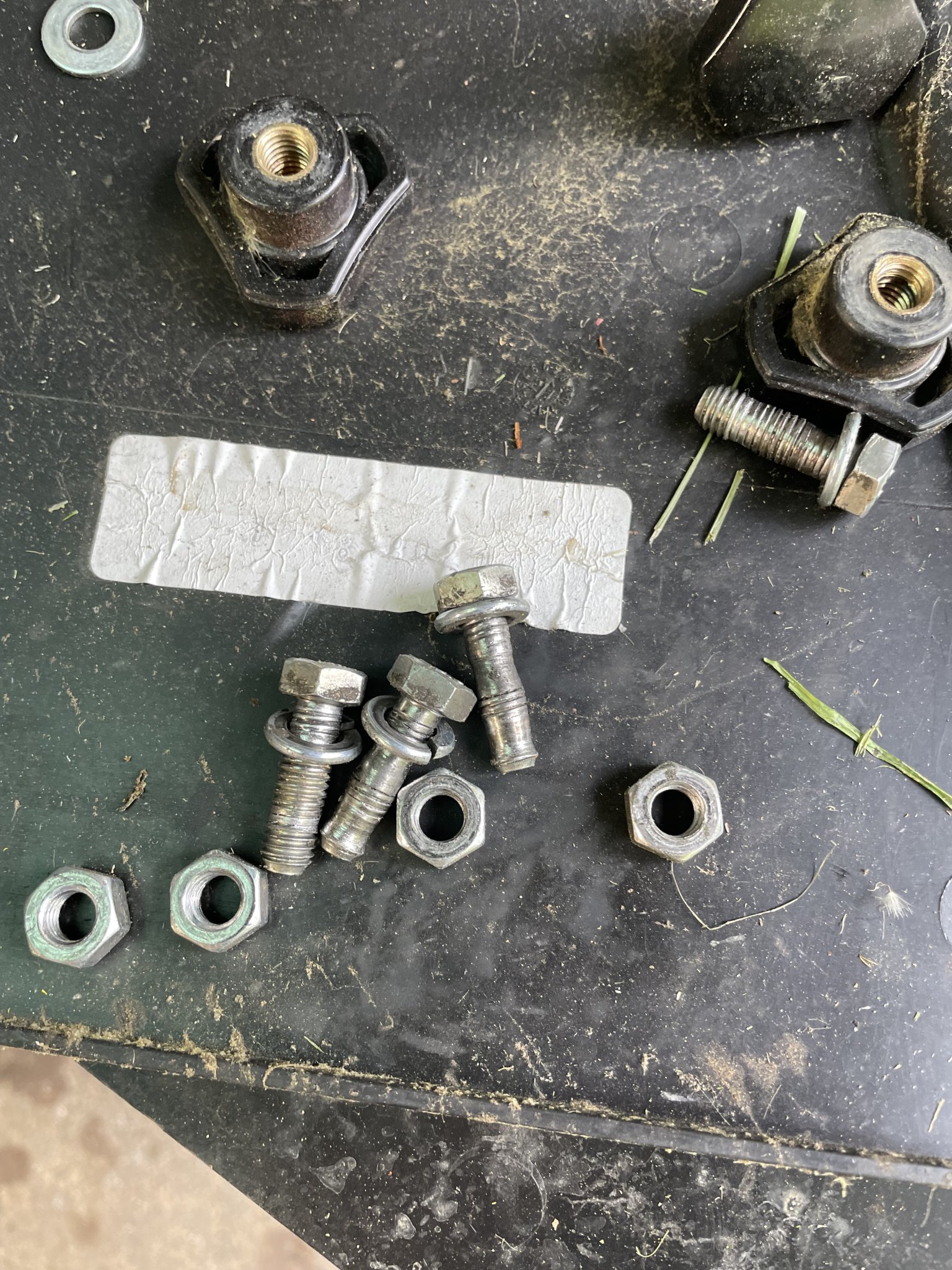

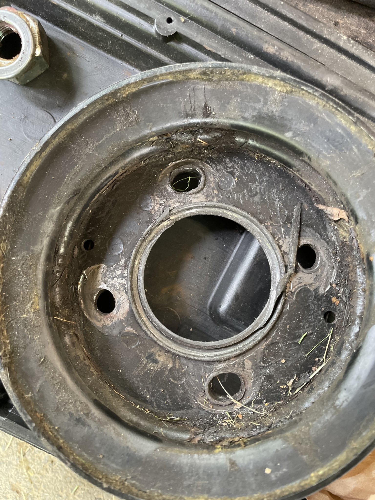

Have you happened to check your pulley bolts recently? Just last week I took the mower out for the third time this season. Halfway through I start hearing an intermittent hum/buzzing. Comes and goes, sometimes more acute, other times just a little hiccup. Maybe 10 min after it starts I hear squeaking and smell burning. Shut everything down and found that all four of the bolts in the left hand pulley had come out, deformed the bolt holes in the pulley, stripped off the bolts, and shaved off some of the inside of the pulley. Belt was actually fine, the smell was just it slipping for that last little bit.
Picked up a new pulley locally, got it swapped out and put on lock nuts on both sides. The right hand ones were only slightly tighter than finger tight when I checked them. Didn’t even need to hold the bolt head to unthread them. Those are definitely on my ‘check periodically’ list now.
