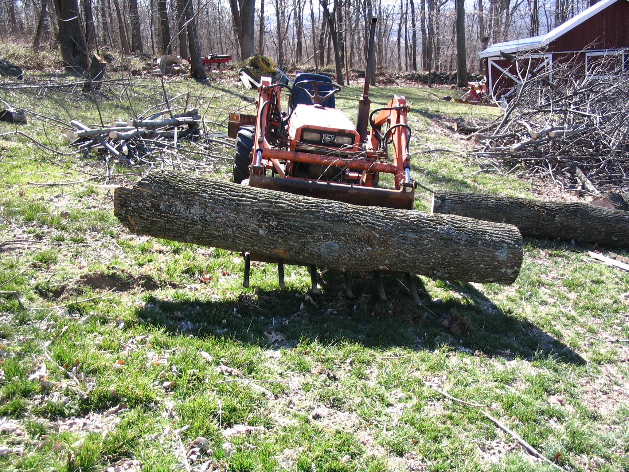

To make it easy on you and your equipment, I'd rent something larger. If time doesn't matter proceed with what you have at hand.
In the early 90's I made a sand court volleyball for the oldest son and his friends. With the Ford 1210, a 5' rear blade and a 3-point dirt scoop it took quite a while. It only needed about a foot of elevation change from one end to the other. Spread around 75 tons each of stones and sand. I'd do it with much more capable equipment or hire someone now.
