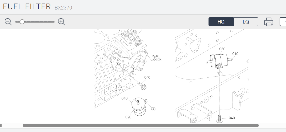

You ADDED an aftermarket fuel filter?
Do the 30 seconds AGAIN - and let it eat(hold it longer - you will not hurt anything) , you should hear the fuel pump buzz and whatnot, once the fuel IS FLOWING the pitch will change - continue and then try to start.
Picture of fuel filter would help
