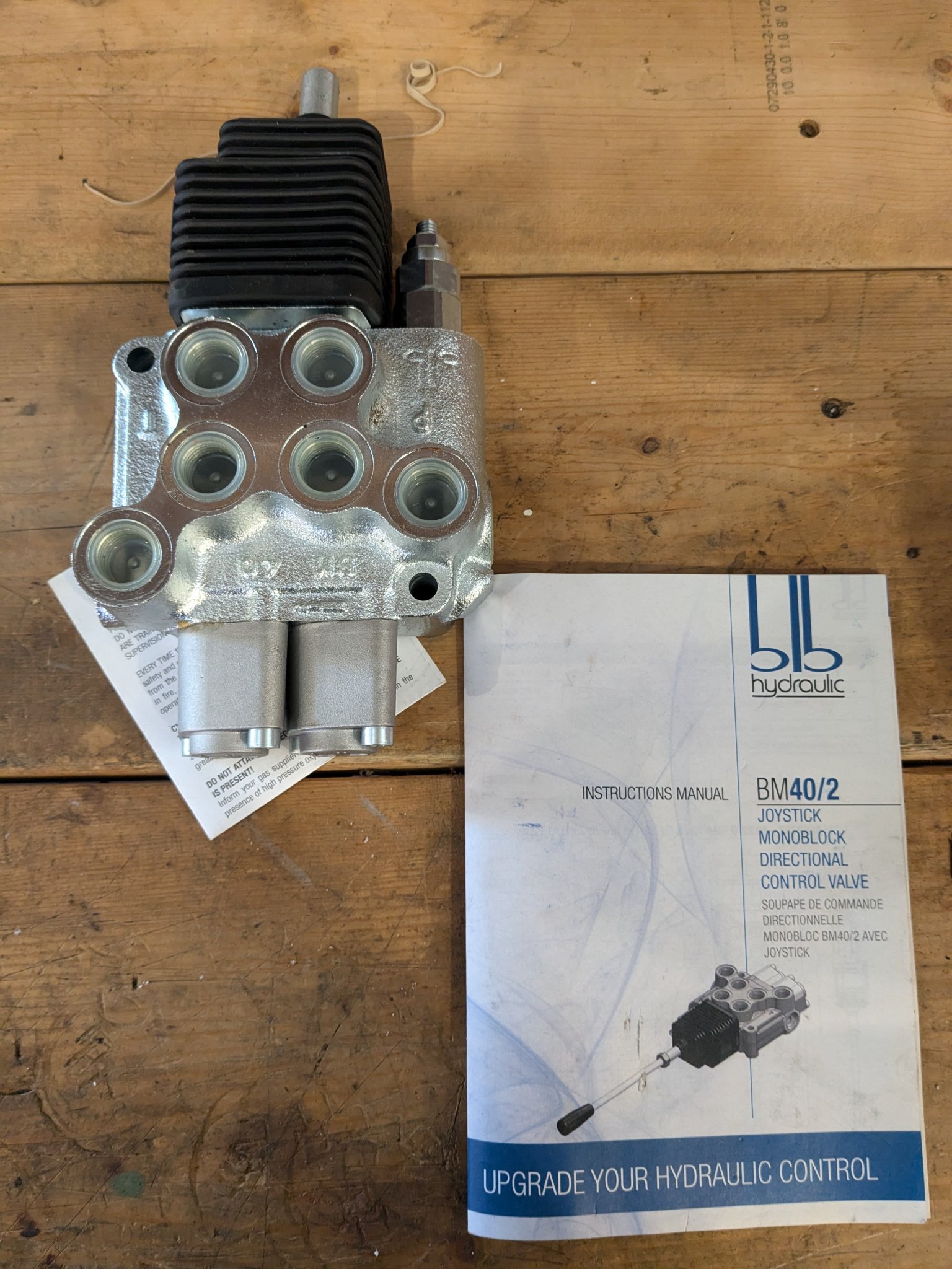

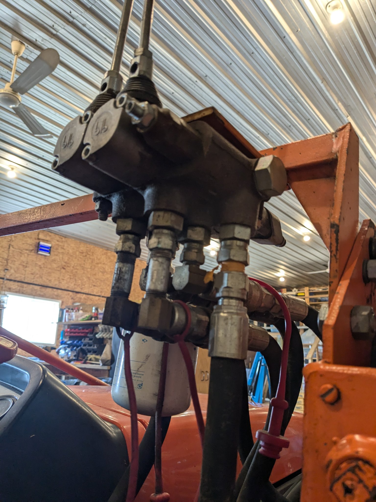

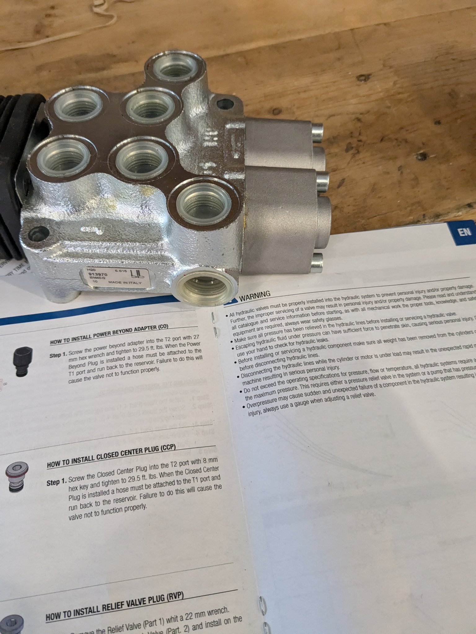

Yes, the rear block looks like that. Albeit the plumbing on it looks like a MacGyver job as well. Small difference in that my block has two bolts attaching it to the machine. I only see one #160 in the above diagram. The line attachments appear the same.
The control valve for the loader has 6 hoses on it. Two for each of the arm lift and bucket curl controls. Plus one input from the pump and an output to the tank.
Is the 6 versus 7 hose configuration requirement related to "Power beyond" in your note? Kind of bypassing the spool control valve entirely if it's not in use?
I've attached some pictures.
1. The block on the back of the machine
2. The single spool control for the back blade

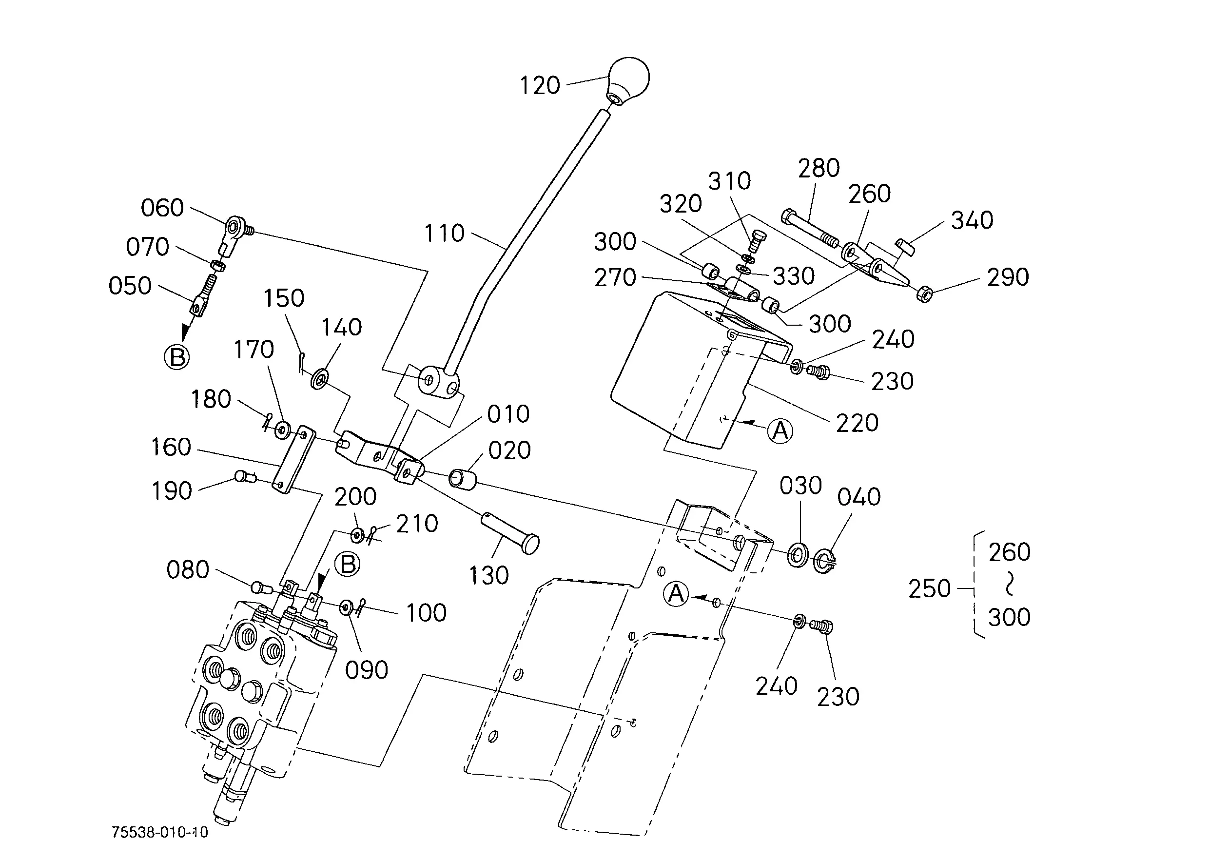

3/4. The spool control for the loader

I have no need now nor expect to have a need in the future for the rear hydraulic control. I think I'm just going to remove it make things simple.
As well, I had a wanted to replace the two stick arrangement for the loader so I already have another "joystick" type control. When reading the manual for it I came across a what appears to be an adapter I can get for the "Power Beyond" requirement.
I'm thinking I may be able to get this to work with that adapter on the new valve and running some new hydraulic lines up to the front of the machine.

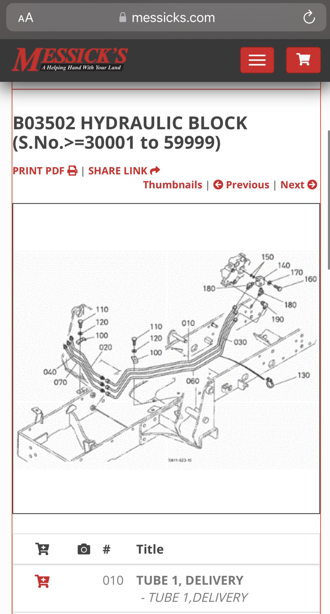

Here's a parts question... In the diagram below it looks like there are hard lines that connect up to the LA211 loader in front. Any ideas what the part numbers are for the lines? Looks a lot cleaner than my current setup.

Here's a parts question... In the diagram below it looks like there are hard lines that connect up to the LA211 loader in front. Any ideas what the part numbers are for the lines? Looks a lot cleaner than my current setup. View attachment 141845
I believe that outlet block goes under the 3pt valve. It is not the same block you currently have. Its a little pricey at $180 and I am sure those hard libes are not inexoebsive. Three hoses to hook your valve into the exudting one is a lot cheaper and eadier to install....

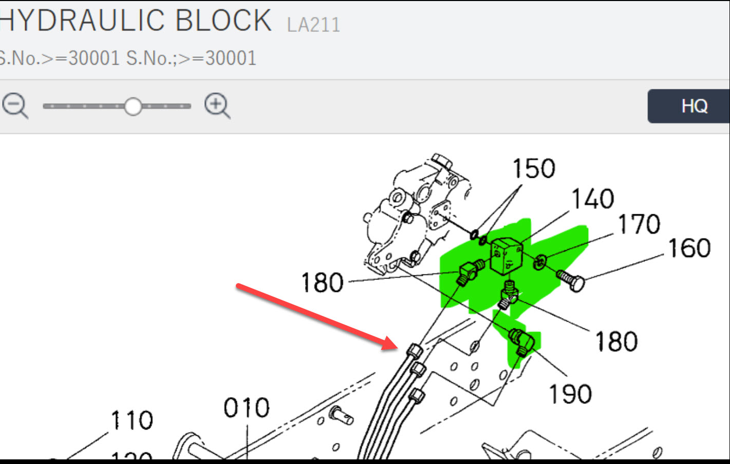

You have the oem hydraulic block on the control valve. I marked your picture with whats what and am attaching pics of the factory setup of the hard lines. Like @TheOldHokie said it wouldn't be cheap to add those and what you have works fine but here they are for reference
If this link works heres the hard lines youd need

Thanks. I'll price these lines out but I'm expecting hoses would be cheaper. Reason I was asking about these was there is limited space under the machine and these hard lines look like they get to the front of the machine without getting in the way of anything. Given I've got a control in the rear I'd only need two of the three and would use a hose from the FEL PB to the rear control.
I'm a little confused on the block markings you supplied. When getting educated in this thread, one of things that was mentioned is that the only line that can be teed is the tank line. Did I get this wrong?
When I trace the lines from the block to the existing spool control it tracks like this.

I am pretty sure that is not power beyond. That is a dump into ghe case. Tje block has power out and power return - just dobr knw ehich is which but its in the owners manusl. The manual is also quite clear - thre is no pressure relief ahead of the outlet block so you must use a loader valve with inlet relief and tank return. If you get it wrong you xan deadhead and probably destroy the pump.

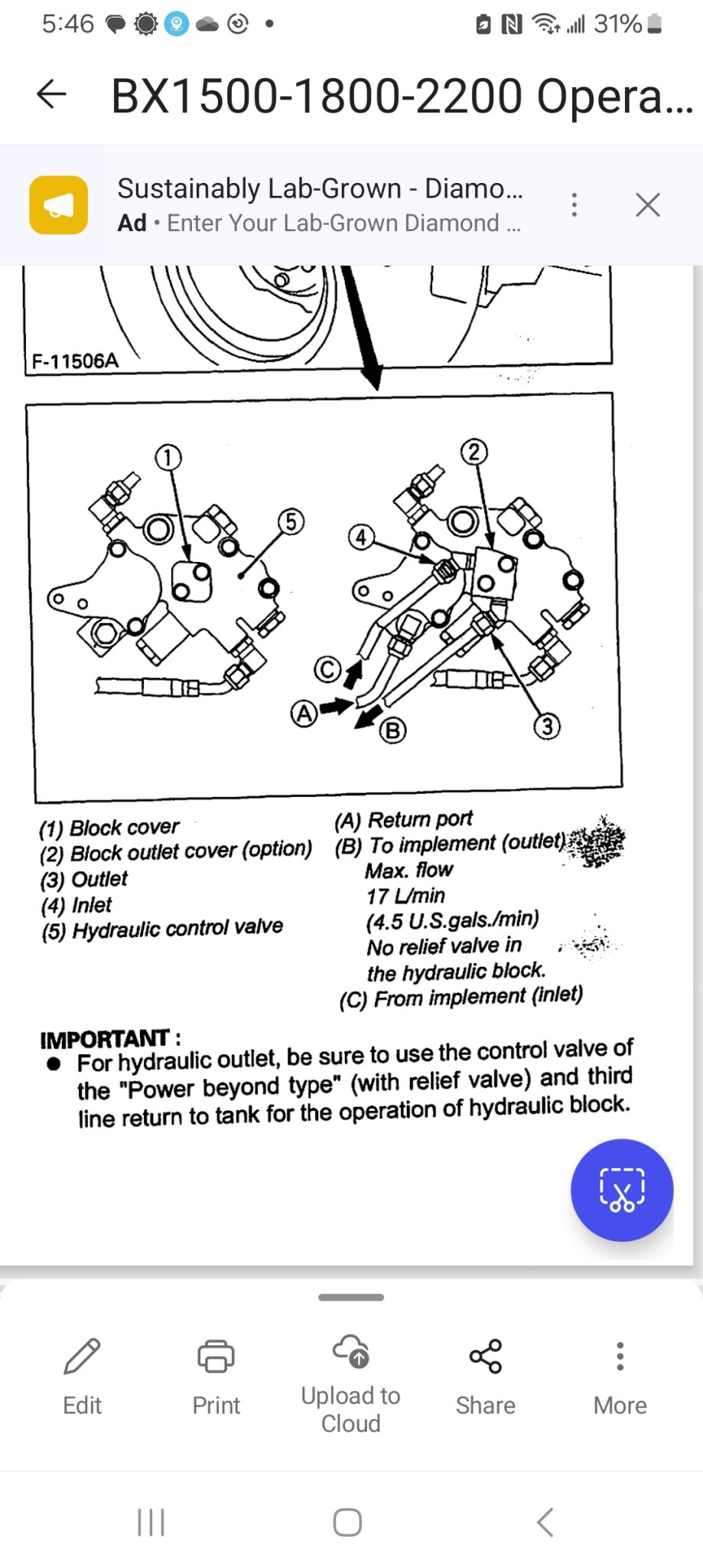

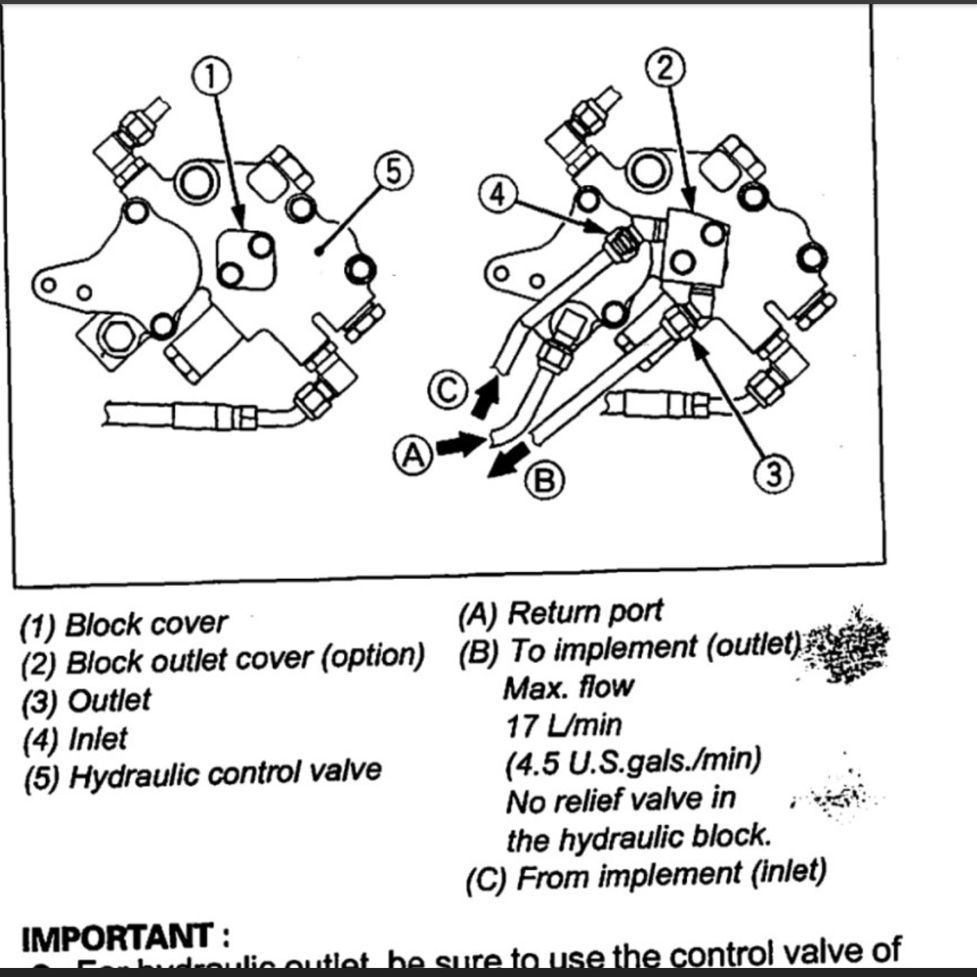

Yikes... If I'm reading your comment correctly the existing control is not connected correctly! Based on what I see installed on the machine and from Mountainman's marking on my picture, the power comes from the bottom of the block. Both in agreement there. Sounds like the other two may be backwards as currently installed.
To confirm I'm reading this right from the above diagram it's "A" & "C" I'm to be concerned with.
"A" is referenced as "Return Port" and "C" is referenced as "From Implement (inlet)".
Which of A or C is the PB from the last control in the circuit?

Yikes... If I'm reading your comment correctly the existing control is not connected correctly! Based on what I see installed on the machine and from Mountainman's marking on my picture, the power comes from the bottom of the block. Both in agreement there. Sounds like the other two may be backwards.
Is a link to the manual that explains this stuff available somewhere here on the site?
You can download the Operator's and Workshop manuals from Kubotabooks.com

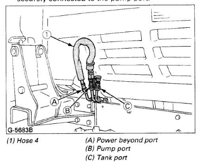

@922MB

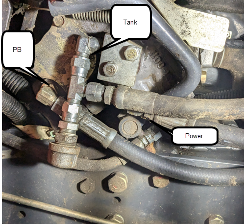

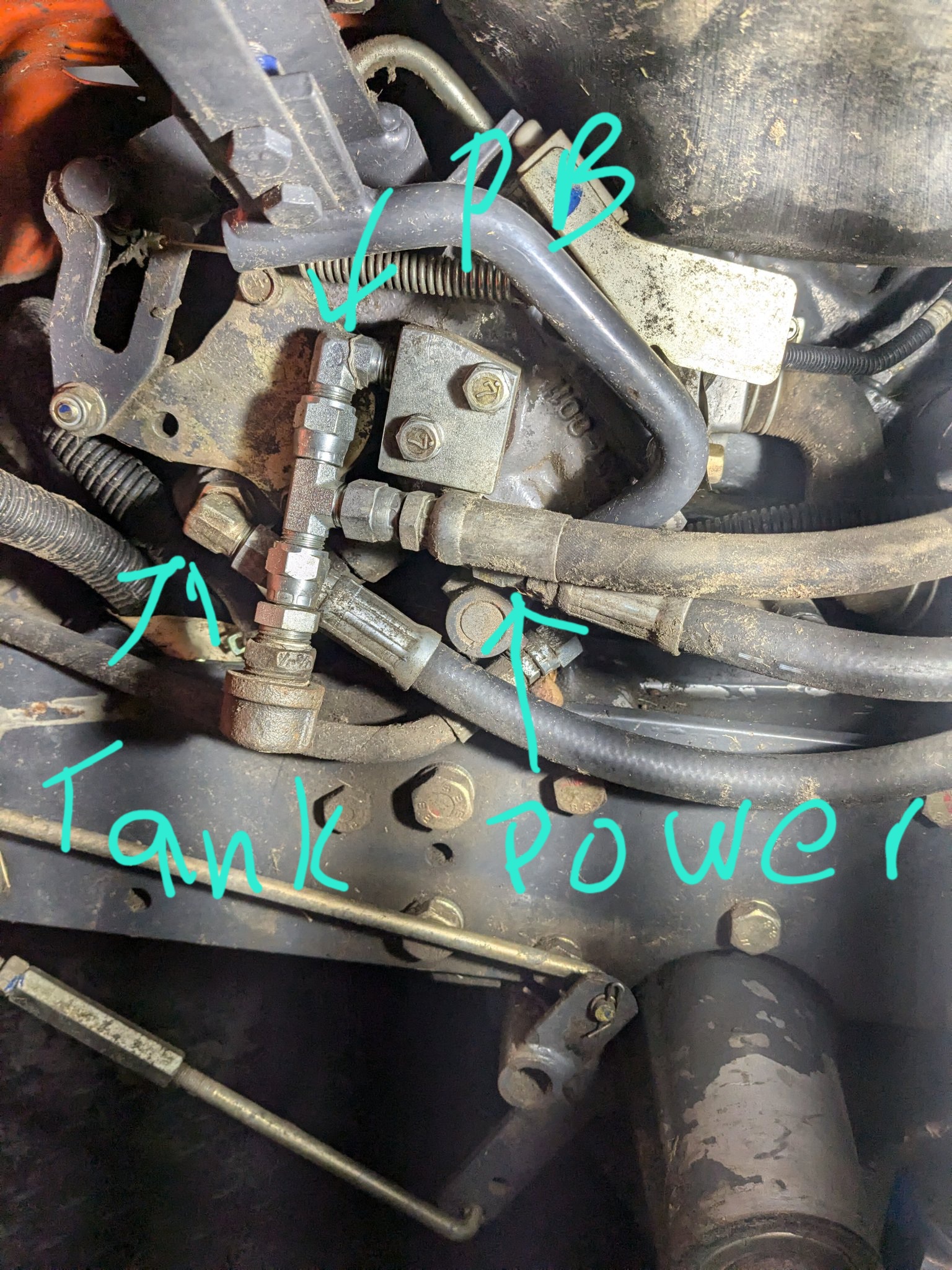

I think you are getting confused by a post from @Mountainman not @TheOldHokie
@Mountainman posted this. Notice that his POWER is pointing to the hose that is hiding and appears to go into the bottom of the small block.
@TheOldHokie posted this. A is Tank, B is POWER, C is Power Beyond from valve (power to the 3 point hitch). I see that these two diagrams are the same. I see your diagram as incorrect. Notice that while there is a TEE IN THE POWER BEYOND there is only one line into that TEE so it is really a 90 degree fitting in function. (More below)
I think I was the one that said not to use a TEE in anything except the tank return. Specifically “don't TEE two lines into one outlet port of a TEE except for tank returns” would be a better way to say that. Using a capped TEE in the other lines is OK but inviting someone to make a mistake.
I hope this clears it up and doesn’t make it worse.
