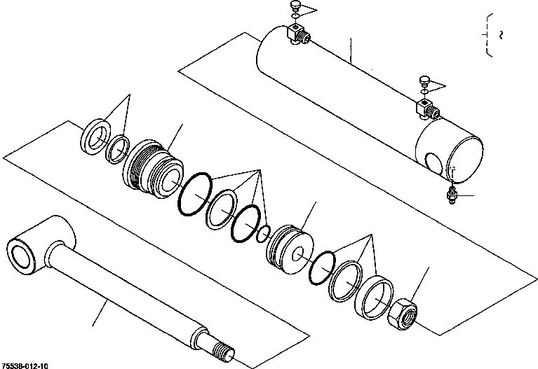

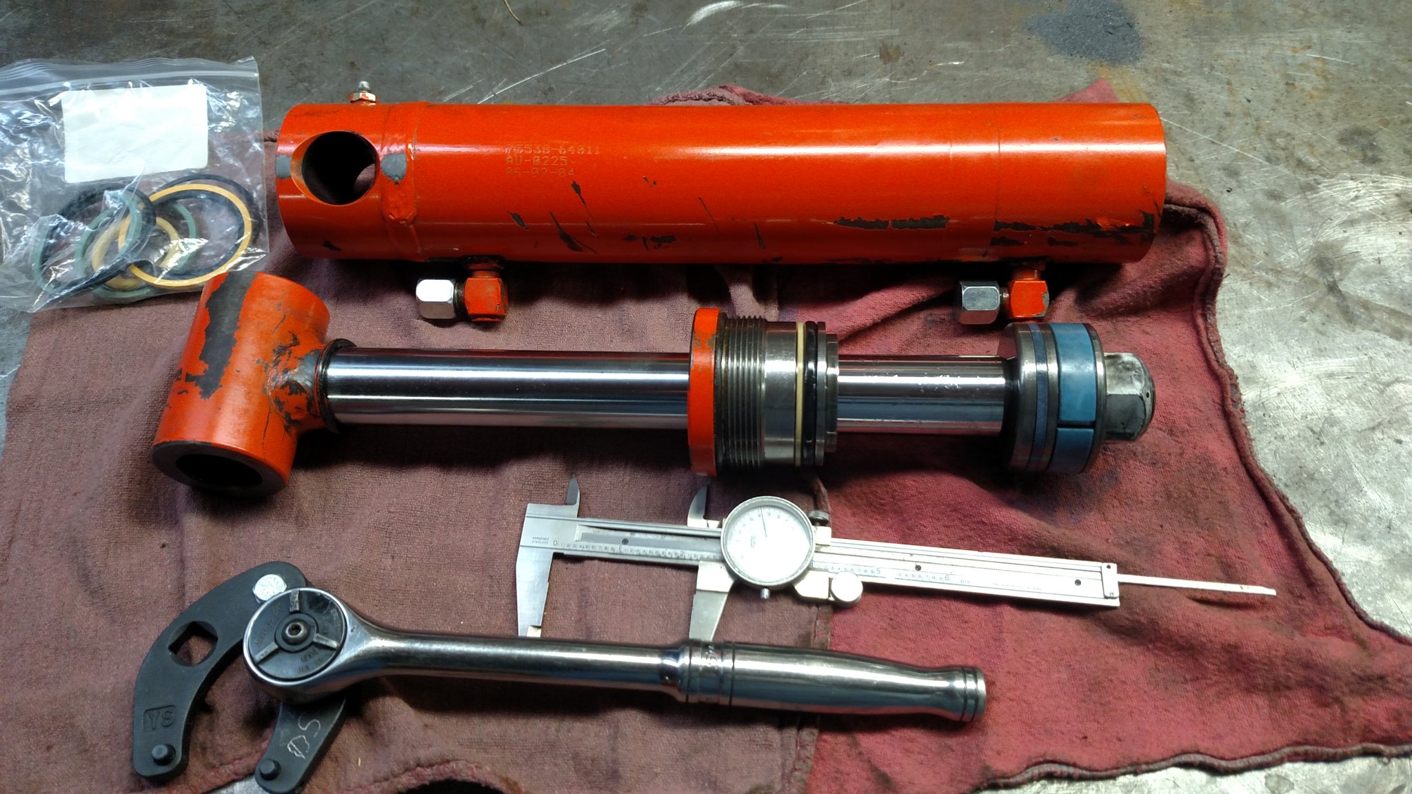

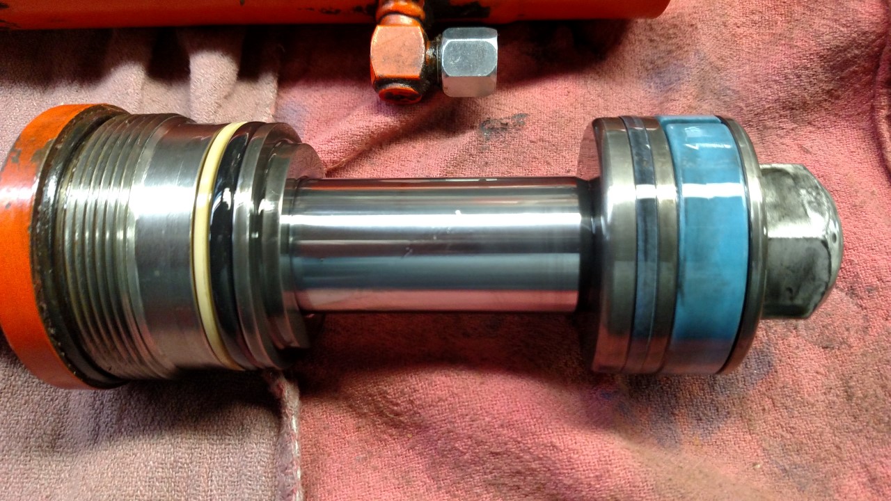

I replaced the seals on the curl cylinder on my LA211 a couple of years ago. The only difficult part was getting the end cap off, it requires a spanner tool to unscrew it from the end of the cylinder barrel. The parts aren't that expensive and should be available from Messicks. The only other difficult part might be getting the nut off the cylinder rod, as it can be pretty tight. I held the end in a big vise and used a 1/2" air impact to get it off. Once that's off, it's pretty straightforward to replace the seals in the gland and the packing seals on the piston. I think it only took me a little over an hour to rebuild it once I had it off the tractor.
You will need the cylinder part number off the barrel to get the correct seal kit, as there are a couple of different cylinders used on the LA211.
